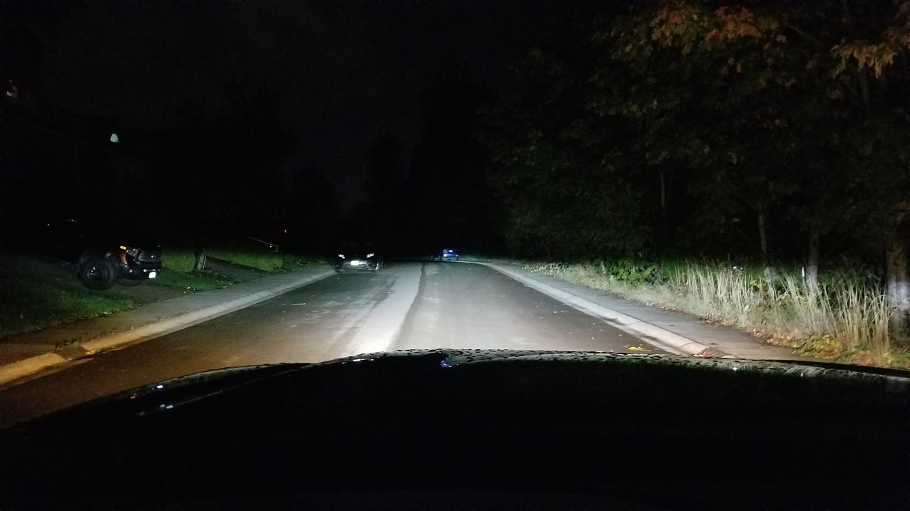

    Obviously different angles and different light conditions as your was dusk and mine was a moonless night going uphill but you can see how much yours is washed out after that 10 yards or so. And if that hotspot being thrown on the ground is all because the headlight is adjust incorrectly you must have not been able to see a thing before hand. I'm just running a 35watt HID kit, not a 55watt which would be much brighter.
    A lot of people seem impressed right away with LEDs but in real world conditions your stock halogens will let you see further out than low-beam LEDs. Read up on threads, a lot of people returned their LED lowbeams because they can't see well when it rains (since the throw is a lot shorter) or in inclimate conditions.

    I can see what you mean somewhat. I just adjusted my headlights up and I’m going to snap another pic sometime this weekend.
    Tell you what.. take a pic of yours from the bed of the truck over looking the cab on a flat road (no hill). I’ll do the exact same thing again and at around 11pm. I’ll PM you mine or visece verse and post them side by side on one post.
    I’m very curious now and I feel doing this will answer any further question on this thread regarding LED or HID.
    Thanks in advance! :thumbsup:
    @RobP62 if you haven’t made the purchase yet. Maybe wait till you see this. I’m curious.

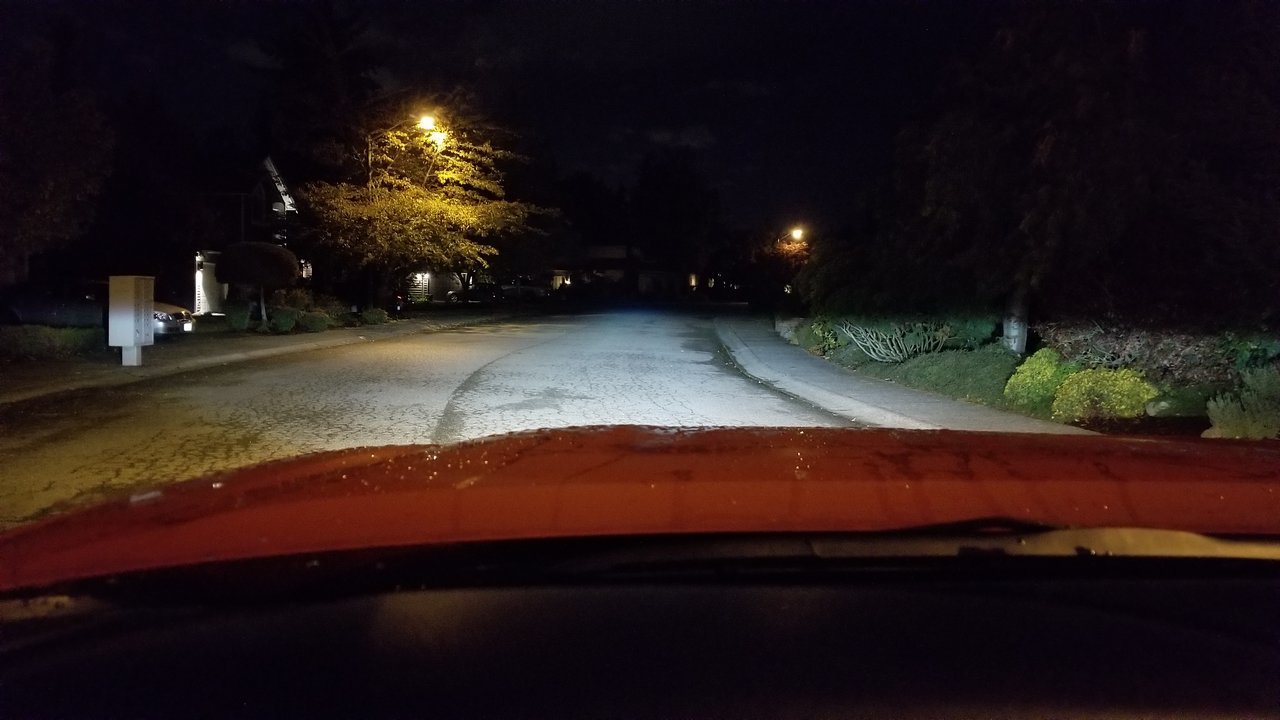

    Sorry not flat or straight but no street lights and you can see how well lit up the street is at the end even though the hot spot is much closer. I'm running amber/yellow halogen fogs as well. I believe LEDS will make the initial area brighter than halogen but won't have that throw in the distance like Hids or a stronger halogen bulbs. Part of it is the 6k color. I ran 6k hid bulbs before in my previous vehicle and had much better visibility at 4600k, which is the most natural color for our eyes.
