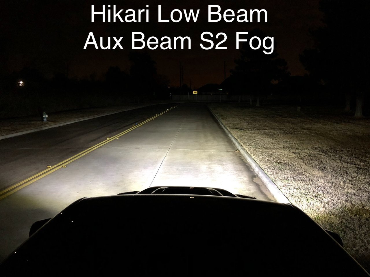

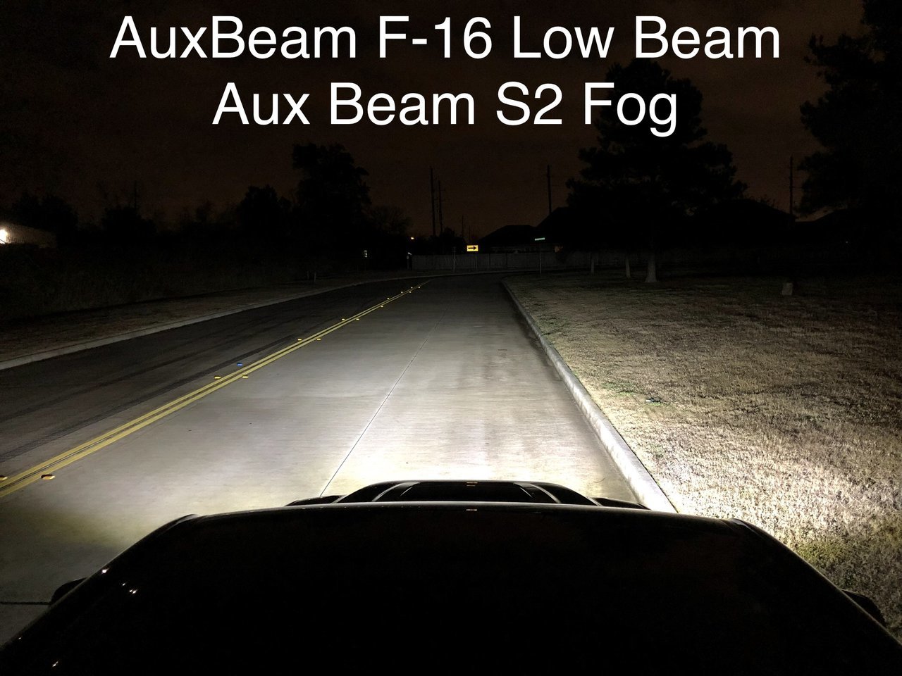

    Ok so here it is. Taken between 6:45pm and 7:30pm no street lights, flat road, very dark area.
    Too get the same through you have in your pic I’d have to flip on the high beams or turn on the light bar.

    Good comparisons. You can definitely tell LEDs are brighter close up but HIDs have the further throw. I still want to get either ditch lights or a light bar for off-road use as well since the HIDs have a very distinct cut off compared to halogen or LED.
    Parker315[QUOTED] likes this.

    OK Mahn.... did these today. Thanks for your guidance and direction Parker.
    Obviously much more light over stock.... there is now discussion there. Now I have to do the Highs... Can't have any yellow halogen light on there now ! :rolleyes:
    The amber directionals are over the top !
    But.... do you think the Fogs are brighter than Low Beam or is it because of the
    lens ? Fogs are the ballz, but I was thinking the Low Beams would be brighter still with the Fogs backing them up ?

    The fogs will add a very noticeable difference believe it or not. They light up everything in close vesenity to the truck. About 10 yards forward and 5 or 10 yards to the left and right. You will see a big difference in pheriphial lighting.
    You don’t have to go with the S2 AuxBeam for the fogs. If you like the f-16 you have in the lows you can put those same bulbs in your fogs and even the high beams. And oh yeah, the fogs are brighter then the low beams projector light output. You can also adjust the pitch of the headlights with a small 8mm screw on the back of the housing.

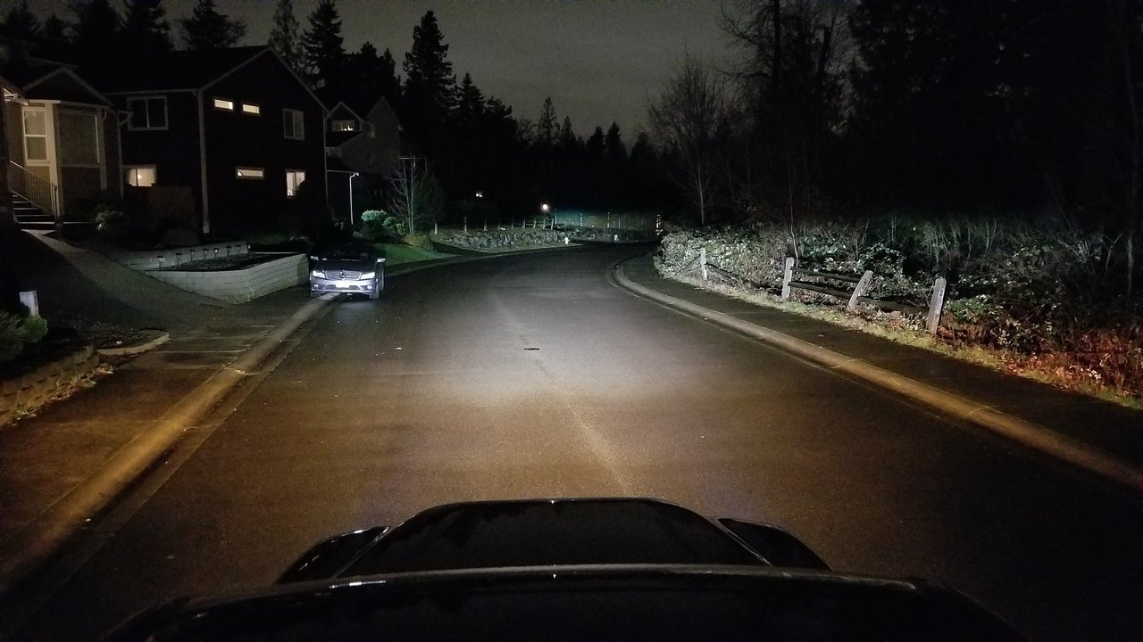

    Not sure if you ever saw this or not... The last pic is from @rlx02
    https://www.tacomaworld.com/threads/brighter-headlights.528449/page-5#post-16945661
