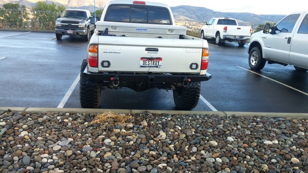

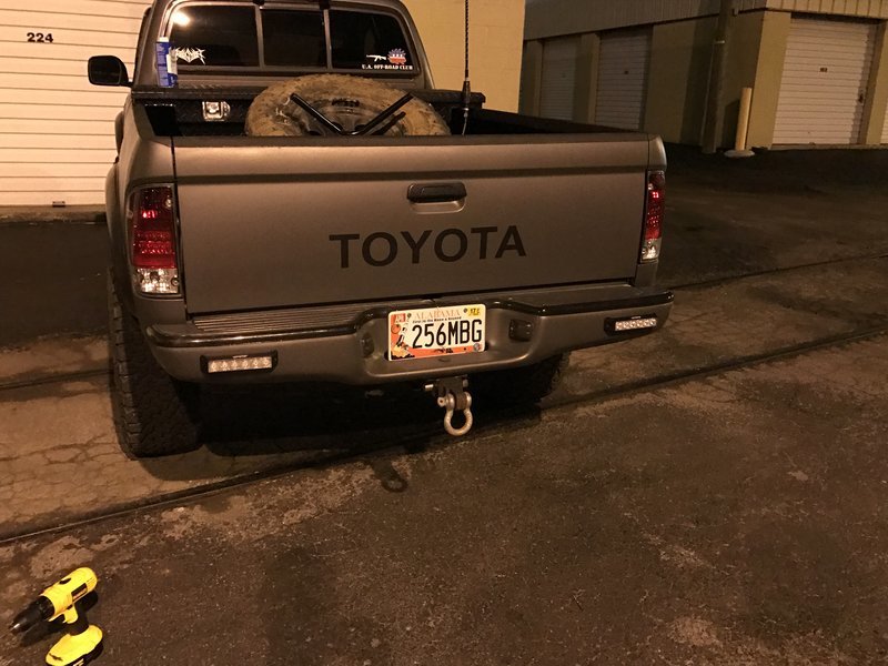

    you could always mount some flush mounts in the tailgate. keeps them more up and out of the way than the bumper.

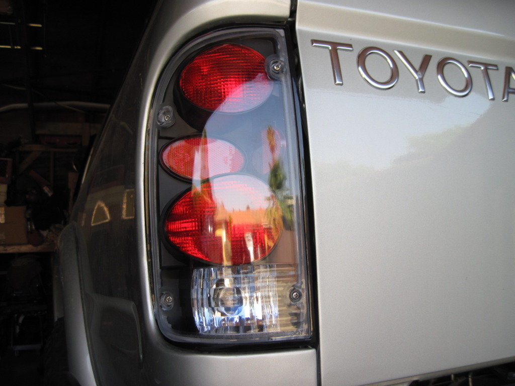

    Be wary about using a higher wattage std/halogen bulb.
    as the additional heat could fubar those tail light lenses.
    IMO it would be better to add additional external lighting...
    then try to improve the output of the stock tail lights.
    If the back-up lense on the tail light lens were clear... that would help.
    But it still won't compare to additional aux. back up lighting.
    I use a different tail light altogether to improve back up lighting capabilities.
    The clear back up lens does much better then did my factory tail lights.

    I like this. How did you route the wiring?

    through the drain holes in the bottom of the tailgate and then spliced into the existing wiring

    im really happy with it. mine were just some cheaper ones from Amazon and i had to cut a good portion of the fins off to fit the light inside the tailgate. youll like it!

    I currently have a pair of Amazon MIC cheapies mounted to my hitch. They work okay, but they are in a vulnerable spot being that they are the lowest part of my back end.
    Similar to this setup.
