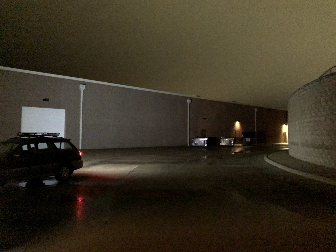

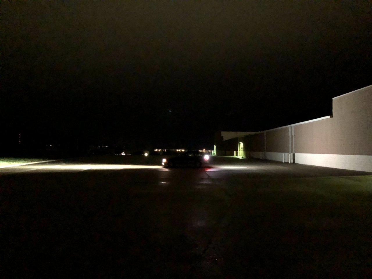

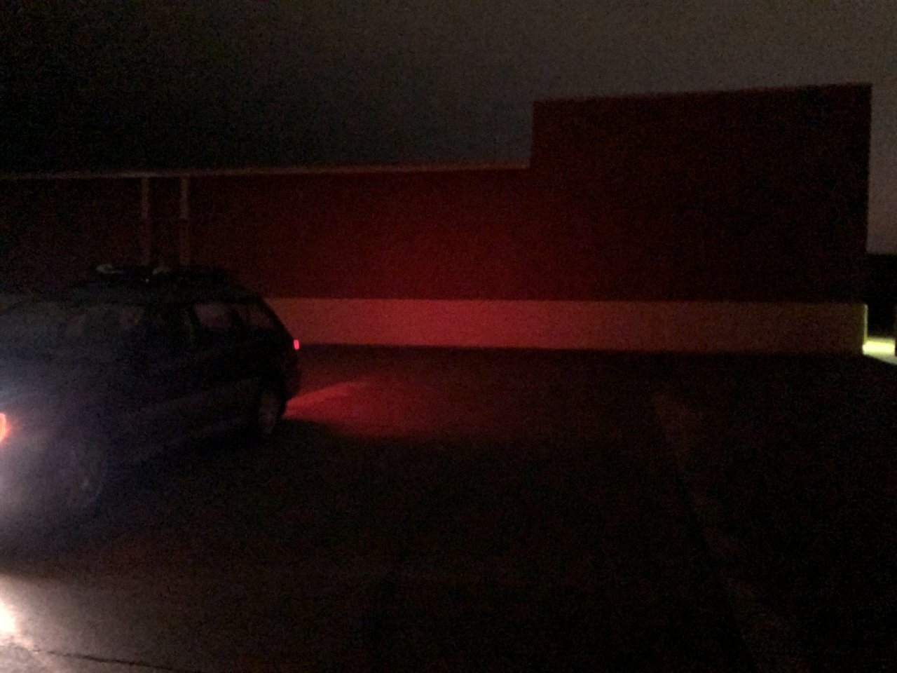

    Also....my beater Subaru I did some COB LED boards in the factory reverse housing. It took quite a bit of cutting but holy cow is it bright! They are rated at 1000 lumens at 12v with no controller. So 13.6v would be considerably brighter. And they are wicked.

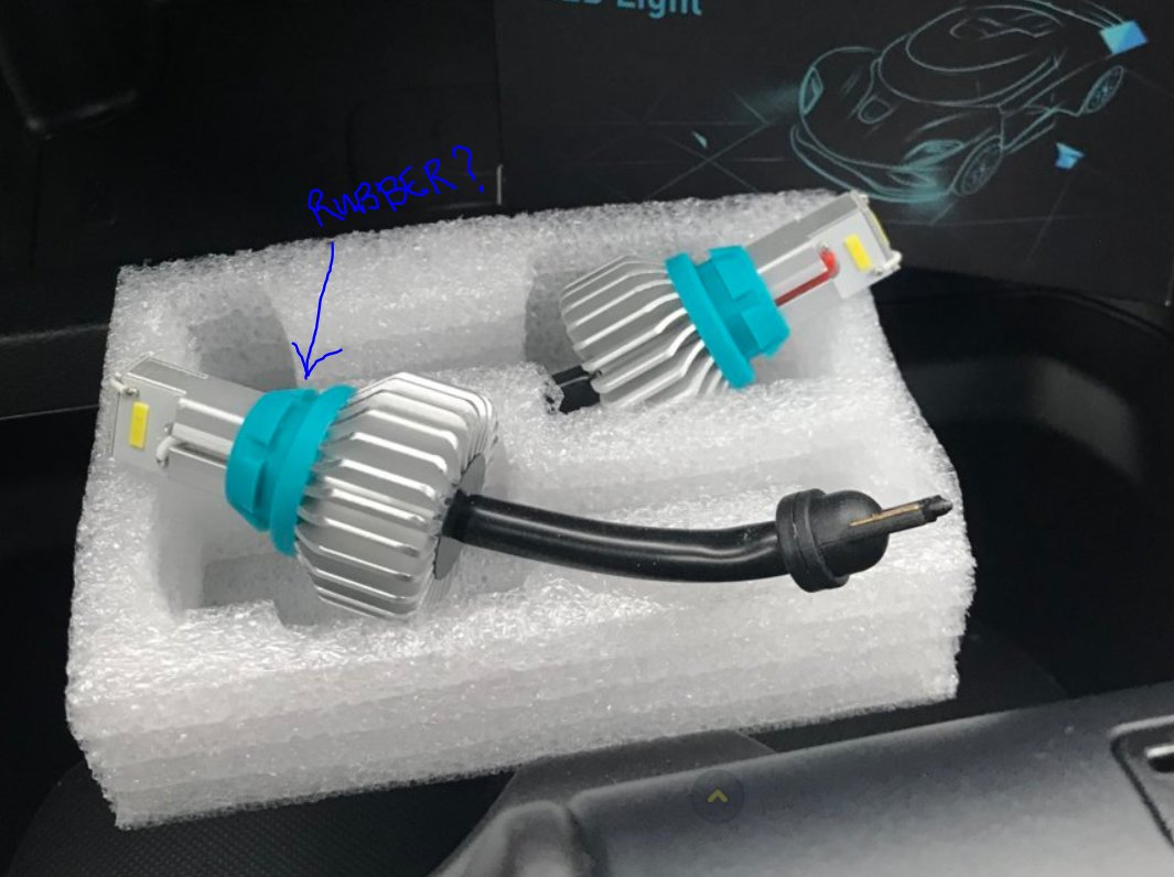

    How secure do these mount to the housing? The mounting tabs do not appear to be a direct swap...are they rubber?

    Those just squeeze into the housing, they can be a wiggly too. Just a meh fit. I had those but I was worried they weren't going to seal very well and allow water in. Especially in cold temps with rubber expanding and contracting. I ended putting them in my wifes car where the back side of the housing is protected from the elements. They do work well, but I prefer the GY6.35 bulb in the Tacoma, I feel like the light is better dispersed and more usable.
