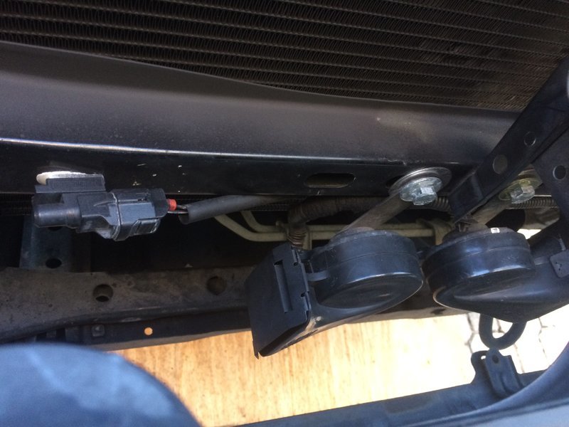

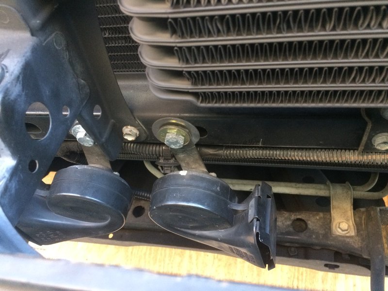

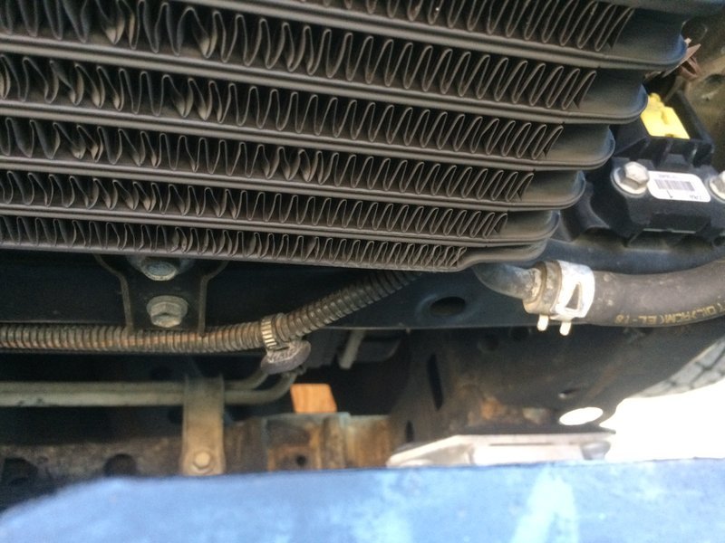

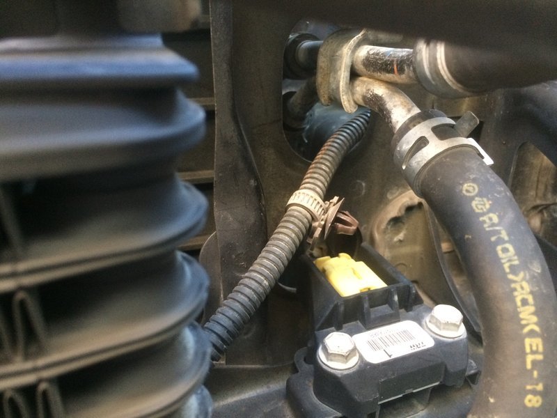

    Great write-up! Tried this yday before mounting satoshi grill...couple of comments
    1. I didn't have to snake the harness through the gap where SRS is mounted. I was able to route it from opening above the SRS and have enough slack to mount the temp sensor and horns.
    2. The toughest part for me was to mount the damn horns, I used 3/8-16 bolt, flat washer and a lock nut (not nylock). It was tough to hold the nut and tighten, I couldn't get my fingers behind the radiator support without losing washers and scraping my fingers, hopefully horns don't fall off lol...will post pics later today

    Pics...

    :thumbsup: Perfect.
    I know.......The scraped fingers are the only downside.
    One guy in the thread had his (small fingered) 12 year old do it.
    Still trying to get to moving my oil cooler, so wanted to leave that penetration uncluttered
    Pics look good, nice job.
