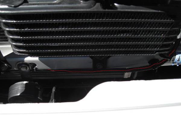

    Pull Wiring Harness backwards, unsecuring where necessary, until it's behind driver's headlight.
    I marked the harness in some of the photos
    Reroute Plugs and Harness (marked red) thru lowest hole in metal surrounding radiator (driver's side). Viewed from behind headlight

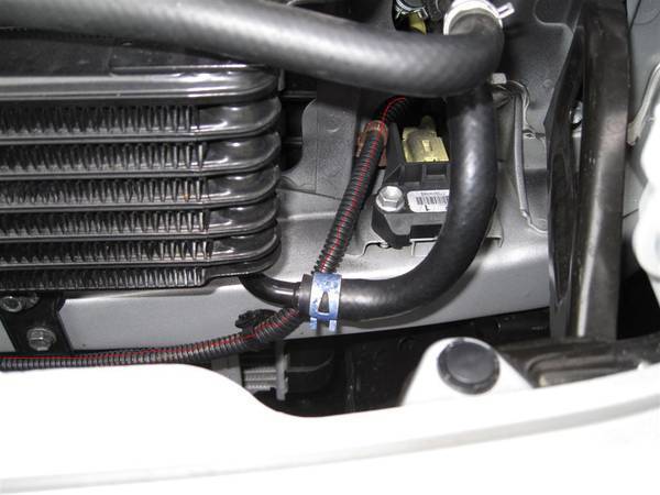

    To clarify "Removal": I removed one or both screws to shift the AIRBAG SENSOR, just enough to get the Horn Plugs thru.
    I DID NOT Disconnect, ManHandle or Hammer on the AIRBAG SENSOR at any time!

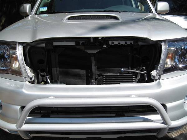

    The rest viewed from in front of the radiator with Grill removed
    Removal of part, circled in photo (AIRBAG SENSOR), will be necessary to get the plugs thru.
    I was gonna start a thread, asking one of those dumb questions, "What's this part ???" :D
    But I figure someone here's gonna tell me.
    So to continue, Loosen and Shift the unknown part (AIRBAG SENSOR), circled in the picture.
    Resecure the Airbag Sensor after feeding the Horn/Temps Sensor Plugs and harness thru.
    Route below Tranny Cooler and cable tie where convenient.

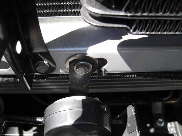

    Sorry, been a while. Looking at my pictures, I believe I used Stainless 3/8-16 x 3/4" or 1" Bolts and Nylocks (Nylon Insert Nuts) with Flat and Heavy Fender Washers.
    Alternative is to use Nuts and Lock Washers, but putting both on will be tough. You'll understand later.

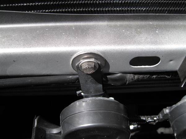

    The hardest part of the Job is getting fingers and wrench behind metal cross member to start and tighten the nuts.
    Fender Washers, both in front and behind metal
    Any large nuts and bolts will do

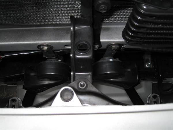

    Mount Horns from front: Bolt, Flat Washer, Horn, Fender Washer, thru Slotted Hole in Metal, Fender Washer, NyLock.
    I used the two equally spaced slotted holes closest to center.
    Don't forget to plug in the Horns
    EDIT:

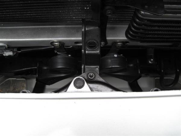

    Both Horns as viewed thru REMOVED Grill

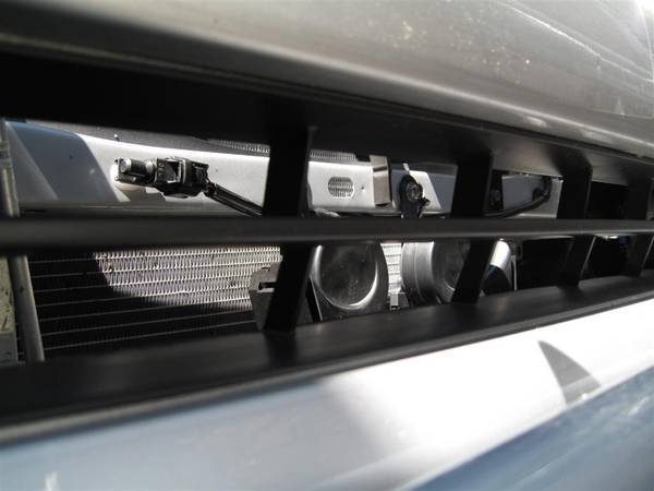

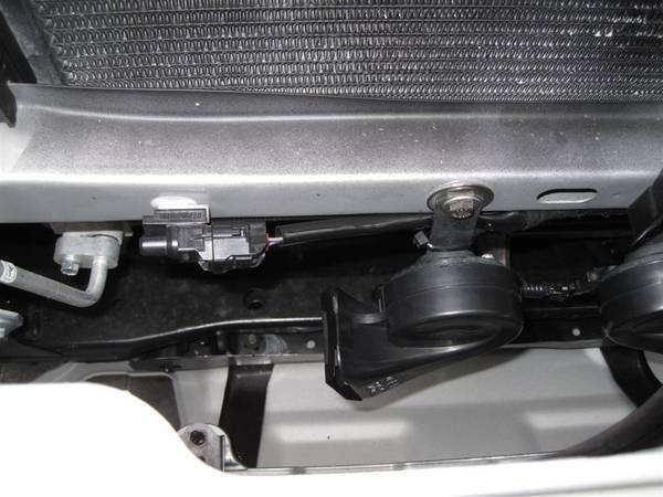

    Continue the Harness past the Horn location for the Temp Sensor.
    The Harness just reached an existing Slotted Hole
    After plugged in, the Temp Sensor snapped right into an existing hole on passenger's side.

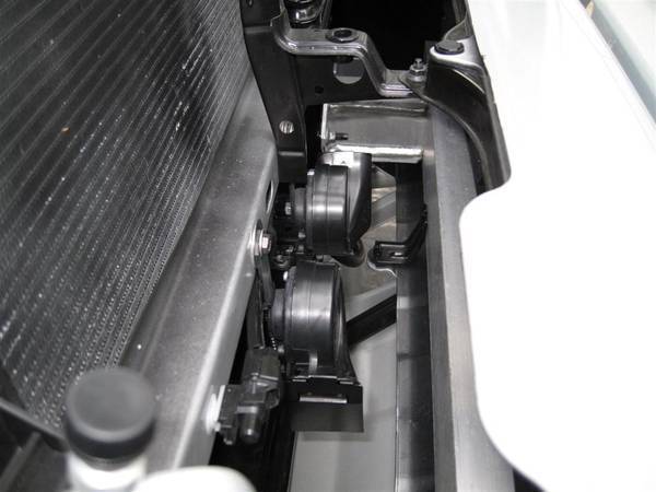

    Side View from Passenger's Side

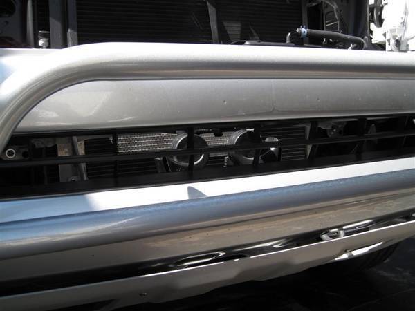

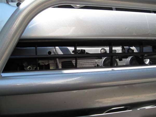

    Viewed thru Lower Grill.
    Once Grill installed and hood closed, you don't see them.

    The "unknown" part in the second pic is the air bag sensor that deploys the air bags if you get in an accident. That being said you should take extra care when handling this piece. Other than that good write up and I will be doing this soon!

    Thank You Adam for Decreasing my Ignorance a little and watching out for all of Us.
    That was an Epic Fail on my part.
    I should have started that thread and asked the dumb question.
    Have Edited the OP reflecting that information

    typically yellow connectors mean SRS system. i know that the unknown part being SRS was already mentioned, but i'm just saying, generally, interior/exterior that rule applies.

    #1. shows where I can pull the temp sensor to - this is the farthest point I can pull it after rerouting it through the SRS sensor hole. I cut every fastener I could find behind the headlight, but it's still not as much slack as what you're showing in your picture.
    #2. shows the nut I used to mount one of the horns
    So as it stands right now, I'm running one horn (one better than none, I guess)
