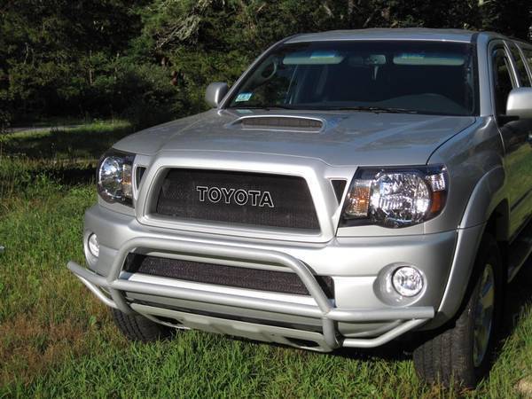

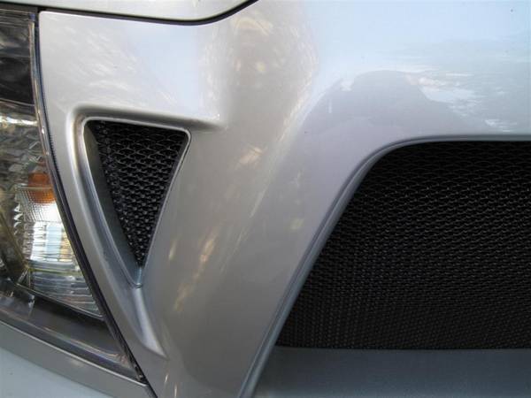

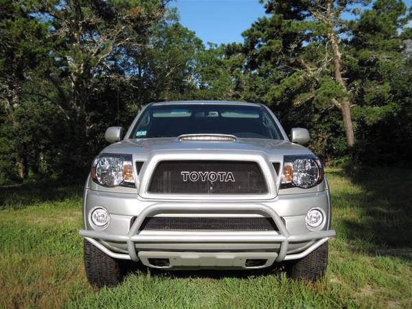

    Found None for a Low, Low Price. I Bought Here:
    http://www.customcargrills.com/index.asp
    Used the Zig-Zag Oval:
    http://customcargrills.com/products.asp?cat=44
    Some Have Bought Storm Door Mesh @ Lowe's or Home Depot.
    Someone Here Cut Up a Patio Table Recently, Came Out Nice, Link Here:
    http://www.tacomaworld.com/forum/2nd-gen-tacomas/99288-its-table-now-its-satoshi.html
    CloseUp Sample Of Mine:
    [​IMG] [​IMG][​IMG] [​IMG][​IMG] [​IMG]

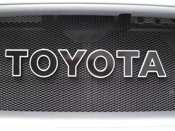

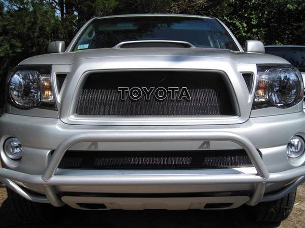

    It's Lookin' Good!
    I Color Matched the Recessed Grill Surround You've Finished Patching.
    Even Matched the Triangle Recess and Meshed 'em
    I Think It Really Completes the Grill, Seein' the TRD Sport is all Color Matched. (Picture Below)
    The Emblem: AFTER Filling the Back With Epoxy and
    AFTER Positioning and Taping It to the Grill to Mark the Screw Holes.
    I Cut the Letter Apart With a Hacksaw, Then Used a Dremel with Sanding Drum.
    After Getting Close to the Edge of Each Letter, I Used a Coarse Flat File, to Finish,
    Keeping the Same Bevel, All the Way Around Each Letter.
    Then Sand It for Paint. Little Bit of Utility Knife When Needed.
    Back to the Letter "A" From My Last Post:
    You Can Probably Take Out Most or All the Interior With The Utility Knife
    and Some Folded Sand Paper If You Don't Have the Jeweler's or a Small Wedge Shaped File
    Also, If You Didn't See It In One Of My Previous Posts.
    Don't Used a Brush to Color Match the Emblem Outline (Rabbit).
    Take the Time to Tape and Spray It (Unless You Do Something Like Freehand Pin Striping for a Living)
    And If You Color Match Just the Outline, Being Dark, You Won't See It From 50' Away.
    My Outline is Silver, and is Barely Visible from 50'-75', Unless the Sun's On It. See Pics Below
    Plenty More Pics in My Gallery: http://www.tacomaworld.com/gallery/showgallery.php/ppuser/31714/cat/500
    Anyway, Good Luck and Take Your Time (I was rushing, that's why I used a brush instead of taking the time to tape and spray).
    I'll Be Lookin' forward to Seeing It. If You've Any More Questions, I'll Be Glad to Help.
    What Are Your Thoughts on Emblem (and Surround) Paint, Now?
    [​IMG] [​IMG]
