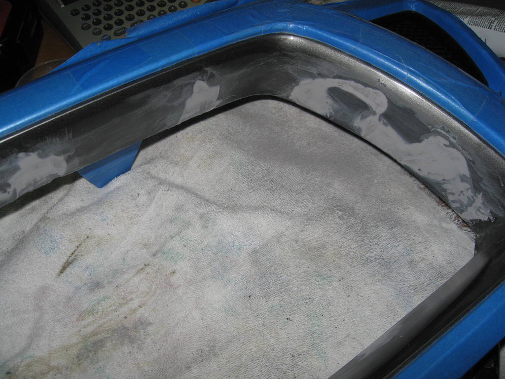

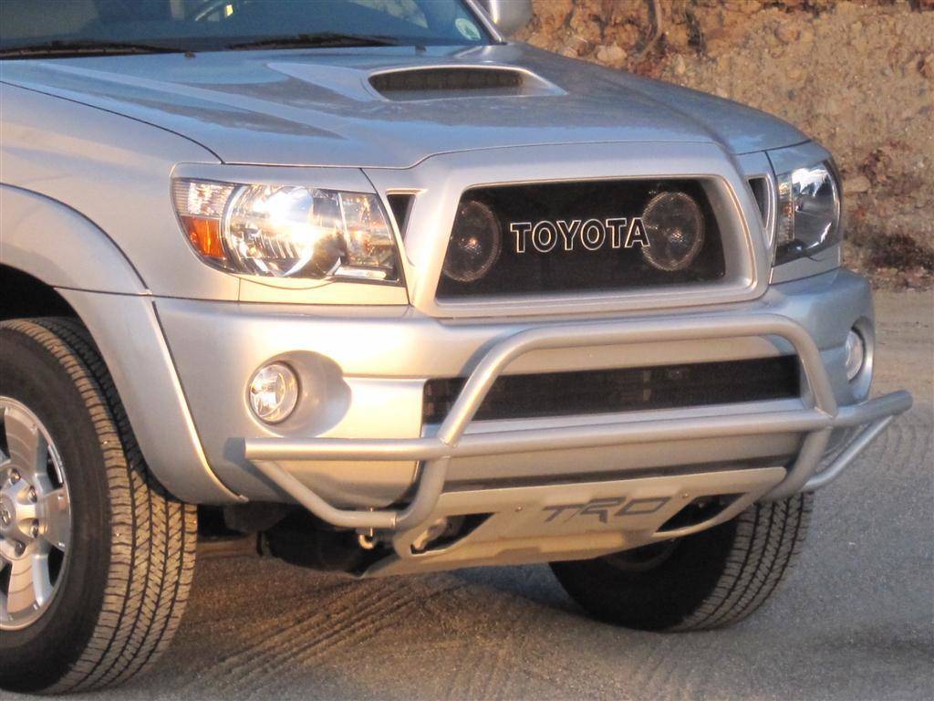

    I understand, Time's our most precious commodity
    You wouldn't touch the chrome making a Satoshi
    Below is a Chrome Grill modified to be a Satoshi.
    You cut out the center without touching the outer surface.
    This is waiting for the mesh to be installed
    This is mine during the process. The Blue is painters tape covering what would be your Chrome.

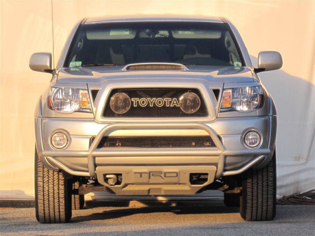

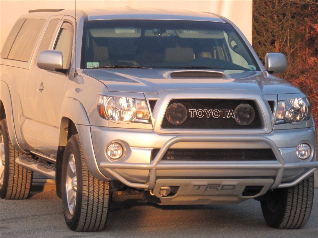

    Apologies for the lack of replies, been busy and hadn't been on for quite a while.
    Glad to see ppl still subscribing and makin' use of the info here.
    The following replies are seriously late and likely irrelevant now, again, sorry.
    Thanks, but know nothing about Autodepo grill
    Uh.........No. Sorry no time
    Thanks
    Sucks that happened, how'd you make out
    Have no experience. my only concern would be moisture from the back side effecting the adhesive. Tape only contacts 30-35% surface area on mesh as opposed to 100% on a solid surface.
    Emblem Status Update: Almost 4 years and all screws still secure, no loose letters.
    A little of the outline silver paint has chipped, but I've always wanted to repaint it.
    Originally used a brush and shouldn't have.
    Newish Picture:
    CC
