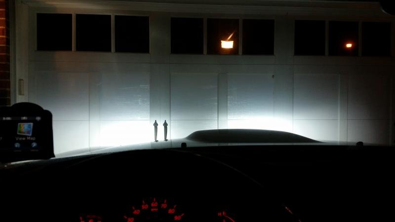

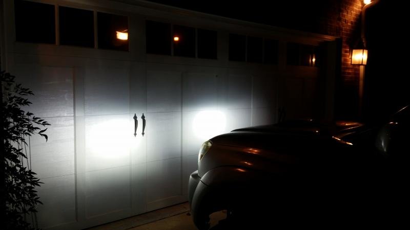

    Nobody is incorrect here. t4daddy is correct in that the bulb will only fit in the housing one way if seated properly. The OP stated that he installed the bulbs incorrectly and that they were not fully seated. It sounds like everything has been resolved now. OP, do you have any photos of the light output now that they are installed correctly?

    The photos in the first post have been updated to show the corrected light output

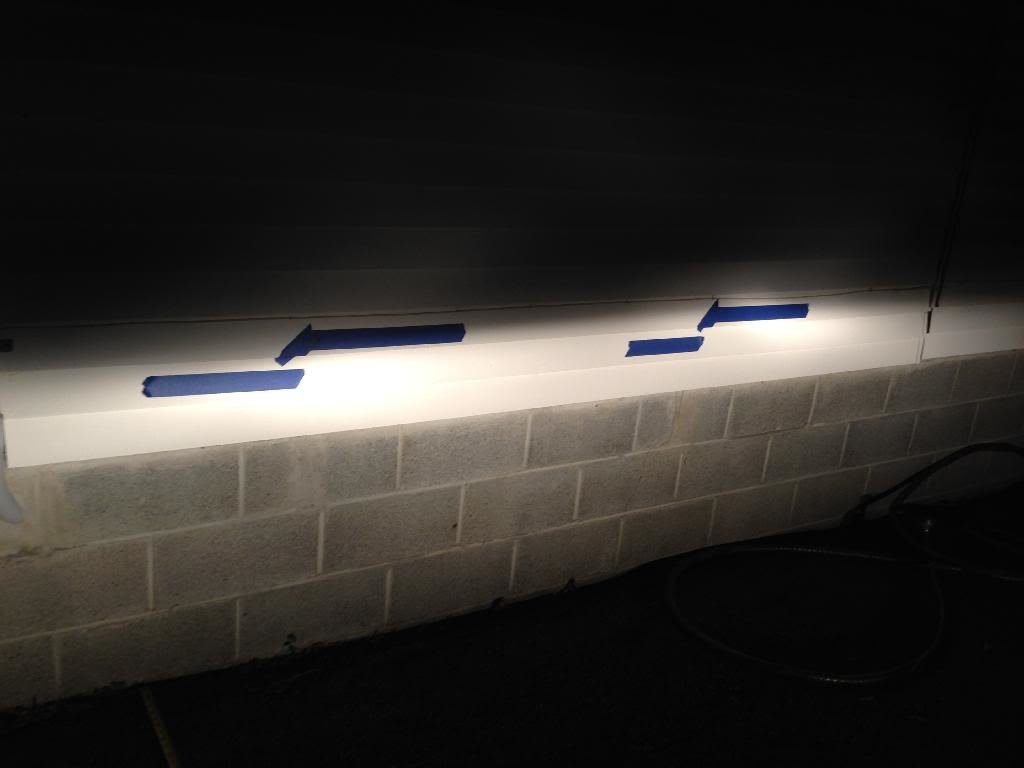

    You need to be a bit further than 2 feet to show cutoffs.
    4F87F31A-4E69-415D-B294-81A2EA4B978D_zps_afbf704aec59d80a3b5e9b2c9396a5978a3f32a5.jpg
    I don't see any cutoff when compared with halogens. The above image is from someone doing a retrofit showing off his halogen cutoffs. I feel you're going to be blinding people still.

    Without projectors, I don't think it's possible to get a clean cutoff line, or much of a cutoff at all. Regardless, they still seem to have much less glare than HIDs

    That's correct. If you look at the photos posted by weendoggy in this thread you can see a comparison between the stock halogens and Brite Ass LEDs in stock headlight housings. You will see that the light output is spread over the same area as the stock halogens, but with much better brightness and consistency (rather than focused on one spot).
