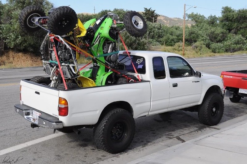

    People assume im a bro, cause my avatar but not even i have the OG lean :cool:

    You doing it wrong
    :cool:

    That is the coolest thing i've seen, and i've seen some cool shit
    :laughing:
