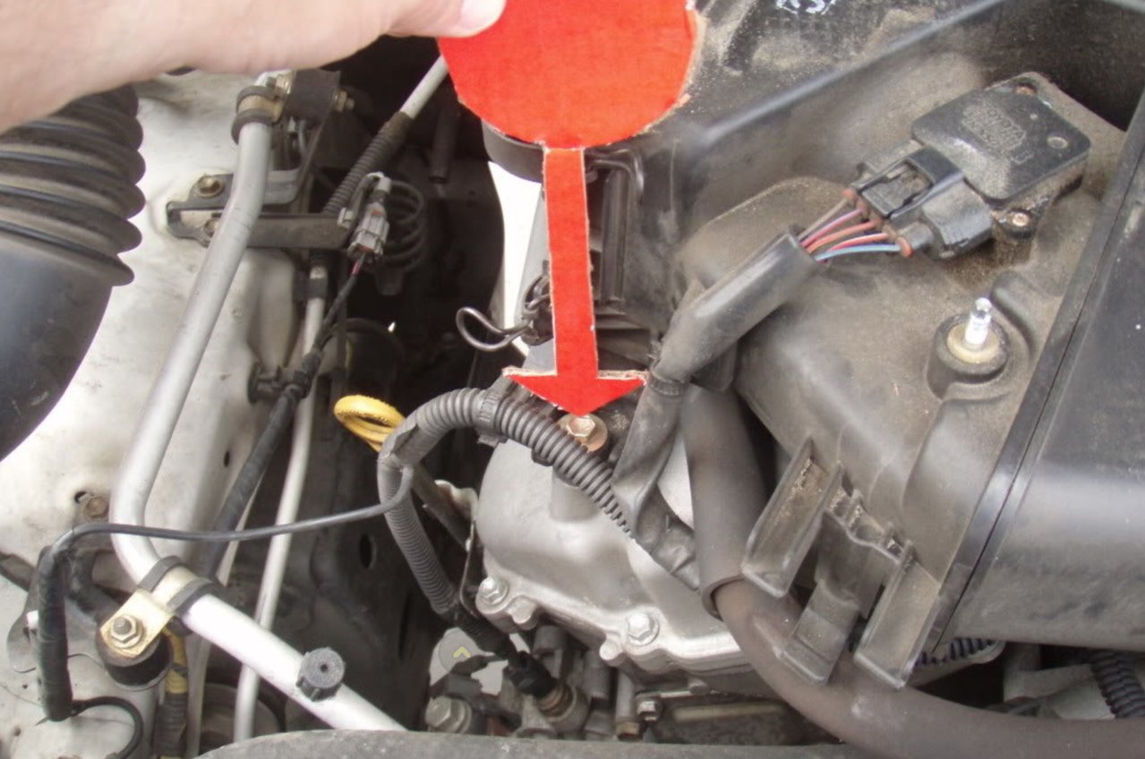

    Put the taco back together today under a deadline and got a little careless...snapped the front bolt to the air cleaner assembly (stole pic from the great red arrow throttle cleaning walkthrough).
    Got about a 1/4 inch of bolt sticking out. Going to see if I get lucky and can remove with vise grips tomorrow. Hoping that works because I'm nervous about drilling it out considering where its stuck. Has anyone else drilled one out here? Doesn't seem like a huge deal to drive around like this for a bit so feel like I have some time to see if anyone has done this and has any best practices.

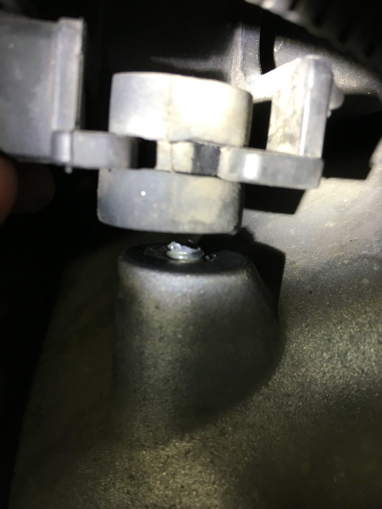

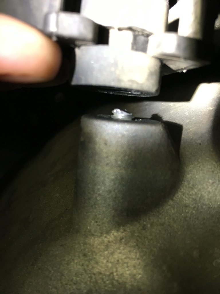

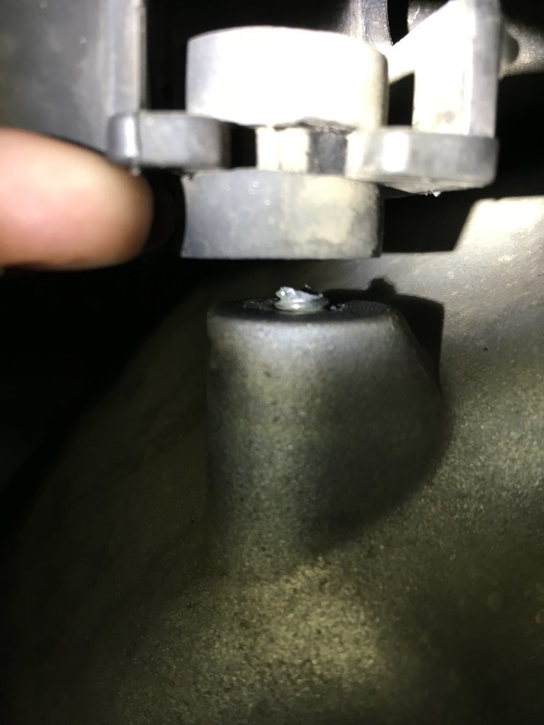

    Pics are below.

    Okay. You still have options.
  8. Sep 16, 2017 at 3:37 PM
    DrFunker
    DrFunker Well-Known Member
    Feb 3, 2014
    #122158
    42,967
    I think you have enough meat on that to work with.
  9. Sep 16, 2017 at 3:42 PM
    DrFunker
    Feb 3, 2014
    #122158
    42,967
    I would try to notch it with a dremel or a hack saw, obviously being careful of the block. Getting that air intake assembly would make it a hell of a lot easier. As I am sure you already know.

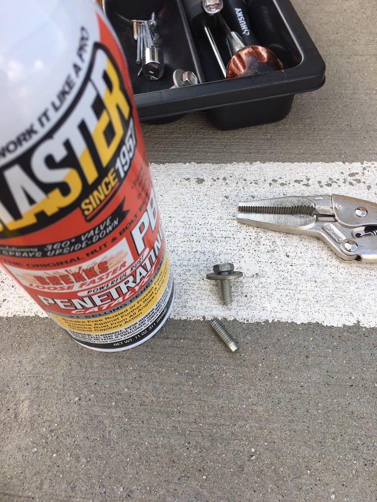

    Quite well! I was nervous about putting a torch to the top of the block there so went with @Wyoming09 advice first as Plan A. Ended up spraying a bit in the morning and evening, let it sit a night, took my time to get the perfect lock on the sheared end, and slowly broke it loose. Once it was loose it was a piece of cake--no drilling, no torch. Was real anxious about this when it first happened because it was right there in the engine but ended up being no biggie. Appreciate the insight and help:cheers:
