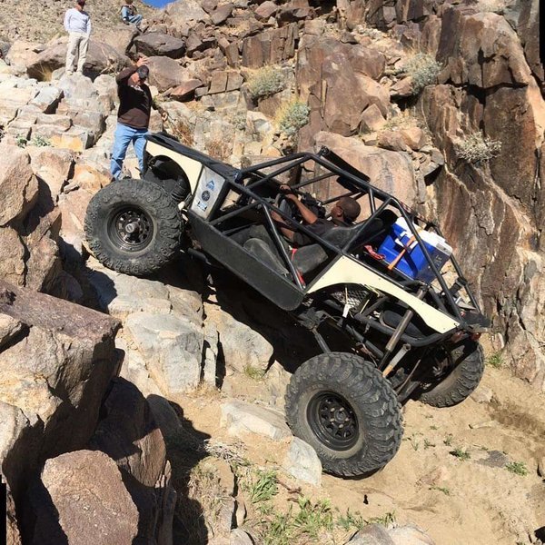

    Time for SAS, CUT, TUB, BOB, 3 LINK, THIS.

  5. May 14, 2016 at 5:36 PM
    #25
    Mully
    Mully Well-Known Member
    Feb 12, 2014
    #122907
    5,269
    CA
    12 DC 4x4 Lifted Sport
    Lifted, Kings, Locked, 295s and more.
    This.
