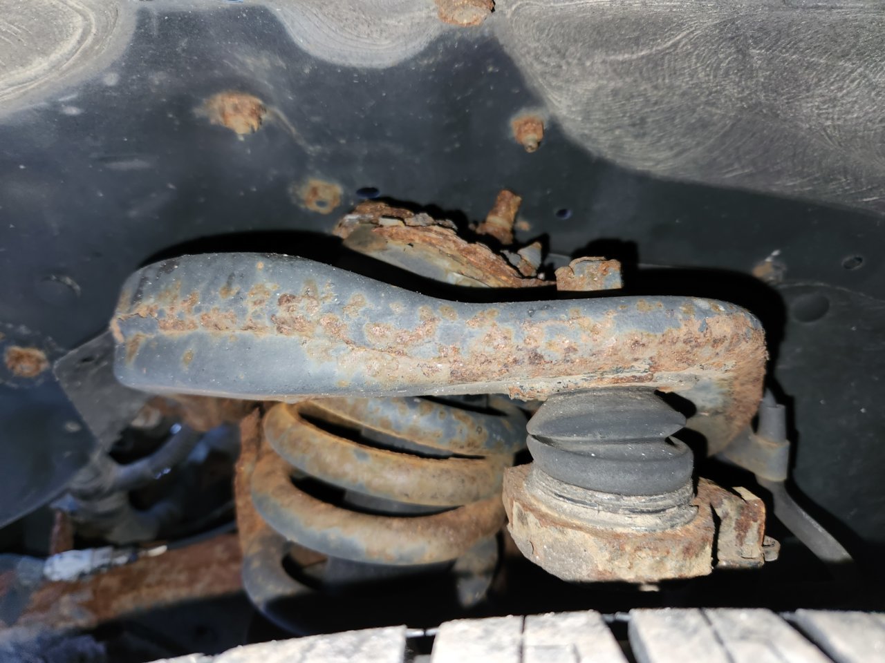

    This just happened to my truck. What was the final outcome for your truck? Did it get fixed?

    Do you have any pics of the damage. Was it the passenger side?

    Drivers side.

    Pics of the shock setup? I wonder if its an adjustable bilstein setup on the top setting.

    If the rest of the frame is equally as rusty as that coilbucket, I'd say you're SOL in fixing that.
    If you want to save it, I would be on the search for a used frame.
