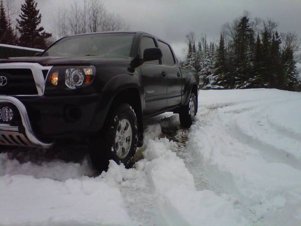

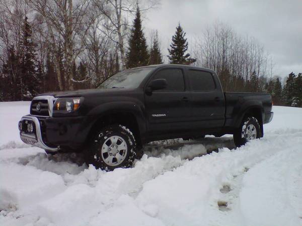

    Sorry for the crappy cell pics but you get the idea. This is Bilstein 5100's on all 4 corners with the front set at 1.75 with a Wheeler's HD leaf pack in the rear (4 leafs 1 overload).
    Before lift measurements center hub to fender:
    FR: 20 inches
    FL: 20 inches
    RR: 22 inches
    RL: 22 inches
    After lift center hub to fender:
    FR: 22 inches
    FL: 22 inches
    RR: 24 inches
    RL: 24 inches
    Full 2 inches all the way around.
    I haven't got around to measuring post lift drive angles because of all the snow we got but prior to the lift my driveshaft was almost straight with a - 5 deg angle towards the rear end. Will update with better pics when we get a nice day.
    First impressions are pretty good, I haven't been able to try it out that much because of the weather. The ride is slightly stiffer than stock, it doesn't float over bumps anymore it's a little more jarring but nothing crazy. There isn't much room between the 4th leaf and the overload so I can't imagine much flex out of this pack.
    More updates to come.
