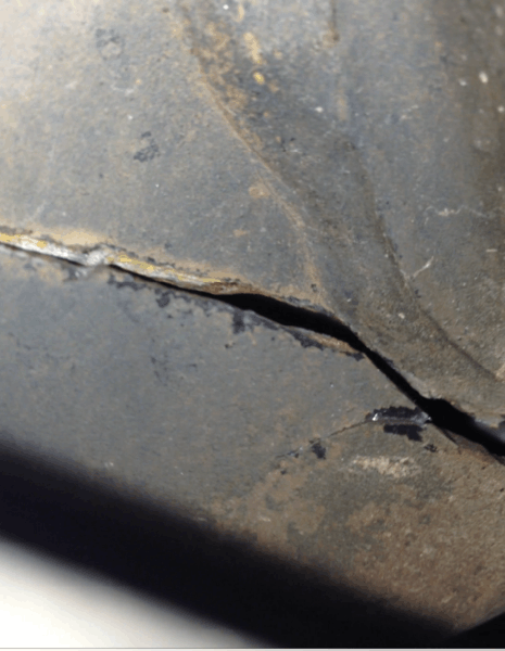

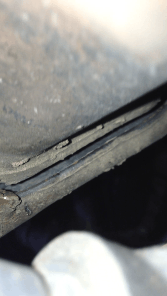

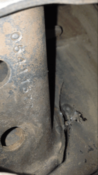

  10. Jan 11, 2014 at 2:59 PM
    #30
    DDD
    DDD Shine bright like a hymen
    Mar 6, 2009
    #14416
    2,303
    Derek
    Santa Clarita, CA
    Just found that my frame is cracked under the driver side motor mount.
    2006 with 80k miles.
    I'm gonna take it to the dealer and see what they say but I'm pretty sure dealer will not replace the frame. Even though it has nothing to do with the mounts I have sliders welded on and a steel bumper and winch.
  11. Jan 15, 2014 at 5:08 PM
    #31
    DDD
    Mar 6, 2009
    #14416
    2,303
    Derek
    Santa Clarita, CA
    Update: the dealer looked at it and said they would not replace the frame. They gave me the 800 number to Toyota and said to call them and complain.
    I'm not interested in weeks of complaining to Toyota and months without my truck if the dealer replaces the frame. Plus any problems that arise from getting a frame replaced.
    I ordered the gussets from DMZ fab and will be doing the repair this weekend.
