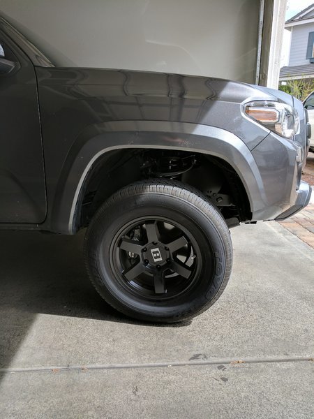

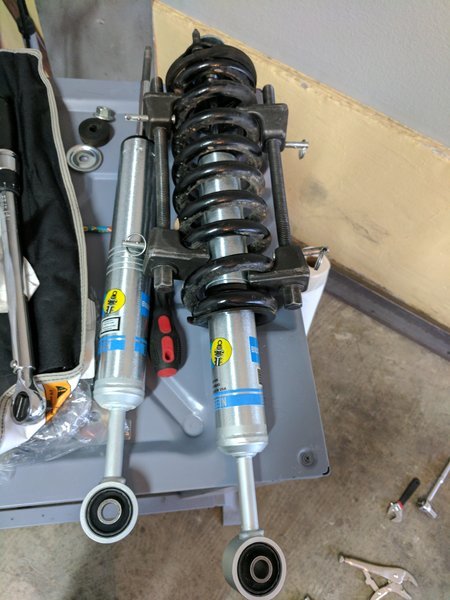

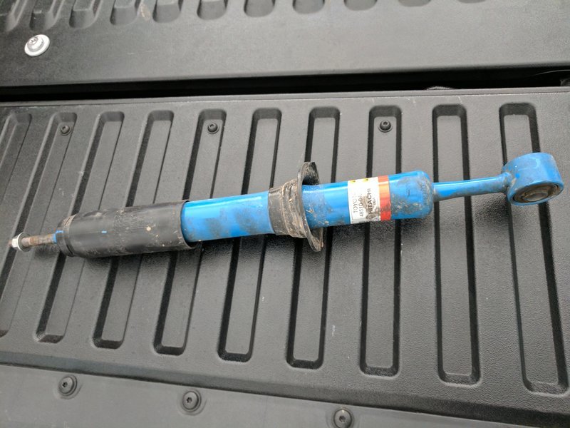

    Two days ago I purchased Bilstein 24-265108 5100s for my TRD sport and installed them on ring #3 to get a 1.1" lift up front. The original shocks were completely dead at 17k (Hitachi garbage) I could take the drivers shock and compress it by hand with minimal effort.
    While I was under the truck I checked my U-bolts on the leaf pack only to find out that I was able to turn one of the nuts by hand ! I have read a few threads about u-bolt torque specs and torqued them to what I thought was best. You are free to do your own homework on these torque specs.
    Everything went smooth as butter and the ride is much better. The truck feels comfortable and the axle wrap is completely gone. The nose dive under braking is small compared to before. I didnt install the dust boot because i didn't want to, if you choose to install them that is up to you. Lets not make this a thread about dust boots.

    The ride is certainly more plush even with the suspension angles changing by 1.1" I will be very honest and say it doesn't ride like my 4runner but worlds better than stock sport shocks. The overall feel of the truck makes me want to drive it more aggressively on road as it feels more in control and balanced.

    Should have added new springs and left the 5100s set to zero... and AALs for the rear. That with the 5100s will tighten up the suspension a lot more but still rides soft on roads and off road much more aggressive. Keeps the feets on the floor. Stock Sport suspension sucks unless you have a load in the back... I had to drive with a bale of hay until I put on my suspension.
    The 5100s are valved the same as the OR Bilstein shocks cept for longer travel...

    Source? The OR bilsteins and the 5100's arent even the same diameter shocks. Or bilsteins are little 1.6in shocks, 5100's are 2in shocks... How are these valved the same?

    I've never held a shock obsorber that I couldn't compress with my hands and they're not supposed to spring back after being compressed.

    Yeah dont believe everything you read on TW. You will get lost in the shit. There are several threads that compare the OR bilsteins to 5100s.
