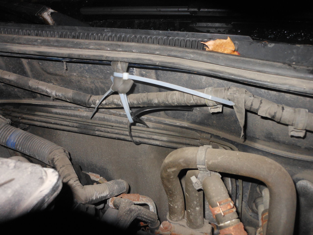

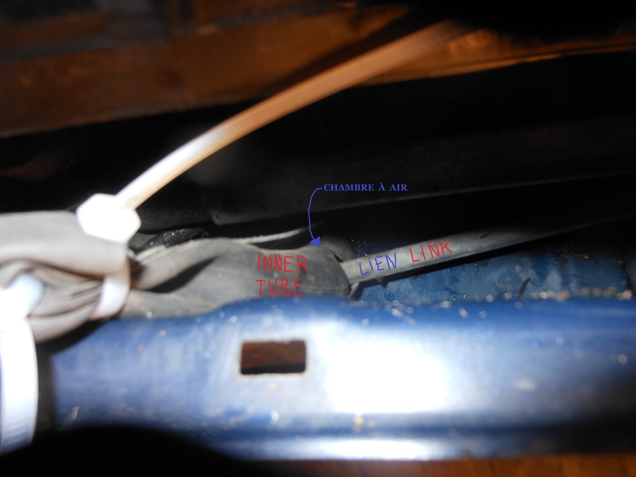

    Here is my fix for this link popping out of its socket. Il happened on my '08 Tacoma in the heart of winter, so I did not want to spend a lot of time fixing it outside. I used an old about 8 inch long section of bicycle inner tube. I cut a roughly 1/2 inch hole at one end and inserted this tube in the linkage and tied the other end, after extending it somewhat, to the truck frame. This tube acts as a spring forcing the socket into its holder.
    Of course I cleaned up the socket and holder and regreased the joint before inserting the tube. It's been a month since the fix and it holds up. I make sure the blades are not stuck in ice before operating the wipers. I had the exact same problem with my 10 year old Frontier. This is a bad design!

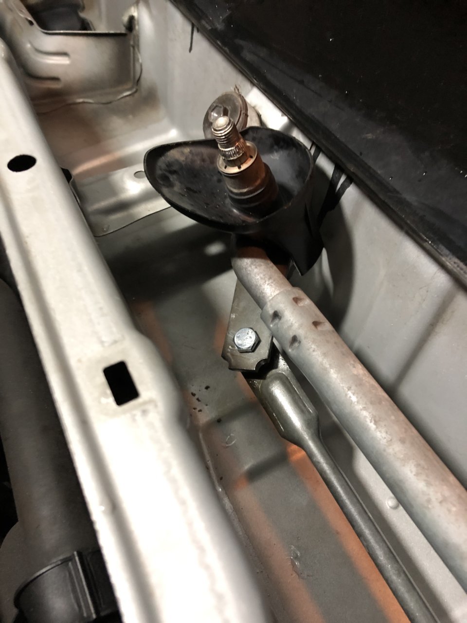

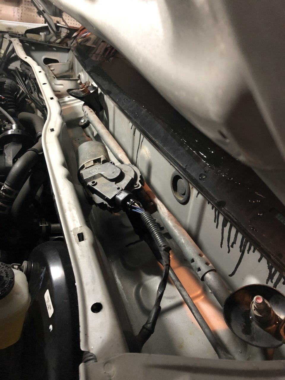

    I just had to do this repair to my passenger side after it failed last night. I drilled mine out and put a bolt through the center of the old bushing. to me the hardest part of the job was removing the reinstalling the plastic cover that gives you access to the wiper motor and assembly. I should have taken more pictures but I was in a rush, had to get to work.
