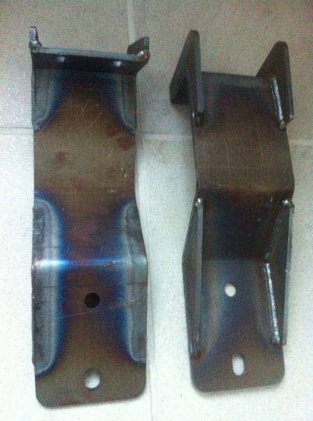

    Hell yeah - pure Cali beef!
    I wish I could leave them raw - the welds are kick ass.
    Thanks Billy!

    My backing plate only has one oblong hole. Is the missing one the pita you refer to?

    I think you have to drill de second hole.

    ^^^Correct. You need to drill the 2nd hole. It's fairly quick - take a small bit to start a hole. Then use a 1/2" bit. Repeat again with the back side of the frame. My 1/2" drill bit was just long enough but I had to use an extension for the pilot hole.
    Use some cutting oil, lubricant or WD40 at a minimum. With the right drill speed, bit and lubricant it can take surprisingly little time.

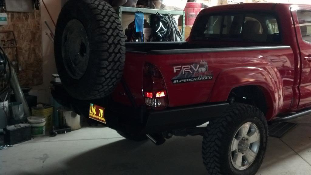

    Here you go Billy thanks a lot the bumper is great :D
