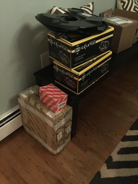

    Friday should have some time to install the brake upgrade. Finally got all the pieces in the mail:
    Can't wait to see if there is significant brake performance improvement, but anything will be better than the original pads and rotors I still have on at 75K miles.
    Also need to find out why my ABS light is on and staying on, hopefully just a dirty sensor or something little.

    What brake upgrade you going with?

    And the results are in....
    My truck stops way better than expected it to. Had it fully weighted down, did some break in runs. I feel confident now when I brake from higher speeds (60-0). Definitely worth the time to get this done if you have 17" wheels. (Not sure 16" wheels would clear the bigger rotors) It's like the 1st gen tundra brake upgrade but for 2nd gens with 4Runner/Lexus parts.
