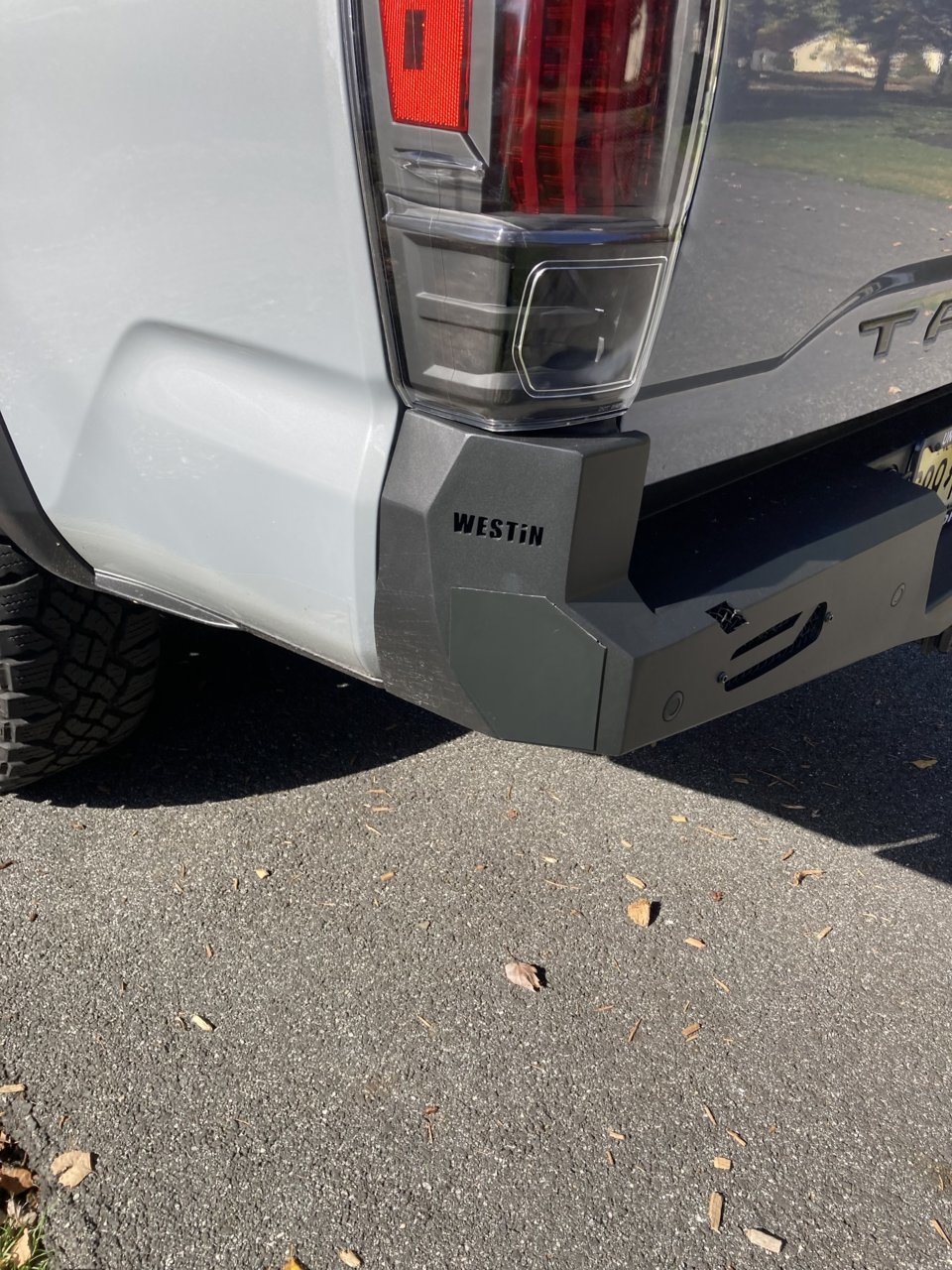

    I got hit in the corner of my left bumper. The bumper cap plus the bracket that holds the BSM was cracked. Luckily the BSM was not damaged. Decided to go with a steel bumper because the Tacoma bumper is just three pieces of plastic garbage. I bought the Westin Pro Series rear bumper. At first, Westin said the bumper was BSM compatible, and then said it was not. I wasn’t sure if that was for liability or functionality reasons, but It was a nice looking bumper anyway so I pulled the plug. It was a pain in the neck pulling the OEM bumper off. I broke one of the hole parking sensors. I replaced in with a RAV4 one on Amazon, which was identical, for 10 bucks. Toyota wanted 150. I bought the Westin bumper for under a grand shipped. I read on this forum that the metal mesh in the corners of the Westin bumper will interfere with the BSM radar so I cut out the mesh. After I installed the bumper, I did not know that the BSM’s must be oriented at a 50 degree angle plus or minus 3 degrees or you will get a fault after driving. I got the BSM Unavailable message. I thought that I could clear it with the OBD. The only way to clear the fault is by using Toyota’s proprietary software Techstream. I called 3 different dealers and got 3 different prices to recalibrate them. Needless to say, it was not cheap. I’m happy to say my BSM’s work with a steel bumper. I bought a sheet of Kyvex plastic and double sided tape and covered the hole. Here is the result.
