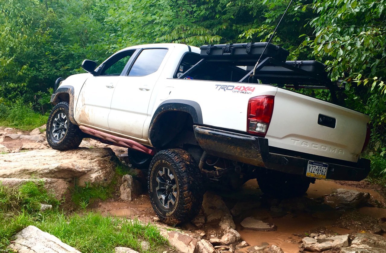

    To give a manufactures perspective; the problems with designing a bumper around them are many.
    1. The sensors radar field of view cannot be interrupted by metal. That means in a steel plate bumper they have to be mounted near the surface, either not covered, or protected by a plastic of some kind.
    2. Their size means that the side wings of the bumper will have to be made larger than otherwise necessary.
    3. They will need to be mounted at the same angle as factory, thus further complicating bumper style and function.
    4. Even if we deal with 1-3, which isn't impossible, we can't do the kind of testing that Toyota does. HUGE liability if our bumper mounts the sensor 1 degree off from OEM and that somehow causes some random crash down the road.
    It's just not worth it.
