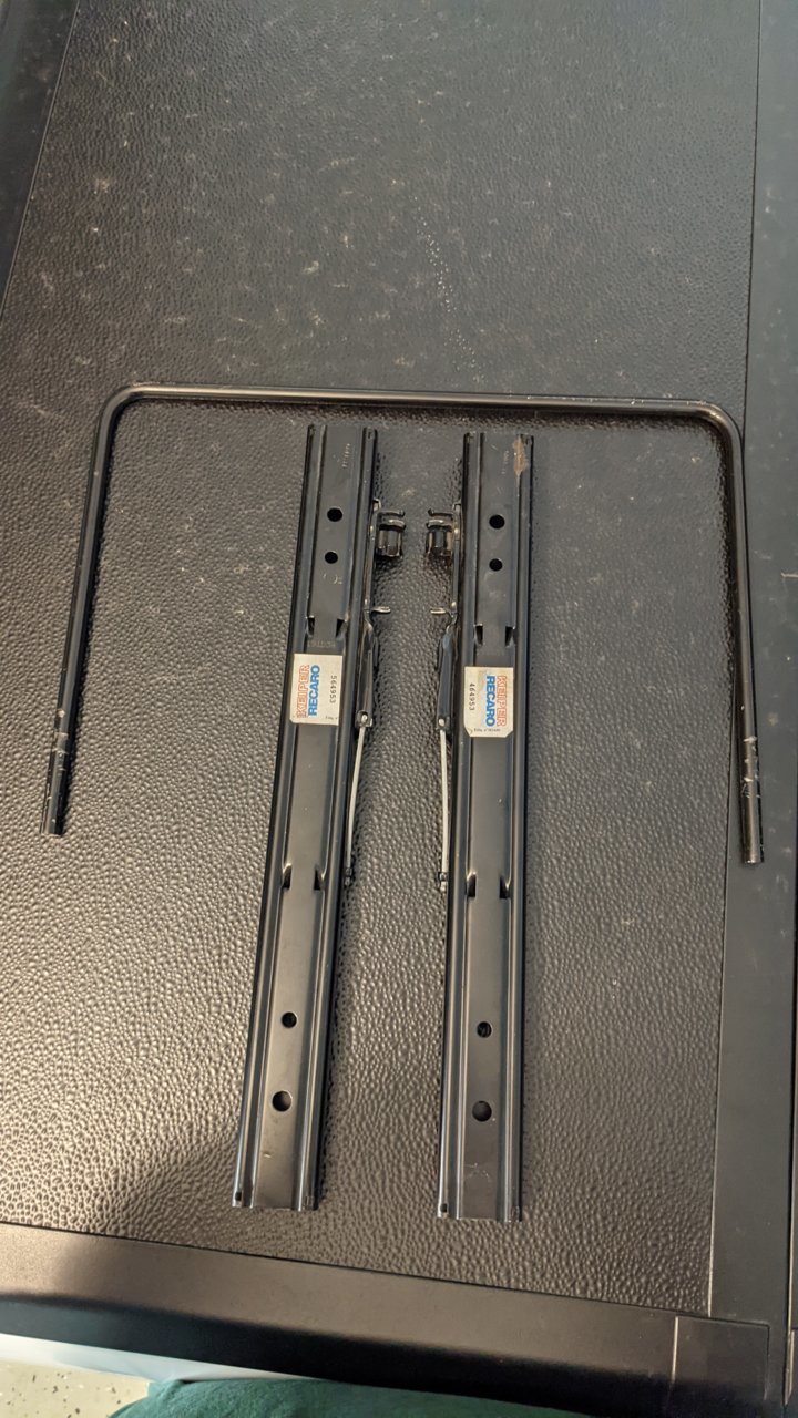

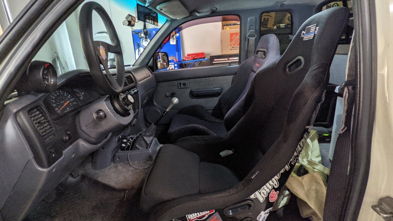

    Desmond Regamaster MP
    Planted brackets.
    If you're going to use NRG seats, the holes won't line up so you'll need to drill new holes on the bracket you fit them.
    I believe the planted brackets are made specific for both Corbeau or Recaro. My Recaro seat on Recaro sliders bolted right up without modification. My NRG bucket required an extra hole drilled onto the bracket.
