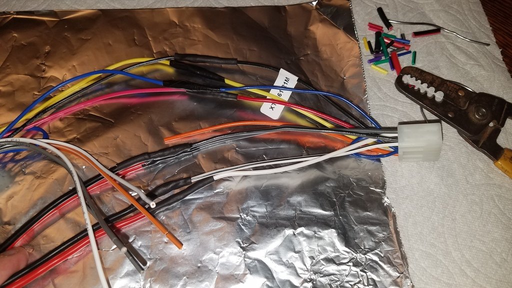

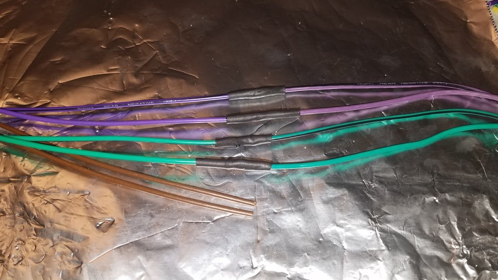

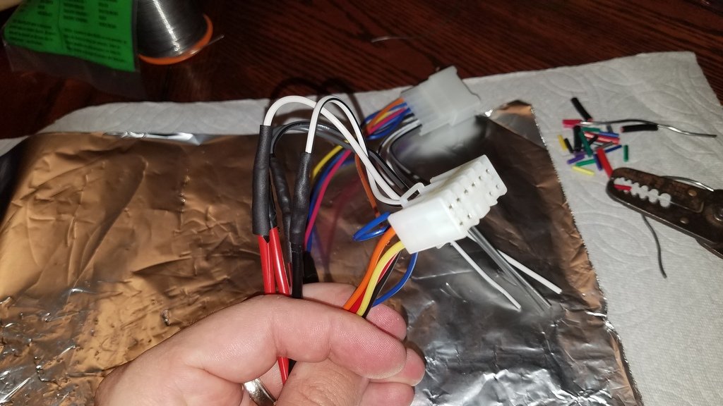

    I got some of the grunt work done tonight. The sub is put in and the wiring harnesses are soldered together. I'm quite sure I got this right, but just to confirm, the factory head unit has the female side on it, so I put the speaker wire leads to the LOC on the male harness, correct? God, I hope so. Also, there is an orange wire on one harness and an orange/white on the other. I didn't connect those to anything. Same goes with a couple of brown wires on one harness that aren't on the other. Are those just extras for certain applications not applicable to the Tacoma? Can I just leave them? Take a look at my pictures below and make sure I didn't miss anything.
    I still have to seal off the other side of the sub enclosure as it is designed for two 10's, but I'm just doing the one. It gives me a bit of headroom in interior volume, so it works out.
    I've laid out where the amps, LOC, and the crossovers for the door speakers will get mounted on the box. It should be fairly organized. Making a little progress, which is nice. I might get to start pulling seats tomorrow night to give me a head start on the weekend. If I can have the back wall and floor deadened with the wires run by the end of the weekend, I'll be happy with the progress.
    Does this look right?
    Speaker wire leads to LOC:
    Extra orange wire on the male side and orange/white on the female side:
    Extra brown wires but, in hindsight, I'm thinking this harness is completely unnecessary:

    I'm afraid it doesn't work like that. If your sub is already in an optimal sealed enclosure, and you double the enclosure volume you should wind up with a lower F3 but at the expense of power handling. You're giving yourself LESS headroom in that regard. What I'd do personally is find a sub that works well in that airspace with a passive radiator in the other side...like a Dayton HO. Err the sub you have might work - would need to model it. That way you get the benefits of a ported enclosure without port noise. And it's tune-able via cone mass on the radiator.
