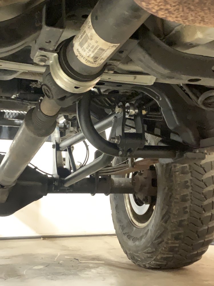

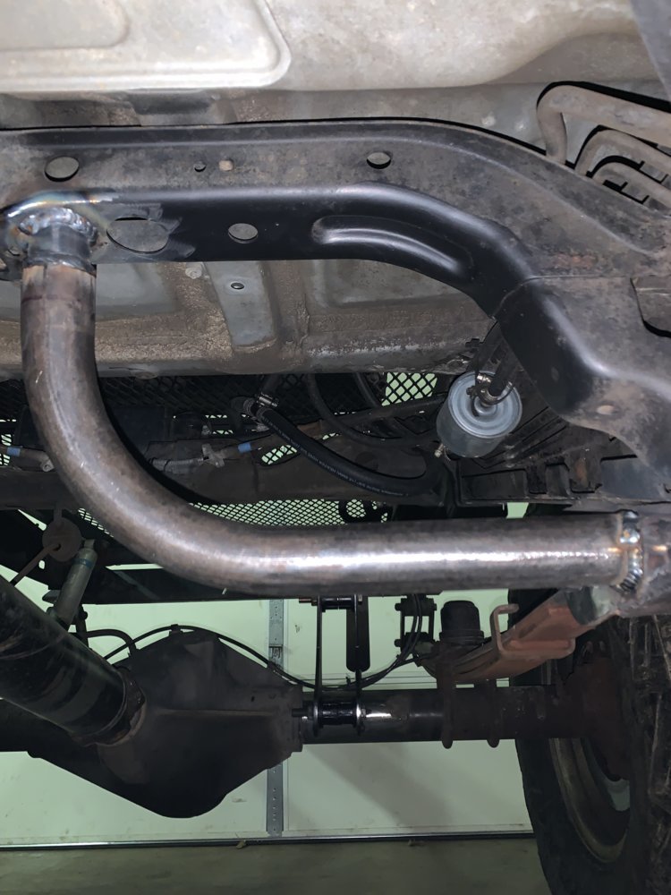

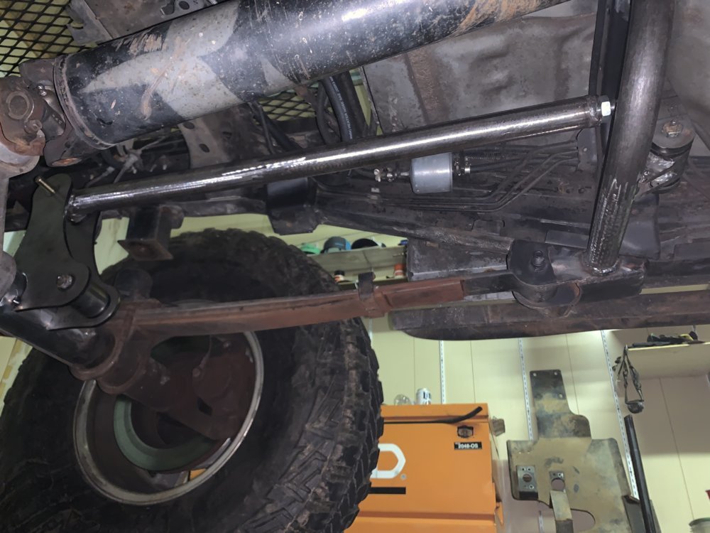

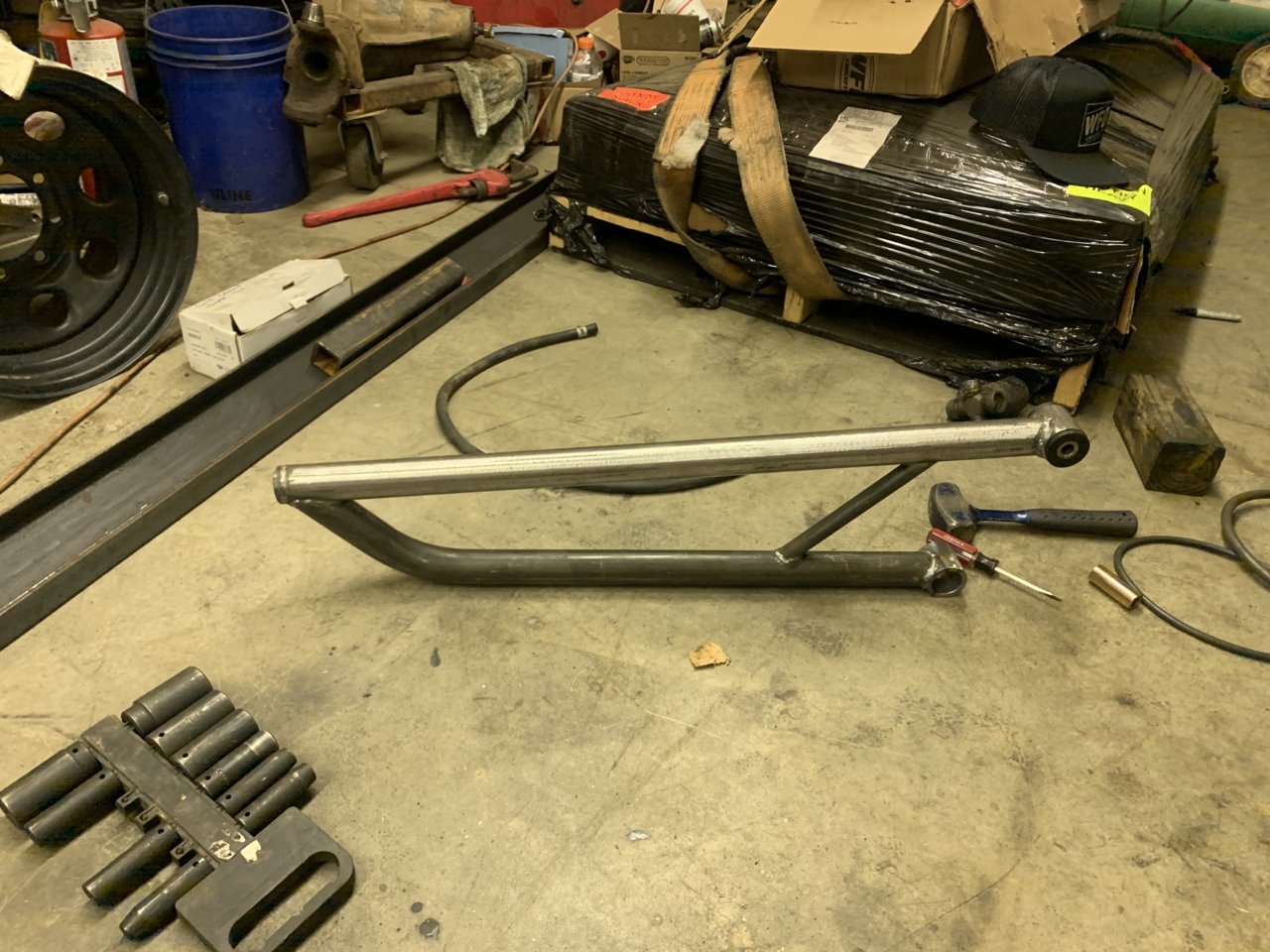

    Rear end had some axle wrap. Thought I’d throw together an anti-wrap bar to help keep my U joints from snapping.

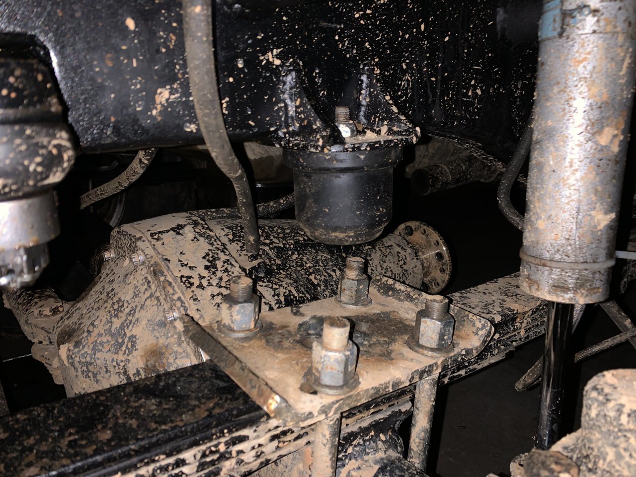

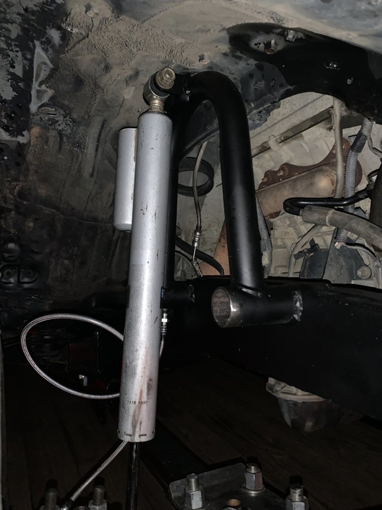

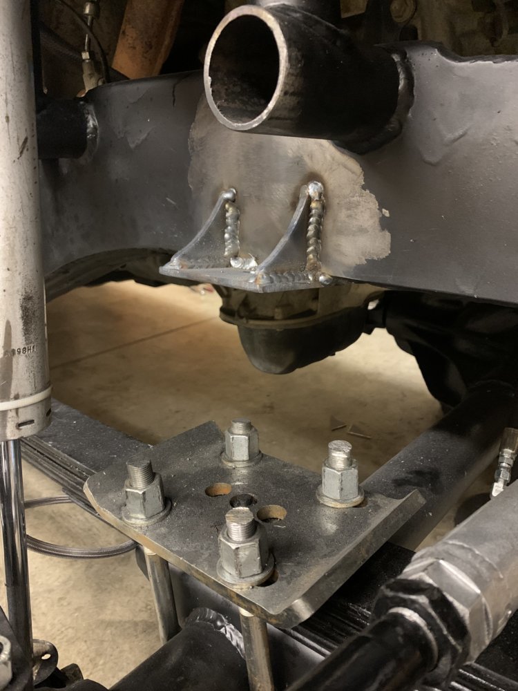

    Couldn’t get much up travel on this thing. Made some bump stop mounts. Had some of the Wheelers Superbumps from the IFS.
    Figured I’d use those to save some $.
    Wouldn’t mind going to some air bumps in the future. Would be nice to be able to tune them.

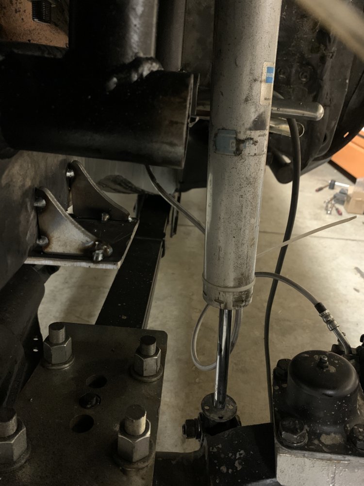

    Forgot to mention shocks... I used some Bilsteins I had. They have 14 inches of travel.

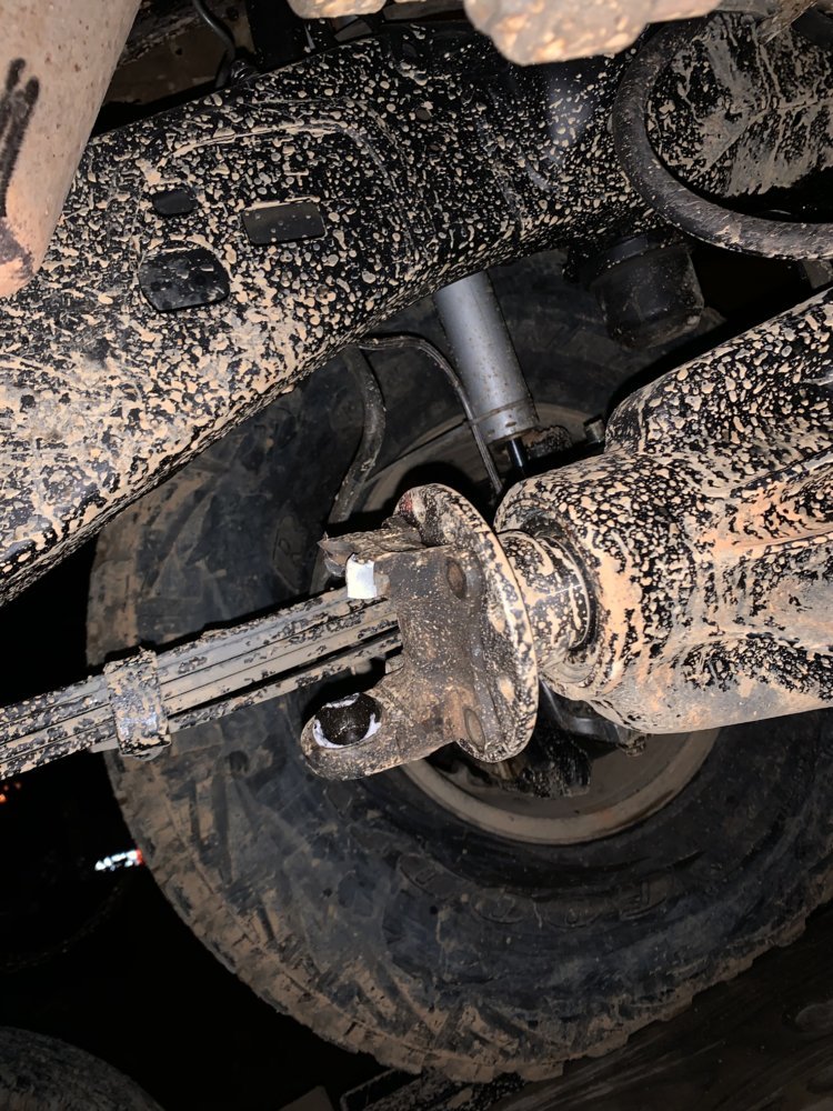

    Brings y’all up to present day.

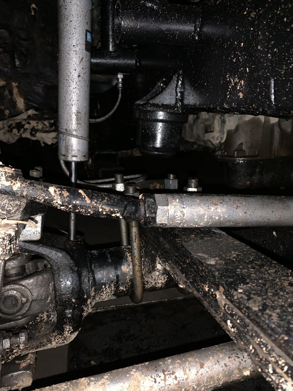

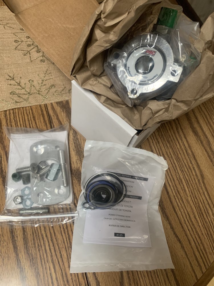

    Took it on a shakedown run. Broke some stuff.

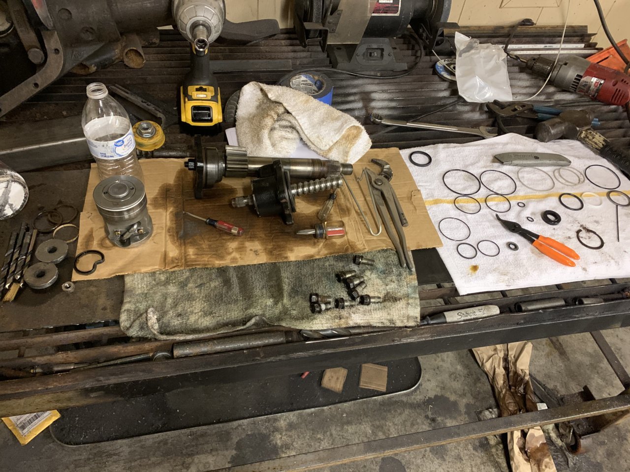

    Broke front U joint. I think the axle wrapped and the U joint angle maxed out and got in a bind. I was also a little airborne and didn’t let out of the throttle. So there’s that.

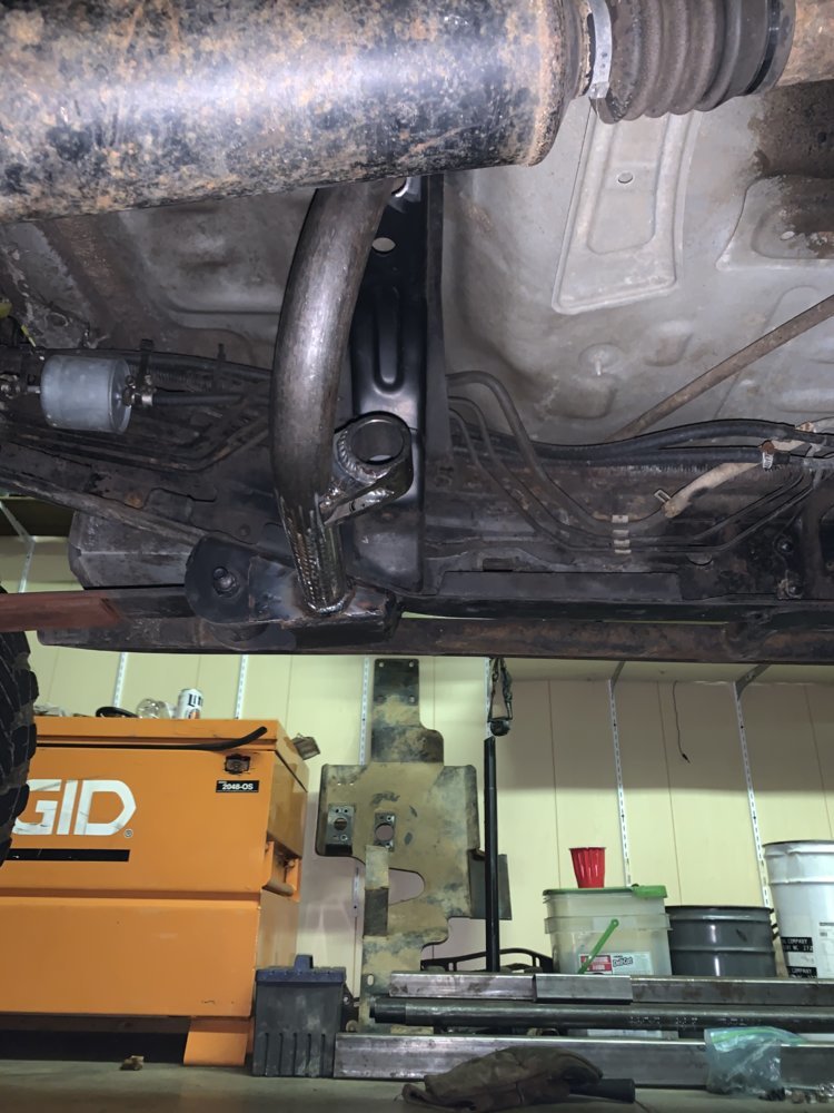

    Passenger side bump must have taken a huge hit. It’s fine, but the drag link hit the frame and bent the DLE.
    I’ll have to notch out the frame to clear it in the future.

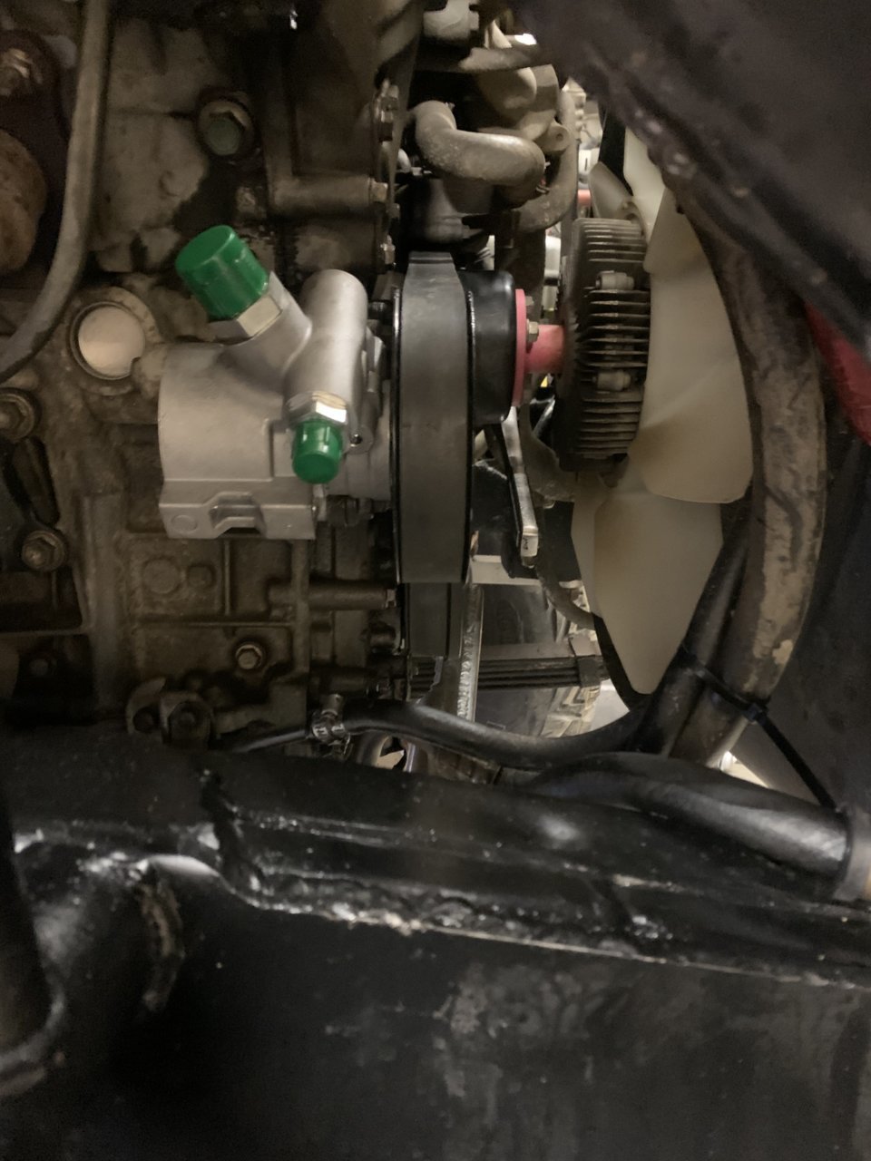

    Stock power steering pump blew out. Box is leaking too.
    Ordered a PSC TC pump that should put out more PSI. Rebuild kit for the box. And a kit to use the tundra booster and GM 1 ton master cylinder. Brakes aren’t terrible, but when I go to a bigger tire than a 37 I’m gonna want good brakes.
    Gonna move the inlet to my reservoir lower to help with cavitation. Keeps air out of the system.

    Some pics of the bumps and the drag link end I bent.

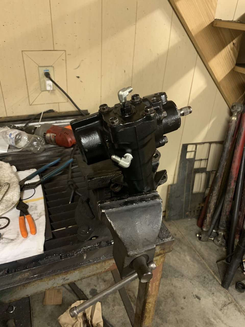

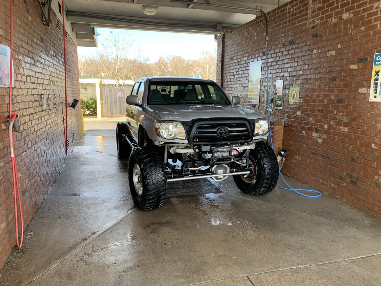

    Finally had a day off to clean her up before I tear into the steering.
