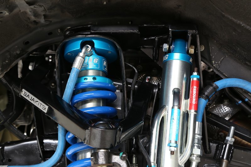

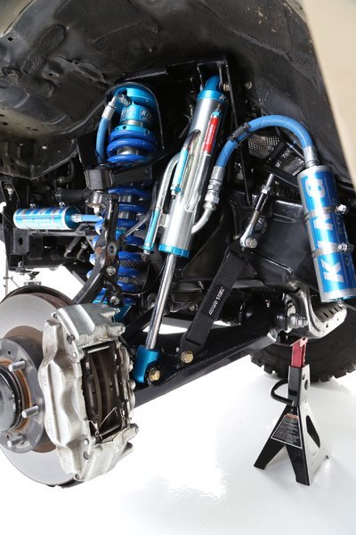

    JT@Bajakits
    JT@Bajakits Well-Known Member Vendor
    Jan 26, 2016
    #176129
    607
    JT
    Race Trucks and Off Road Suspension
    OP...
    We have 2 kits available for your Tacoma.
    Chase Kit - Boxed UCA and Extended Travel King 2.5 Coilovers
    +2 Prerunner Kit - Boxed upper and lower arms running a King 2.5 Coilover with an option to run a secondary Bypass.
    Email me at JT@Bajakits.com and I can get you taken care of on what will work best for your needs and budget!
    Thanks
    JT
