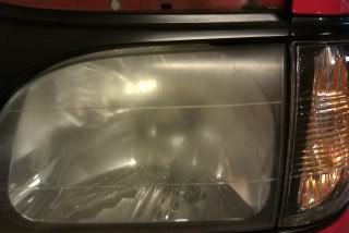

    Is it true you can remove your headlights and buff them to get the hazing/fogging out? Mine are far from clear and not only does it look bad, it makes it difficult to see at night, they're not NEAR as bright as i'd like em. If not does anyone have a reccomendation for nice bright head/tail lights?

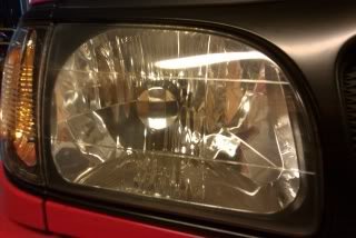

    Worked amazing! I got before and after pics
