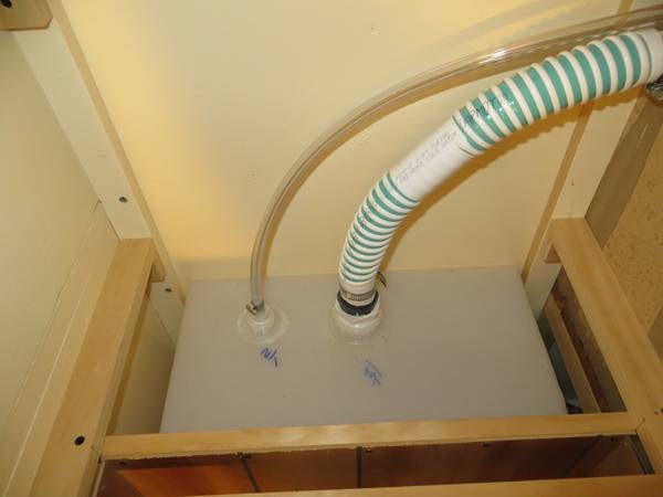

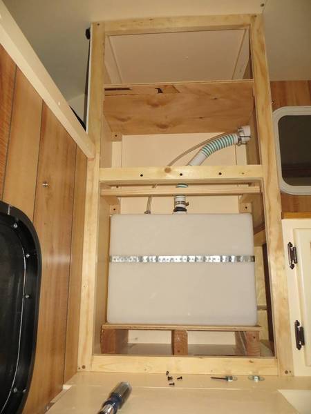

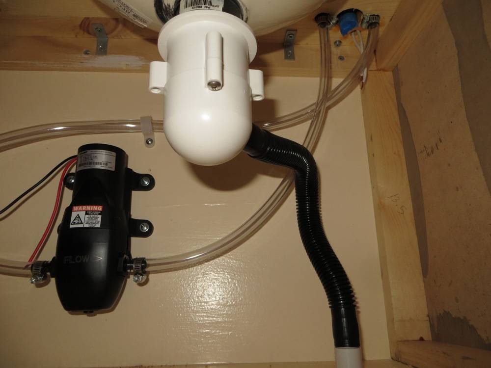

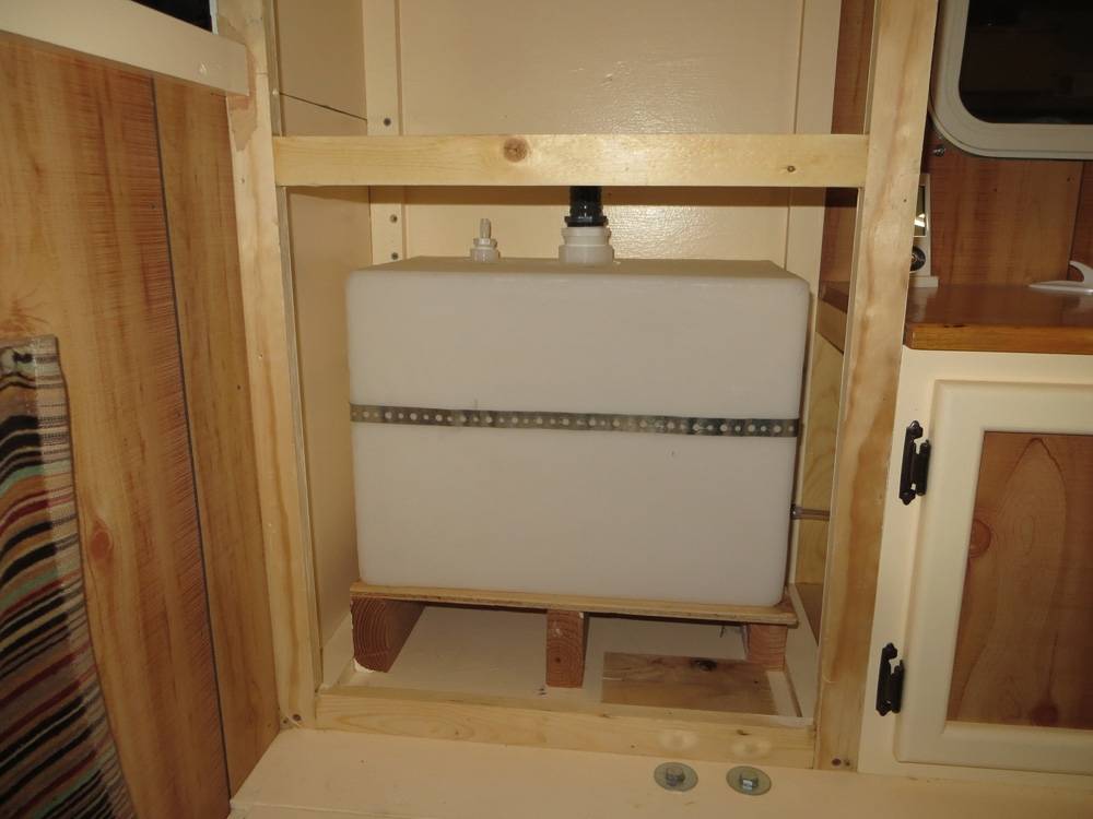

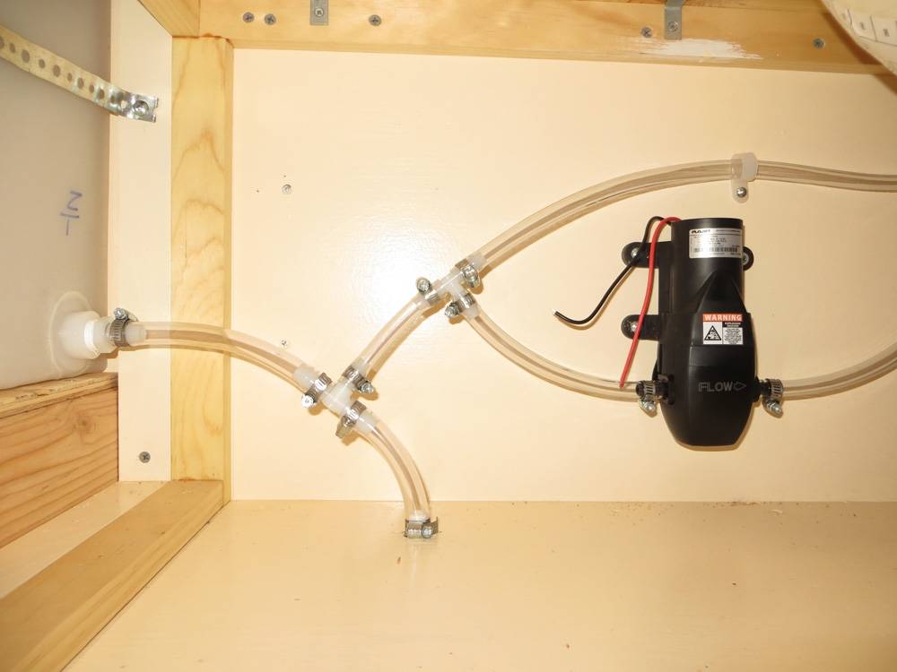

    Got the tank Friday. Spent the day chasing parts and putting the water system together. I'll hook up the power tomorrow and test it for leaks.

    '11 TRD Off-Planet AccessCab
    Plumbing finished and tested. Just needs to be road tested now.

    Looks good! Like the inside water fill, no chance for someone tampering with your water supply.

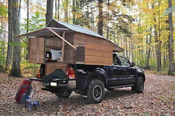

    K&N, Leaf Springs, Home Built Camper

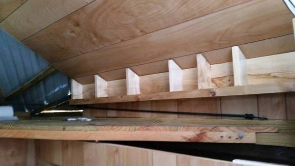

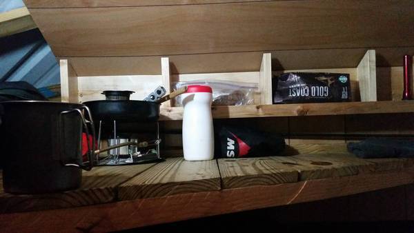

    Love this thread.
    Added cubbies to my camper.
    Breakfast last weekend with the Boy Scouts. 10 degrees that morning.
    Keep the build and photos coming.

    I can smell the wood mgord. Did you use cedar or pine?
    I placed the water fill inside mainly because I didn't want to try cutting a hole in the side of the camper and there wouldn't be any frame around it anyway, would've been through the Styrofoam, but the other advantage besides being tamper proof is I can see the tank level while filling it. I bought a Camco water tank filler with shutoff valve, a must for the inside filler and for the travel trailer no more scurrying back to the house faucet when the trailer tank over flows.

    I used mainly pressure treated but am converting to redwood. I tried cedar but the wood is to soft. The cubbies are out of sugar maple. I wanted to use pressure treated since I've had an RV that rotted with regular wood and didn't want to worry about rot. There is warping I had to take into consideration but all in all it worked out well. If I had to do it over with more money I would have used all redwood.
    Not going to run plumbing since this is more of a rustic camper.
    I take it out once a month with the Scouts and enjoy it immensely. Not sure if you have kids or such but join Boy Scouts if you have a boy and camp with them. They love it. Would get you out more often as well :)

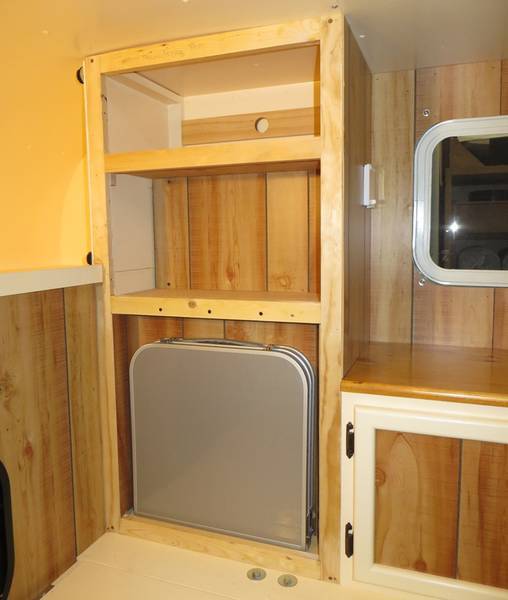

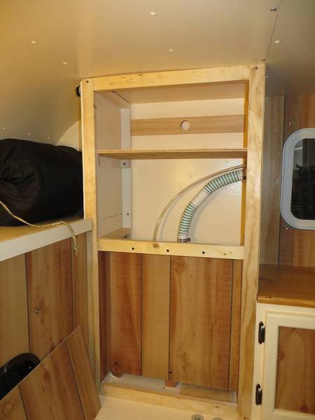

    Worked on the cabinets this weekend. Debating whether to make fancy doors or not.
    A place for the camp table.
