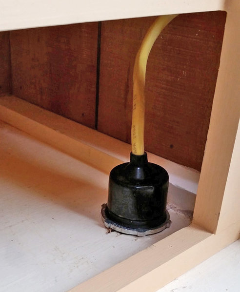

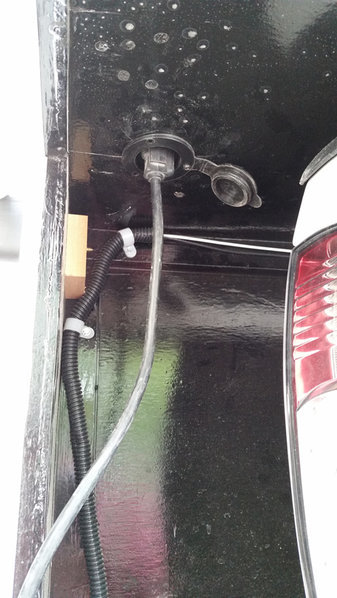

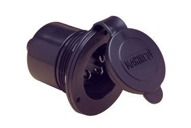

    Recently added an AC power inlet for a trip to Cannonville, UT. Temps were in the low 40's in the morning so it was nice to have an electric heater. Rained a lot on that trip but everything stayed dry.
    Marinco 150BBI Marine On-Board Charger Inlet
    GFCI Outlet
