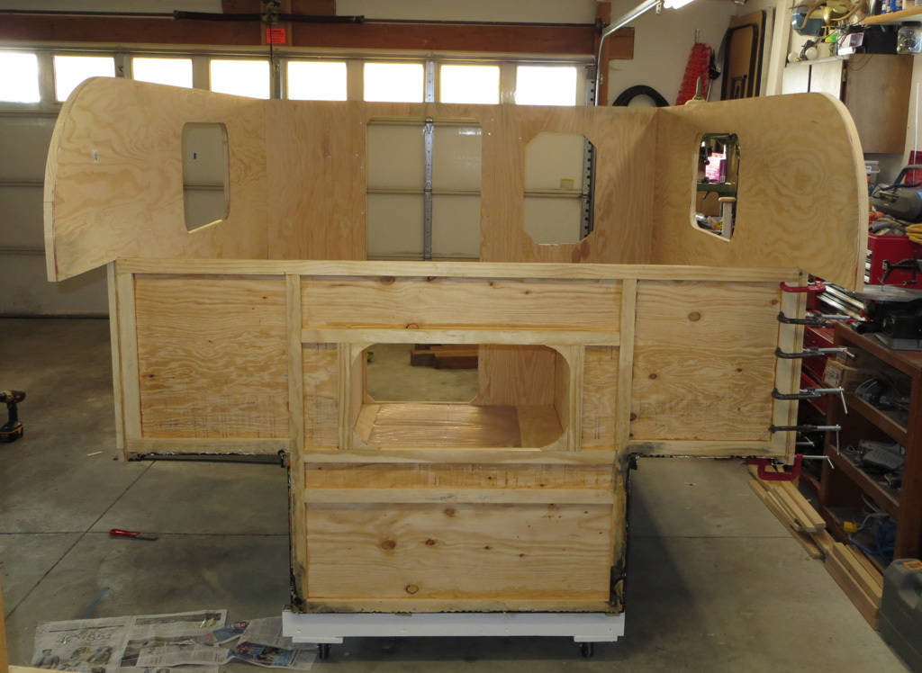

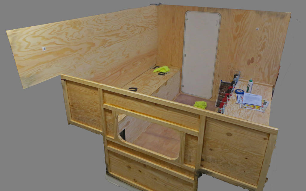

    It'll be a couple weeks before I get much more done. I'm waiting for more windows from eBay. For now here's where I'm at.

    What do you intend on using for jacks to lift the camper?

    Are you using just 1/4" plywood on this? I would love to build one of these, considering they are selling for $14k new now. Nice work OP

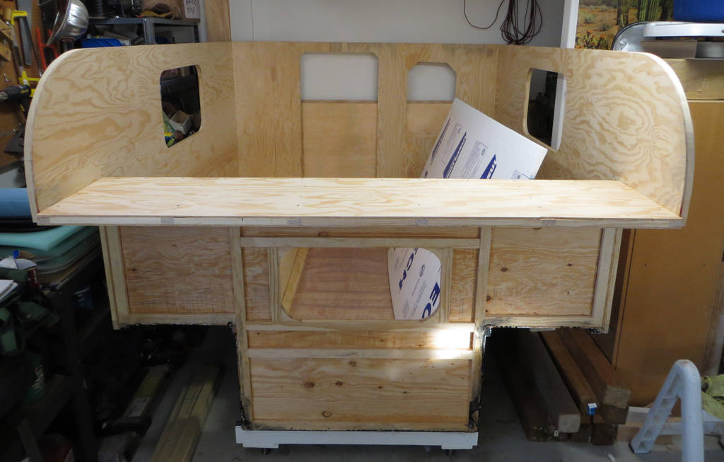

    One more piece in place. I get to try my hand at bending plywood this weekend. Weight so far 215 lbs.

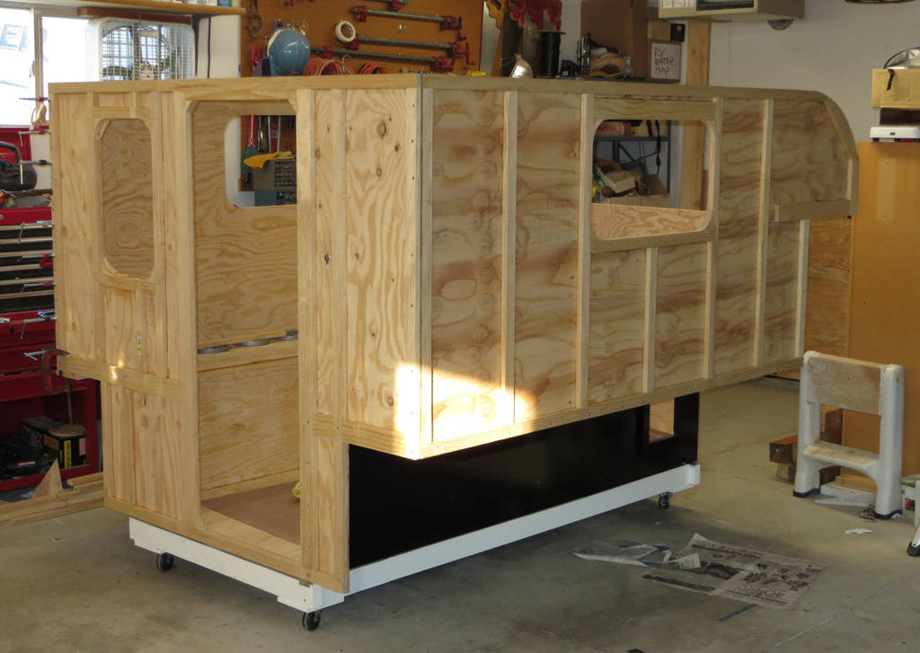

    Floor is 1/2", lower box and wings (benches) 3/8", front, rear and sides 1/4". The ceiling will be 3/16"

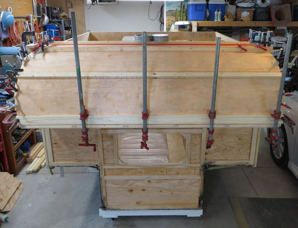

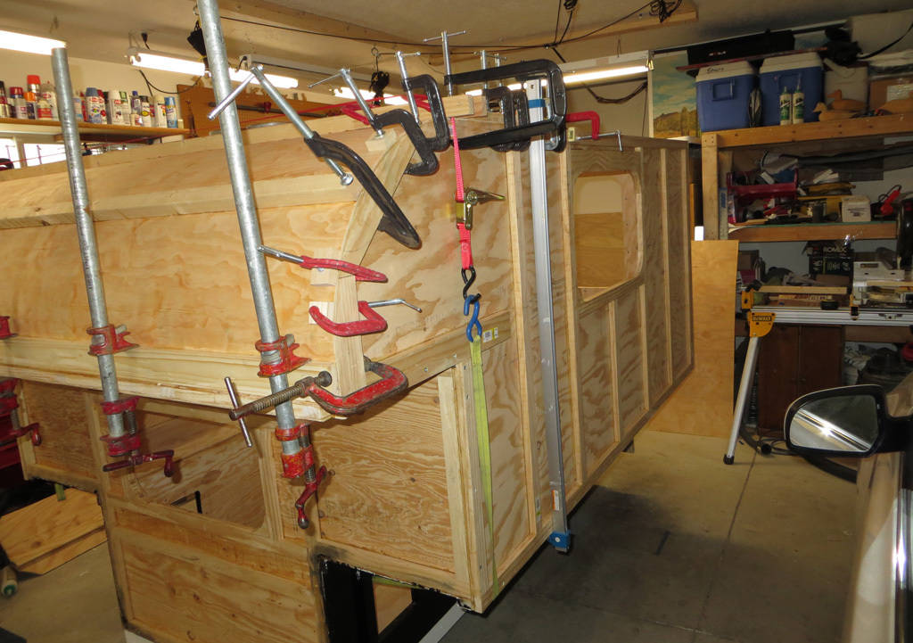

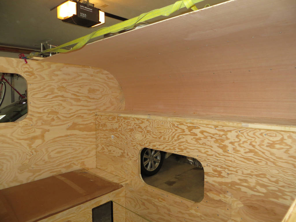

    Friday....assembled front ceiling panel. 2x2 rafters and 1x3 cleat for attaching to the front deck.[​IMG]
    Clamped the 1x3 onto the front deck and added deck screws from underneath then started cranking down the panel with a ratcheting tie-down.[​IMG]
    Then started adding clamps. I'll need to make curved frame pieces to secure the bent panel to the sides and support whatever roof panels added later.* Until I screw the top frame down this "wood spring" isn't secure. Glue won't keep this on.
    Used a cam-buckle tie-down to pull the sides into alignment.
