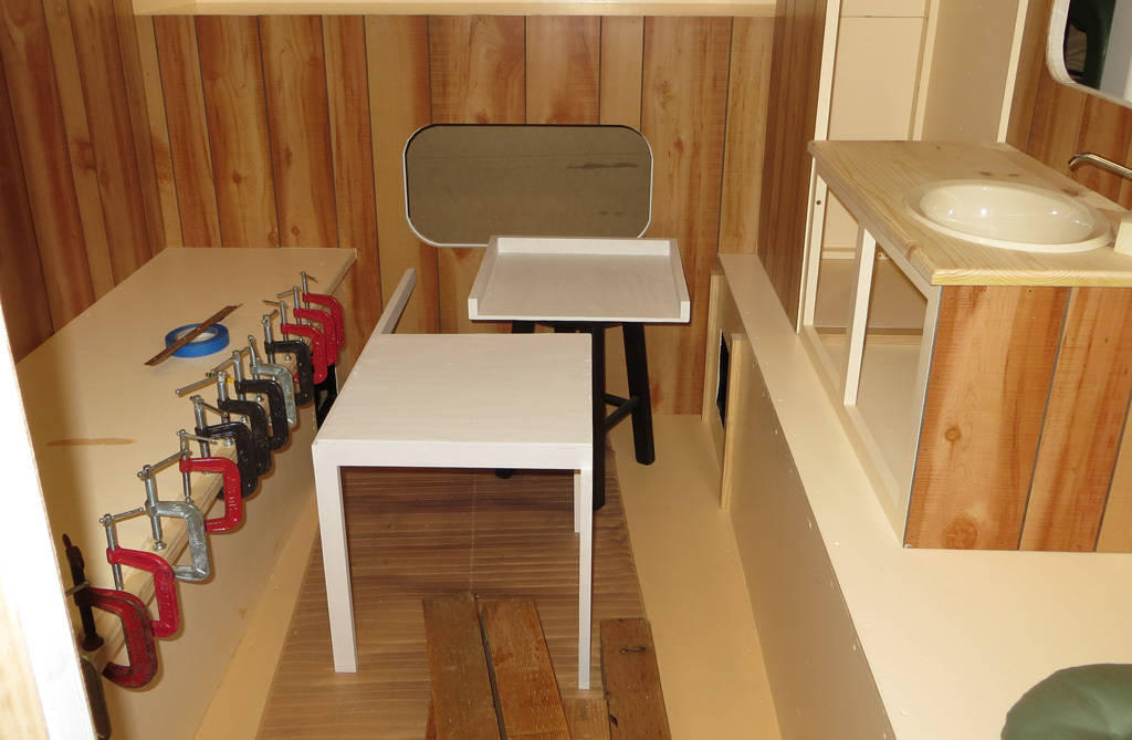

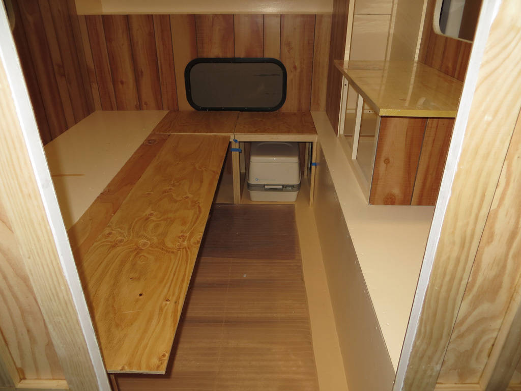

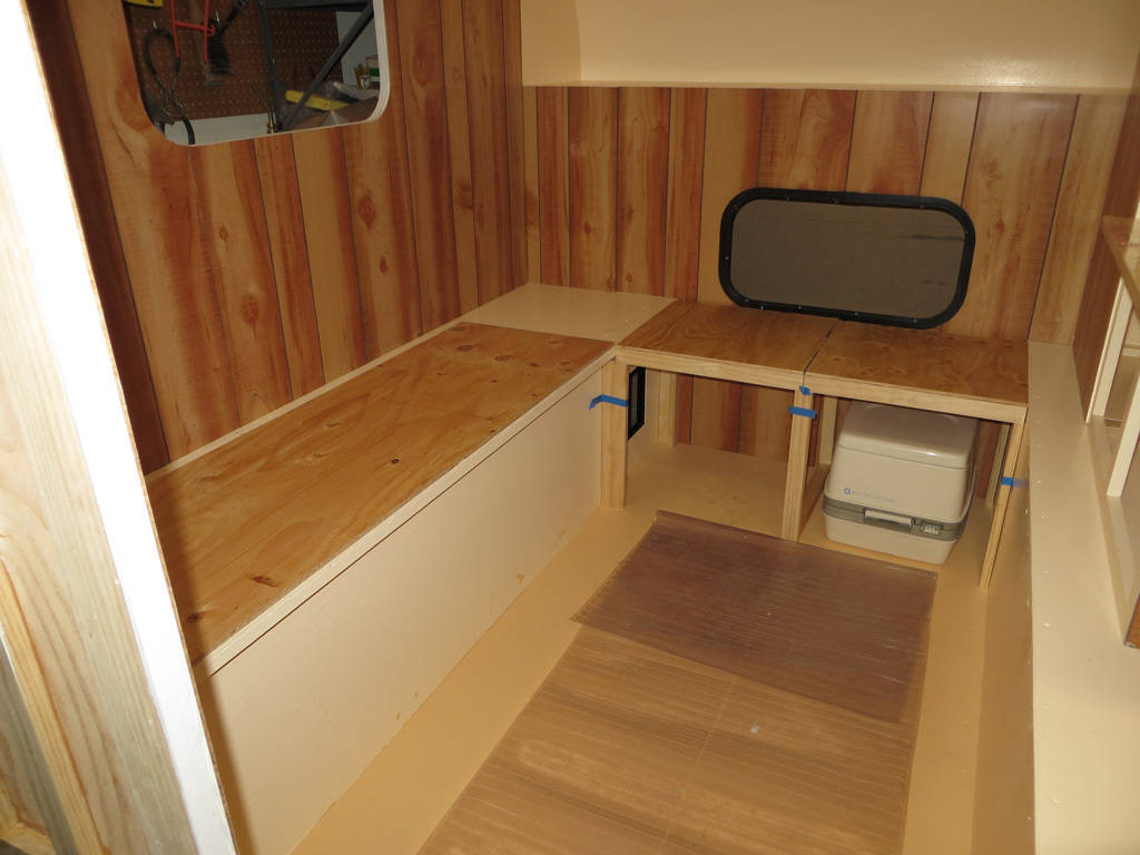

    Fitting in the pieces.
    Bed platform in open position. Commode lid, there will be a cabinet door on front.
    Open cabinet door, raise the lid up.
    Bed platform slides back for seating.
    Now I gotta figure out the computer workstation.
    This camper could be configured with a full queen bed, eliminate the cabinets, put a second bed slider on the other side and have the whole thing for the bed with the storage underneath. Think of all the fun you could have in there! :eek:

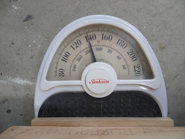

    Put a scale under the entry end of the camper, 138. I'll try the other end tonight, that's going to be heavier, the overhang would be counter balancing from the pivot point lightening this end.

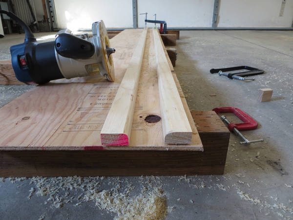

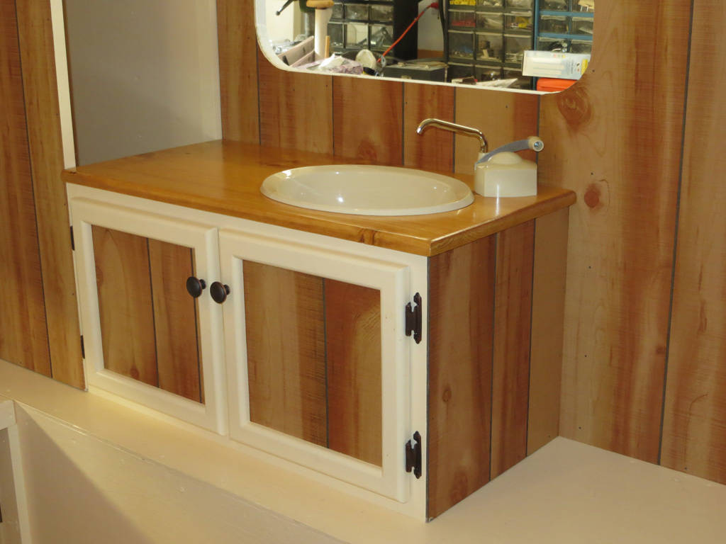

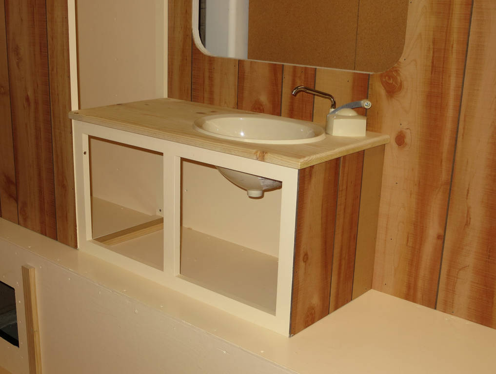

    Not much to show for the weekend. Finishing interior is time consuming. Cut the counter top. Assembled and first coat of paint on the rest of interior pieces.

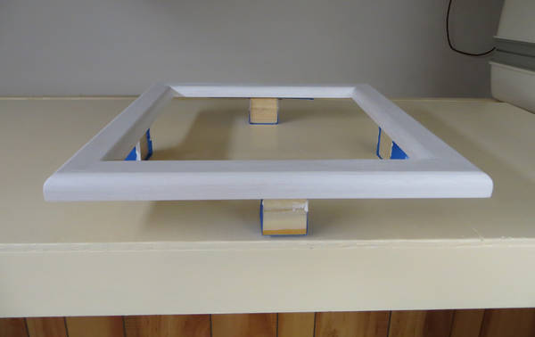

    Started making the cabinet doors.

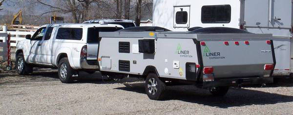

    I haven't installed the water system yet, but it will only be cold water, really just a jug of water hooked to the hand pump. May someday I'll find a small 2 gallon tank and put in a pump. The hand pump I bought is a 3-way. I'm building this mainly as a sleeper. The bed will be on the left opposite the sink and will convert to a bench seat. My wife and I don't sleep in the same room because I snore (tmi), we have a big 5th wheel with two sleeping compartments for long excursions. Last year my wife bought an Aliner with the idea that I could tow it with the Tacoma when she takes her horse to clinics, her towing the horse trailer with the Chevy. Last summer we made two trips and I bunked in back of the Tacoma, which led me to wanting better accommodations.
    Once I get this done I'll find a scale and get all the weights, truck - truck w/camper - truck/camper/trialer, see if I'm over loaded. The dry hitch weight of this trailer is 240lbs.
