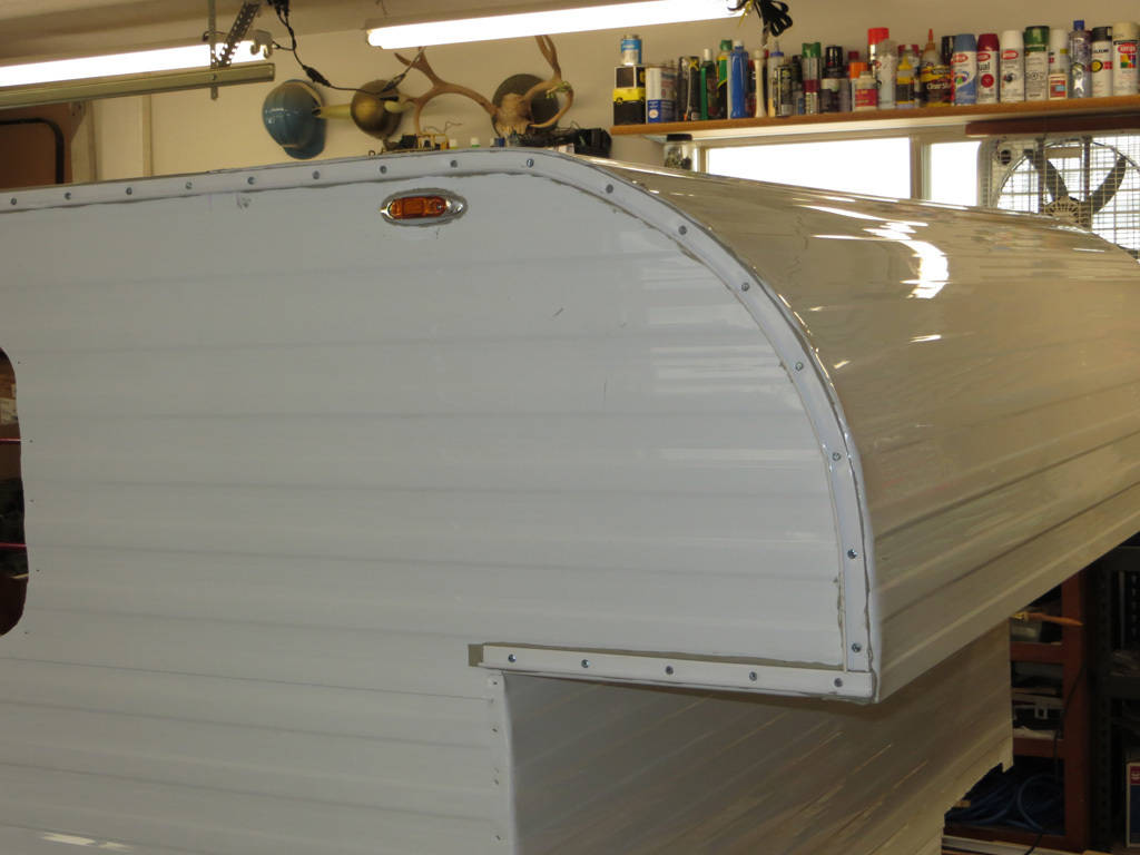

    Since you like more than one, how about a twosome (the cap, I mean) I'd buy from you. Good job, Sir. Good job. images_997613b7e415b2ca631d64e645974a7bc1c315c4.jpg

    Very nice job op. I'm sorry to see it finished. Now let's see it on truck:)

    Not done yet, gotta add the drip molding and corner molding, then windows, door, roof vent......

    Got some of the drip molding on this afternoon. Anybody got a suggestion on cleaning up the gummy caulk? It's like gum in your kids hair.

    Trim it with a razor blade and use wd40.

    Nearly done, still have to add sealant in places, finish wiring and install my mounts. Seems like the little details are endless. I've got some other jobs needing my attention so it'll be 2 weeks before I put this on the truck.
