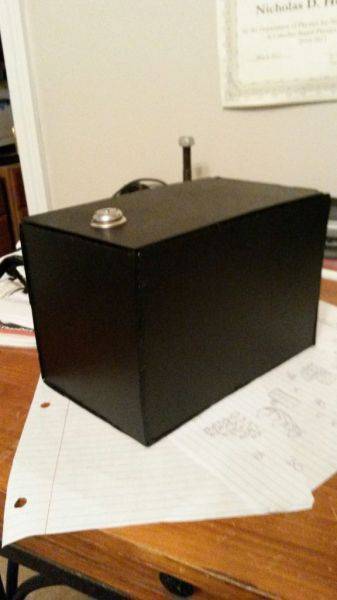

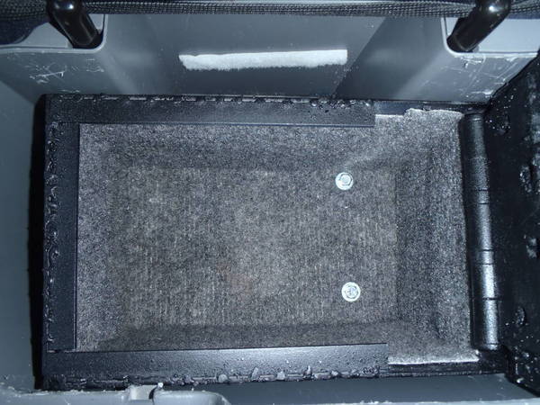

    Finished up my console vault today. I'm not the best welder and don't have the best equipment but I was able to make do and crank this out. Fits like a glove and serves its intended purpose! Thanks for the inspiration OP!

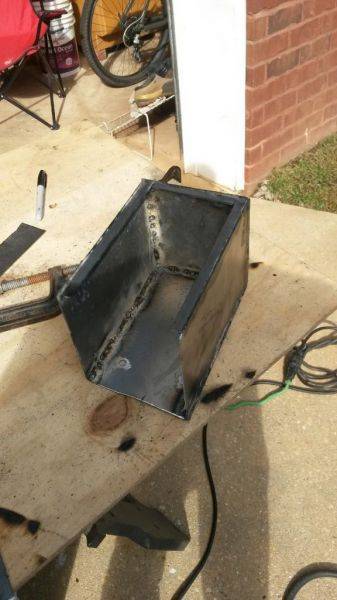

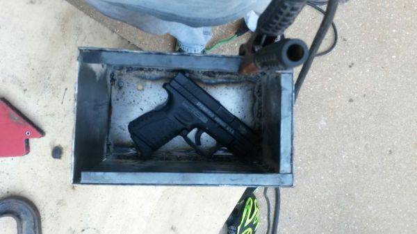

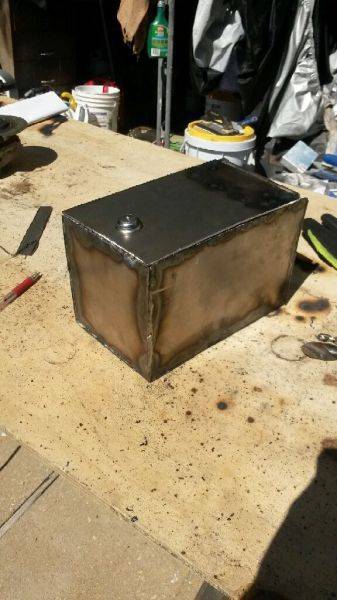

    Sorry cvillechopper but I totally stole this design and started my first ever welding project. I wanted to keep it under $100 as well so I have about $75 into it so far with metal and cutting/grinding wheels.
    So I got some of the welding done today. I am using my new Everlast inverter 160 STH running DC on 220 power. I started using some Lincoln 3/32 7018ac sticks and I was getting a lot of worm holes in my welds so I switched to some Lincoln 3/32 6013 rods and the welds got a little better.
    My 6013 bead:
    I figured that if I can grind down the welds and it looks like one peice of metal and still holds together after I try to hit it with a 3lbs hammer then it must be a good weld.
    So here it is coming together. I still have a little more to do but it is looking good.
