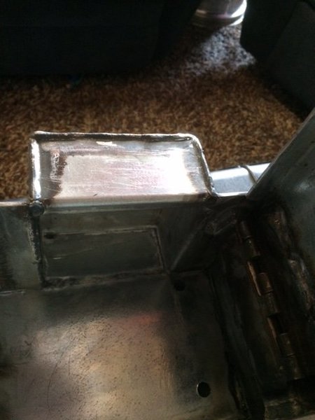

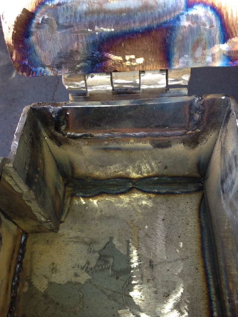

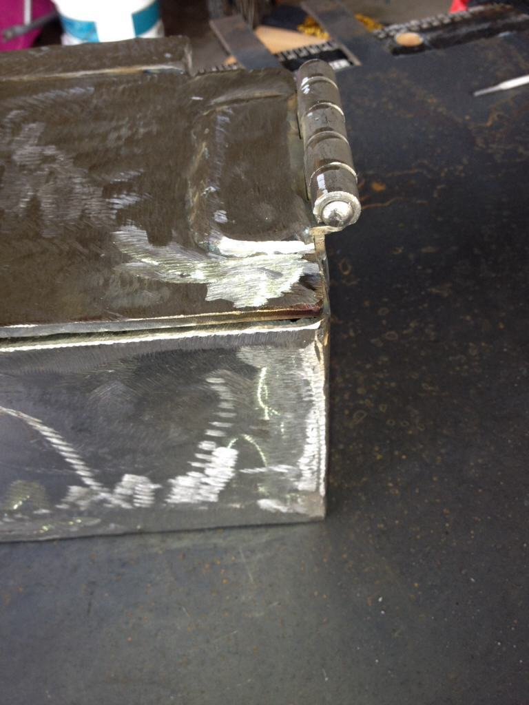

    Installed my hinge and now I will be installing a Hockey puck lock and hasp.vube4una_68b5a6d7964535c78c35302b807df413cf5aa18f.jpgbumunypa_332519270bfcccb54ee3434e2a03c5d712f79085.jpgema2e4en_d935b077eaad9331c680e1cea0d273344fcc63bd.jpg

    Glad you are making progress. Did you shorten the length of the box to account for the extra space your hinge is gonna take up? If you look at my design, I placed the hinge about 2 inches from the rear so the box could take up the entire compartment and so a couple of items could be left there and I could still open the top. If your box was built to the size of the compartment you may have issue with the extended hinge. Hopefully I'm wrong. Looks good either way. Definitely very sturdy.

    You should trim the hinge pin a little and weld up the ends of the hinge. Wouldn't take much to just punch the pin out and remove the top.
