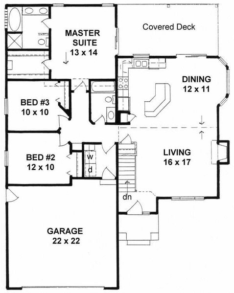

    Question for anyone knowledgeable on the bc building code (read Oz-T)
    The building inspector is saying the bay window in my plan has to be moved 1.2 meters away front eh corner. This kinda bungs up the layout of the house. We haven't found anything that says this... Thoughts?
  6. Aug 8, 2012 at 9:08 AM
    #226
    OZ-T
    OZ-T I hate my neighbour
    Dec 15, 2009
    #27584
    50,586
    Peter North
    British Columbia
    Sounds like they are calling you on the minimum distance for lateral restraint under the BCBC
    Without an engineer , the code requires a minimum of 4' of wall in each corner to provide lateral ( seismic ) restraint .
    This distance can be reduced or eliminated but you need to get an engineer's stamp on it
  7. Aug 8, 2012 at 9:09 AM
    #227
    Tacomada
    Tacomada [OP] Well-Known Member
    Nov 5, 2010
    #45742
    345
    TBC - Canadiana
    2010 TRD Off Road
    Ok. Thanks!
    So all these homes with windows in the corners have had that engineered? Or is it specifically the bay window that is causing an issue?
    I guess I will have to find an engineer.

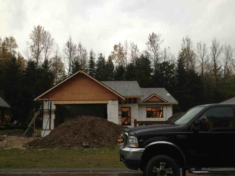

    Been a while since I've posted anything in here. Latest update.

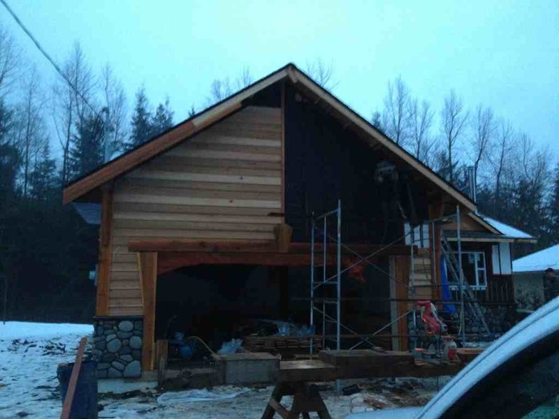

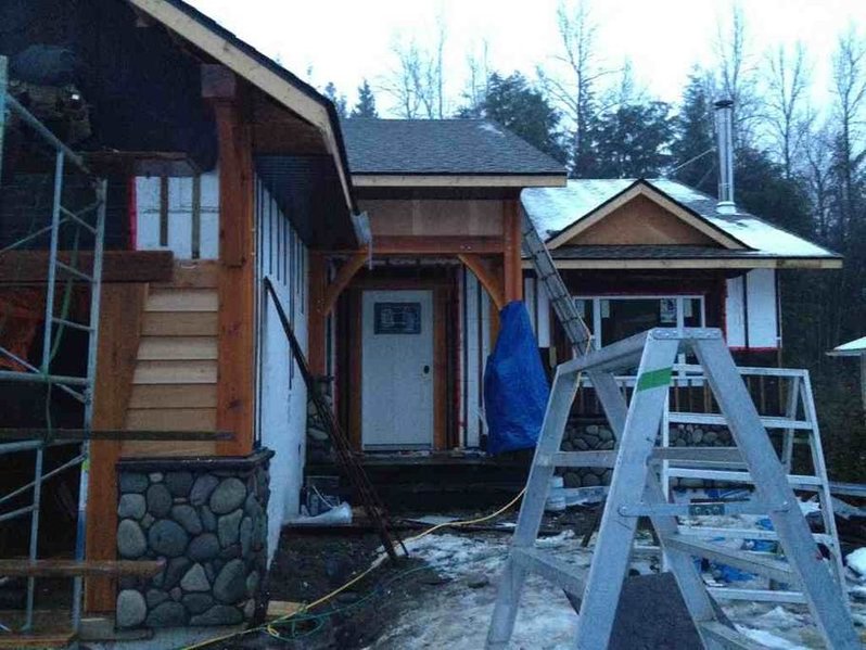

  17. Jan 31, 2013 at 6:12 PM
    #237
    OZ-T
    Dec 15, 2009
    #27584
    50,586
    Peter North
    British Columbia
    Loving the timbers

  19. Feb 1, 2013 at 1:24 AM
    #239
    Tacomada
    Nov 5, 2010
    #45742
    345
    TBC - Canadiana
    2010 TRD Off Road
    Ya. They look great. By the end it'll look timber frame and no one will know its all made of concrete.
