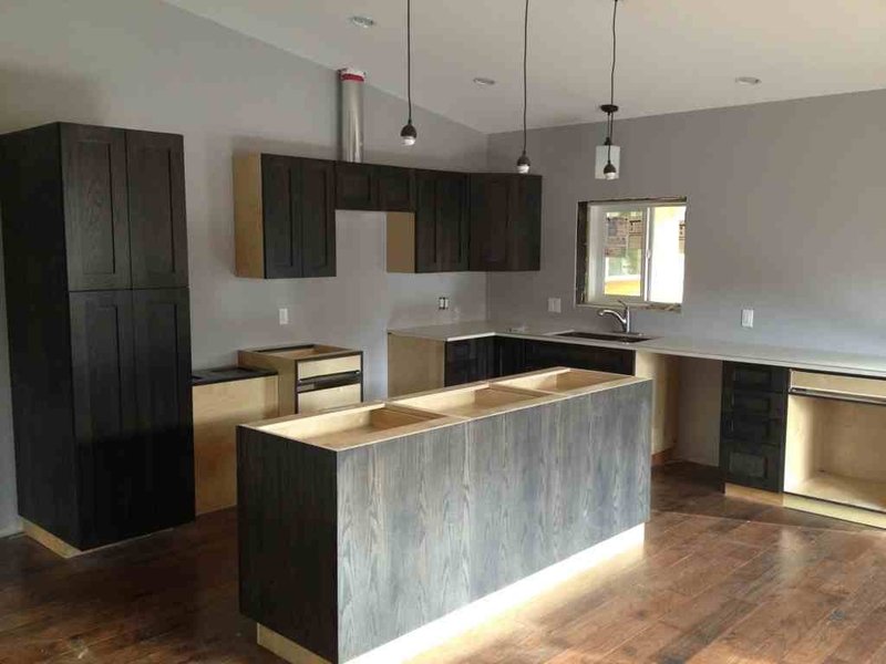

    Any knowledge of undercabinet lights?
    We want to hardwire them in. And recess jn the cabinet. Plan I have a double bottom shelf since we weren't keen on a balance below the cabinet.
    Hard to find any you can hardwire. Led all seem to be plug in.

    Most are low voltage that I have used , they are hard wired but you need a seperate tranformer somewhere accessable

    The houses I used to work in we left a spot on top of the cabinets for the transformer.

    Yep , it can go there as long as there is crown to hide it

    Yeah. May try and hide the transformer in the cabinet.

    Could always make a box to cover the transformer in the cabinet out of 1/4" in a corner.

    That's a nice layout, what are you doing for countertops?

    You could hide the transformer in the vent hood cabinet.
