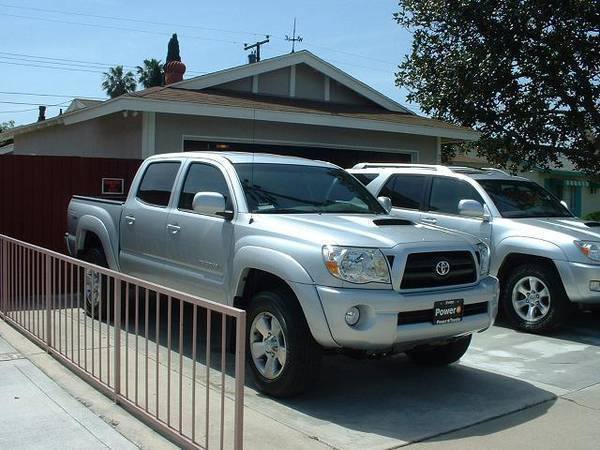

    This was the morning after I brought the truck home from Power Toyota in Irvine. It's an '05 Tacoma 4x4 sport double cab TRD edition. Thats my wifes '04 4Runner I bought for her brithday just 6 months prior. It's the sport model also with the 4.7 V8.

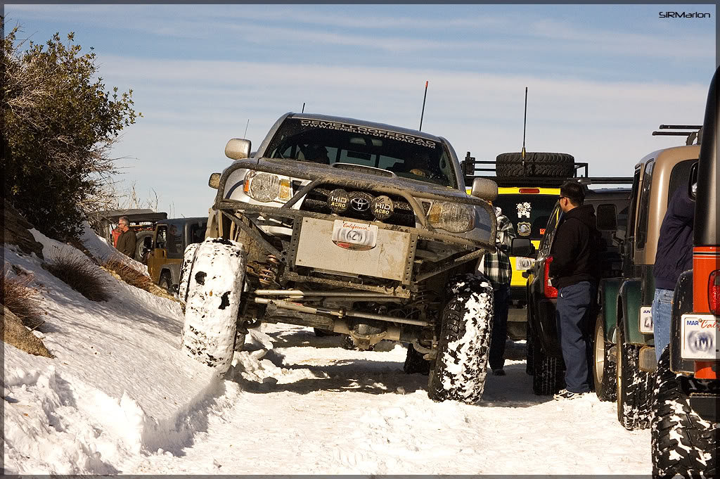

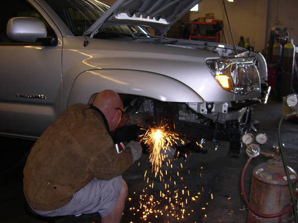

    I then put 3,000 miles on it to get the first oil change out of the way and we then brought it into the shop. This is the picture that was on the front cover of the premire issue of 4wd toyota owner magazine.

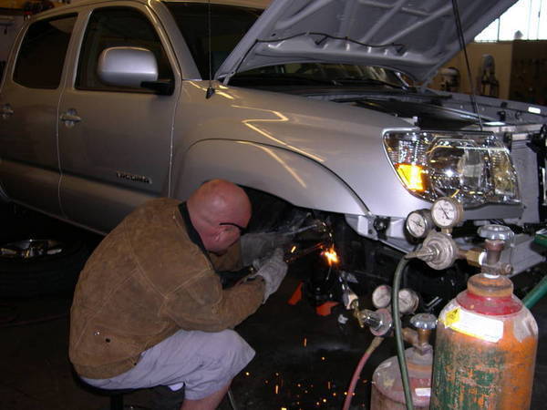

    For those of you that don't know him, thats my buisness partener, Jason DeMello. He sure did look happy holding that torch:(

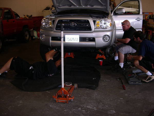

    But first we had to take a bunch of stuff off before the torch could be used.
    Thats me on the jack and Jason on the seat.
    The guy kneeling by Jason is the editor and owner of 4wd toyota owner magazine, David Zartman.

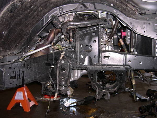

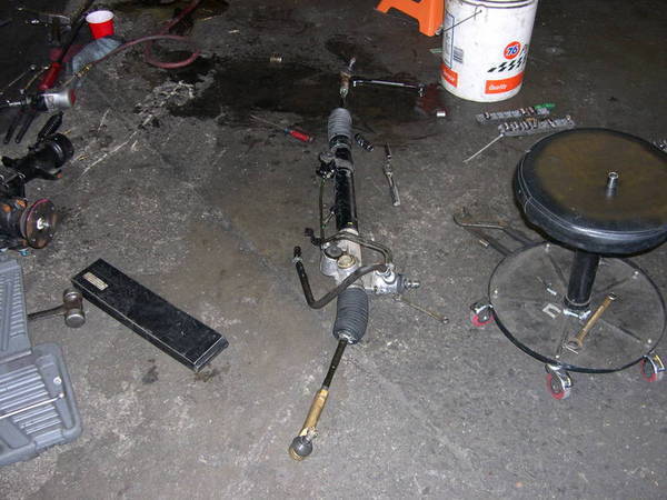

    Got alot of the front suspension of now and pulling the front diff and stuff out.

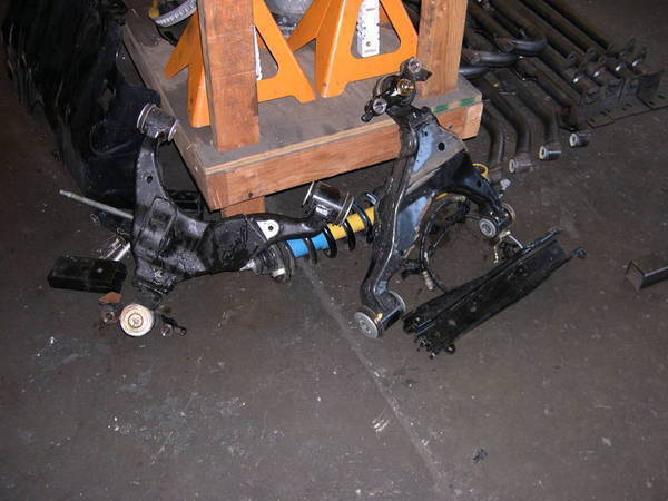

    Here are some expensive, barely used parts just waiting for a new home. Sorry folks, they are all sold now.

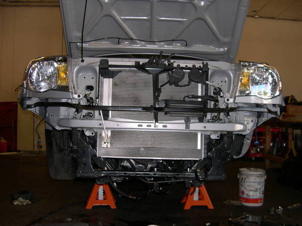

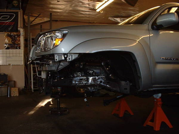

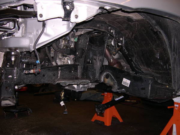

    A brand new truck ready for the torch. It was nice to work on a clean truck though.
    And the cutting begins. There was no turning back now:eek:
    Getting close to grinder time. I hated that part:mad:

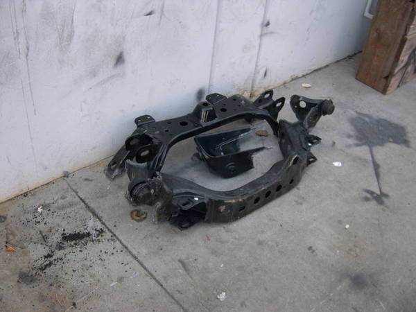

    Disgarded parts that are only good for srap now.

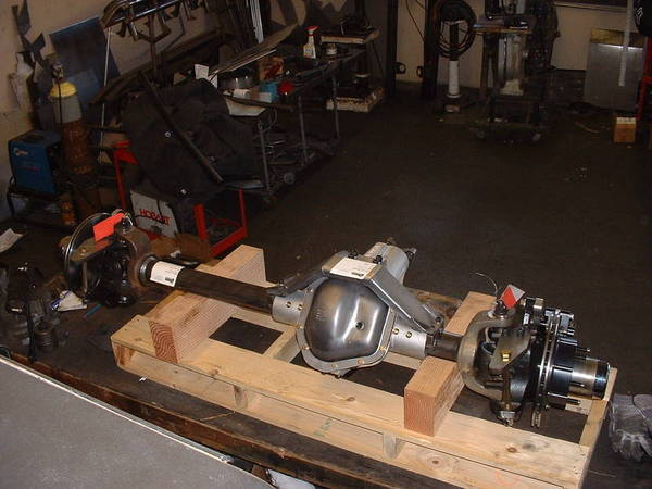

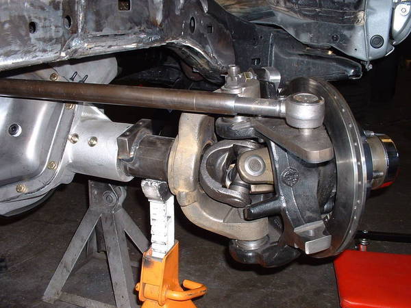

    And here is the jewel that will relace all that IFS stuff. It's a Currie rock jock 60 that is high pinion with reverse cut 5.38 gears, an ARB locker, 35 spline axle's Ford F-450 knuckles, Wilwood 4 piston disc brakes, and Warn premium hubs.
    Stay tuned for more.:D

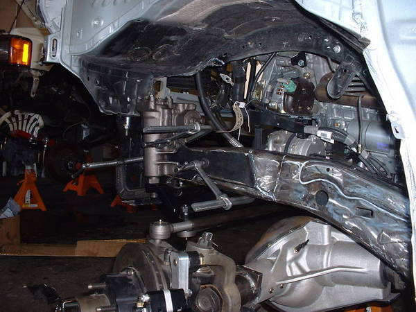

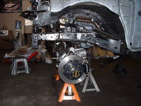

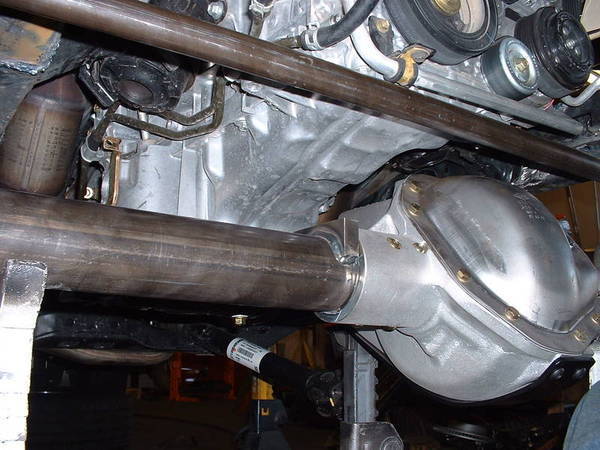

    After we ground down the frame we set the axle under the truck to see how it fit.

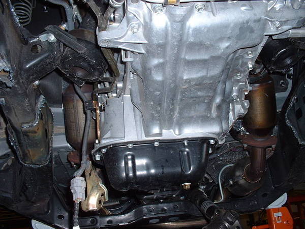

    We noticed a couple of things right away. The swaps on the '05 and later 4.0 trucks would be easier than the older Taco's. Heres why. The oil pan is already set back so you don't have to change the oil pan. The steering shaft doesn't come down straight like the older taco's so you don't have to change that angle either, and the frame kicks up about an inch and a half higher than the older Taco's not to mention that they are bigger in the front. This just cut down the amount of fabrication needed to do to do a swap on these trucks.

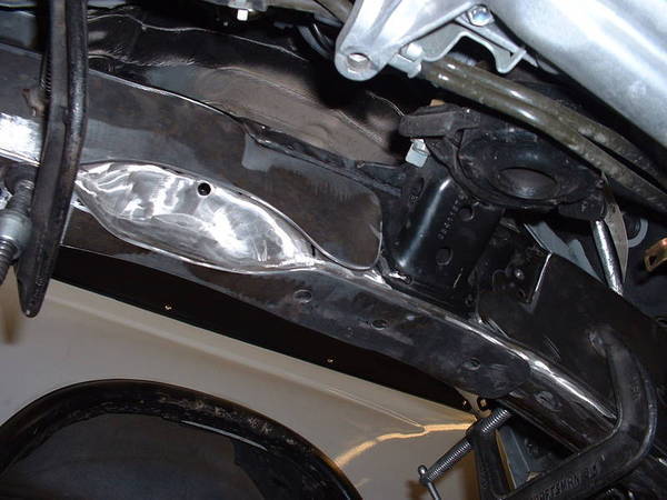

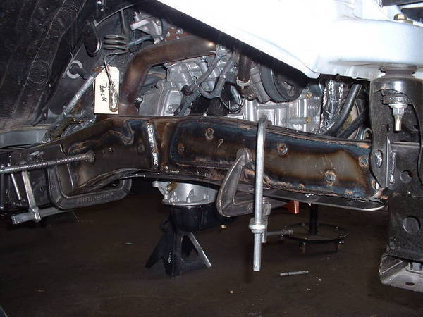

    Now we started plating the frame. We plated both the front and back of the frame as well as the top and bottom. Now we don't think that this is needed to do the top and bottom but we did't want any problems and felt it was cheap insurance.
    The two plates at the front of the frame on the drivers side were made to incoporate the mounting for the new steering box. We used an early model IFS power steering box from a Toyota truck. These are what are normally used on these swaps.
    This picture is here just to show you how big the axles and knuckles are on a Dana 60. :eek:
