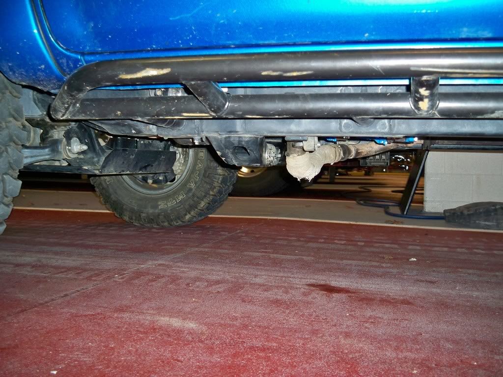

    driveshafts will require mods. the front shaft has to be lengthned and the rear shortened. as far as the floorboard, mine required slight massaging to make everything clear although i am running a inchworm lefty which is clocked up slightly. if you just ran a marling box everything very well may clear, just not sure. one difference is that i am currently working on a new crossmember for mine, which when done will give me a totally flat underside. with the exception on the front suspension, nothing will hang below the frame rails once i'm done.

    here you can see what it looks like now. the crossmember and exhaust will be redone thus leaving everything tucked up inside the frame.

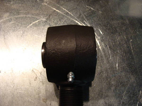

    But, I have decided to change my lower link rod ends at the axle. I have heim joints and although they are very strong and have served me well, they can be loud at times and are not servicable at all.
    So I've been looking for a joint that will be as strong as the heim joint yet is servicable.
    I have Johny Joints at the frame end but they are not big enough for my axle's so I needed to find something else. I needed a joint that had a 1.25" shank and a 5/8" hole for the through bolt.
    I briefly looked at these only to find out that they are not built very well. The quality is really lacking and the excution of the design is even worse. I won't name the company who builds them on an open forum but if your looking for a rod end I'd stay away from these.
    In this photo you can see that the ball that rotates inside the housing is not even centered in the housing. Poor build exection.

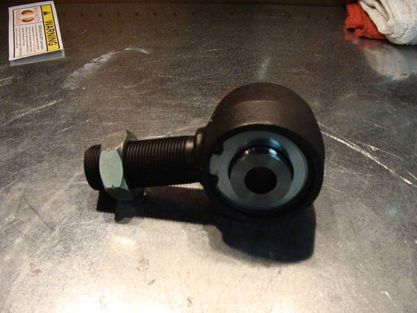

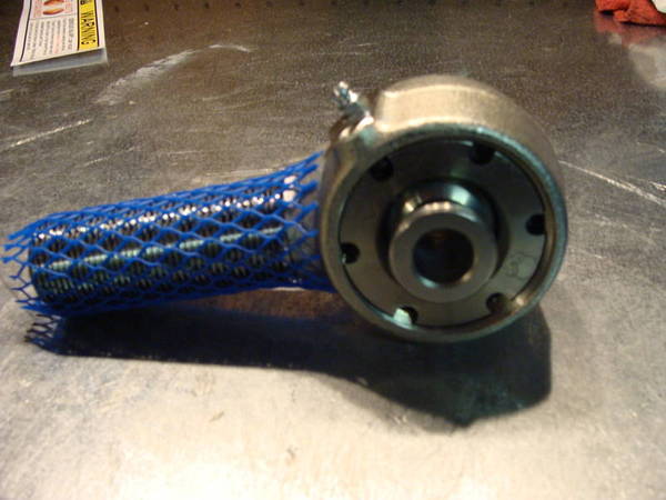

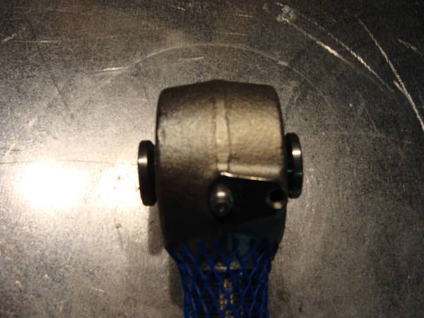

    I then ran across Ballistic Fabs new joints. They are forged chromolly units that are rebuildable and sem to be of high quality. They cost about the same as the other joints and are the size I need.
    If you are looking for a joint that is bigger than a johny joint then you can't go wrong with these. I'll put them to the test and will let you know how they do in the real world. But after seeing some of the projects that have come out of Ballistic Fabs house, I think they will do just fine.
