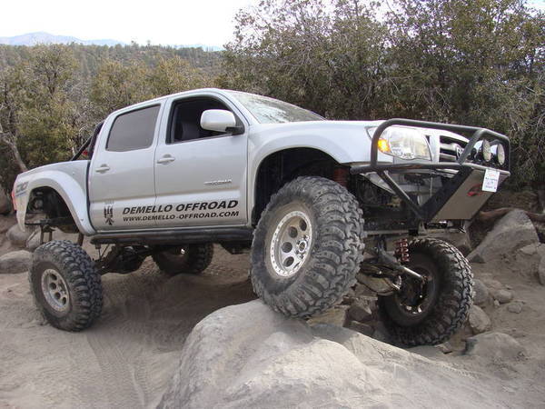

    I have a secret for you. If you look at my sig pic it'll give you a glimps of how it turns out........;)

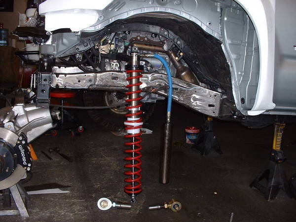

    These are the shocks we used. They are Bilstein 9100 14" coilover shocks with remote reseviors. They are using Eibach dual rate springs. The joints are FK 1 1/4" hiem joints and Johny joints. All the bolts used in this build are either grade 8 or the super strong F-911 bolts. We didn't want anything to brake on this build.

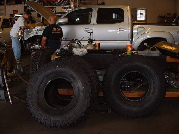

    The first set of tires we put on this truck were 40x17x13.50 Goodyear MTR Rock Spiders.

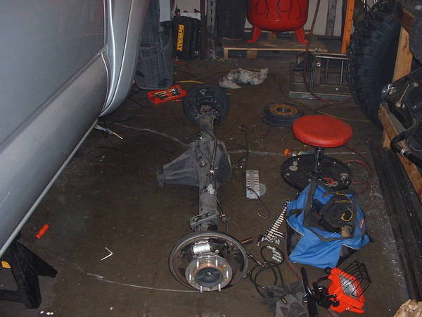

    We then took the rear Toyota axle out and decided to go with something bigger.

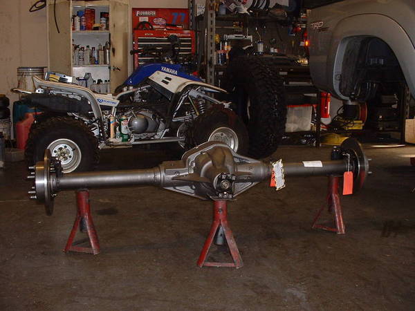

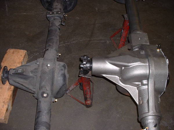

    We went with a Currie Heavy duty high pinion Dana 60 with 5.38 reverse cut gears, an ARB air locker, 35 spline axleshafts, Wilwood 4 piston disc brakes and we had it shaved for more grond clearence.

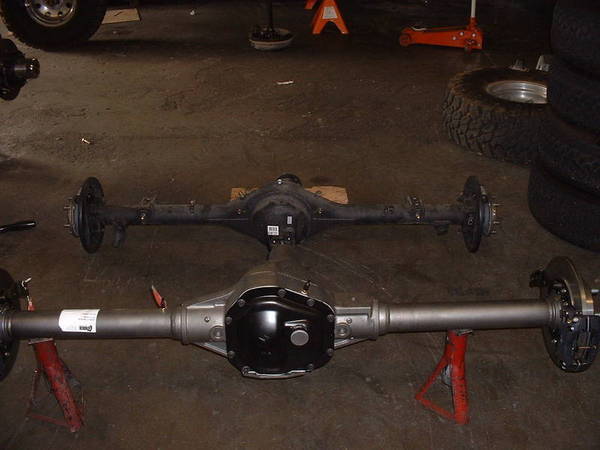

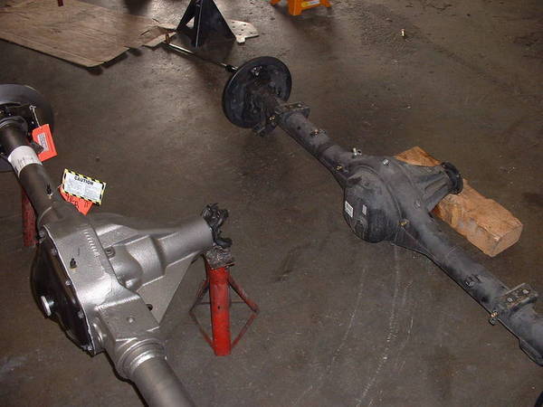

    This picture gives you an idea of how much bigger the Dana 60 is over the Toyota axle. Having it shaved gave me more ground clearence than I had with the toy axle.

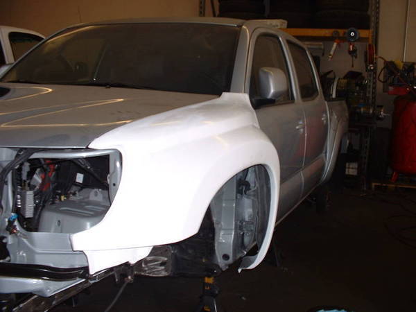

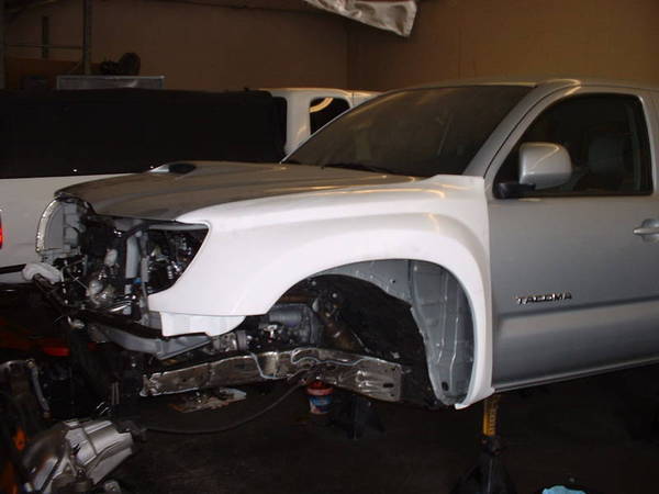

    During the time we were grinding the frame the Glassworks fiberglass fenders came in and we put them on to check fitment and to see how much trimming needed to be done. I was surprised to find that they fit very well and needed very little triming.
    I was very pleased at how well they fit.
