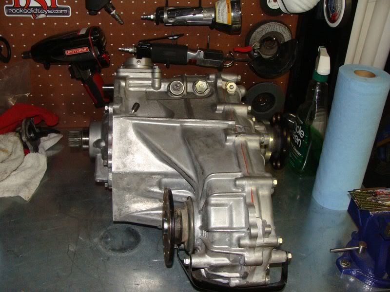

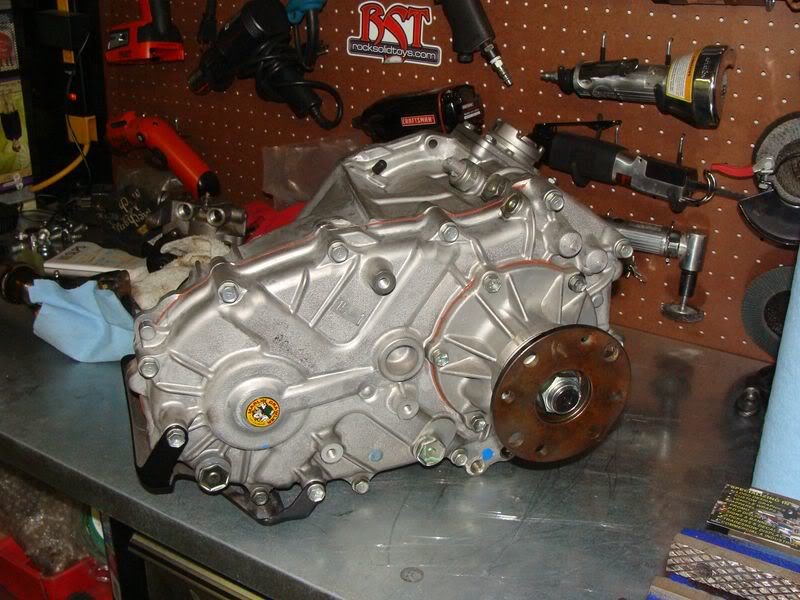

    They are very similar. They are both chain case's and have the same gearing and even use the same case The difference is in how they are shifted. The Taco case use's an electronic actuator and a single rod to shift it into 4-hi and 4-lo. Thus the weak points are both the actuator and the fact that a single rod is shifting both hi and lo gear sets.
    With the FJ Cruiser case it is shifted manually with a lever by the driver and it has two shift rods to control 4 hi and 4-lo. No electronics to worry about getting dirty or wet and no need to worry about the case getting bound up between 4-hi and 4-lo.
    Here is the Tacoma Case when we pulled it out to put the first crawler in it. Notice that there is a cover plate on the top of the case. That is where a shift lever would go if this was an FJ case. Also notice the big actuator at the back of the case. This is what shifts the case.

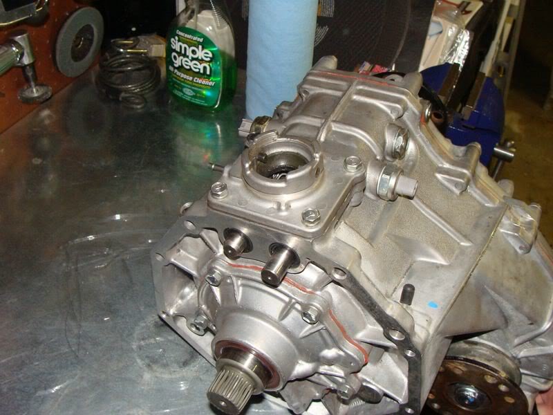

    Here is the FJ case. Notice that it has a shifter base and no actuator at the back.
    Also notice that on the face of the Taco case there are two small recessed area's next t each other. This is where the shift rods would be if it had them.
    Now notice that the FJ Cruiser has these same holes however you can see the shift rods at the top.
