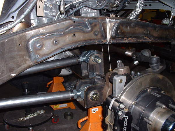

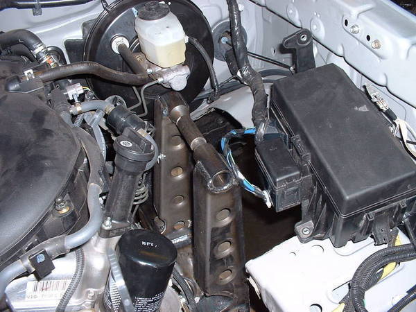

    Update.

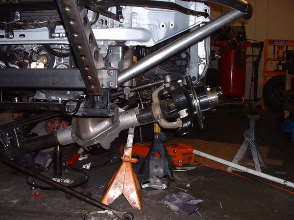

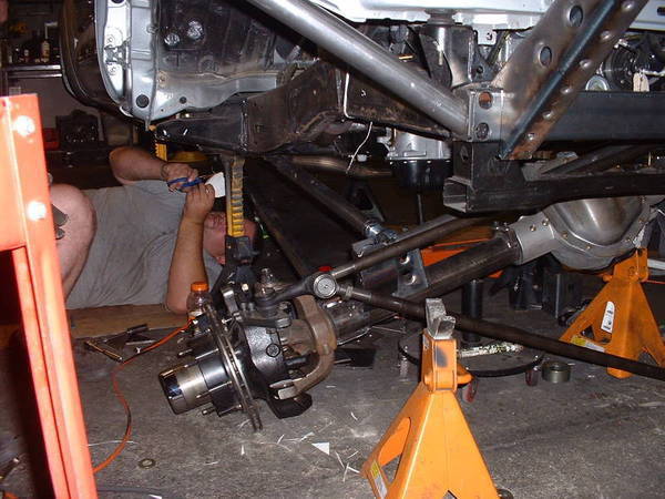

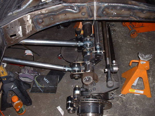

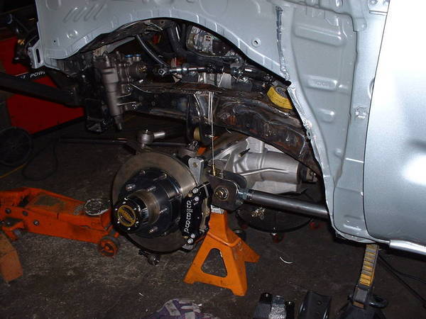

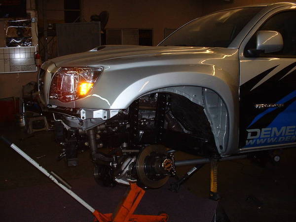

    We started mounting the links to the front axle. It wasn't really that hard because we spent about 20 hrs. on the computer figuring out where they would go, how long they would be and what effect any changes would have on anti squat, dive etc.
    This is the lower link on the passenger side. It has already been attatched to the frame further back. The lower links locate the axle front to back while the top link controls the axle from rotating on itself.
    This is the top link on the passener side.
    We put the top link on the passenger side unlike others who put it on the drivers side. We did this because of room, the fact that now you can use any axle without modification, and it tracks really well.

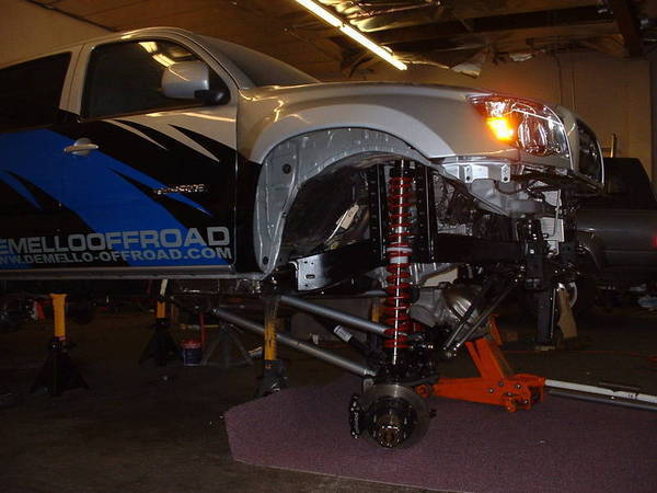

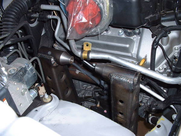

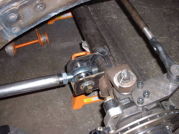

    This is the lower link on the drivers side.
    In this picture, you can see the top and lower link and also the panhard bar that keeps the axle from moving from side to side.

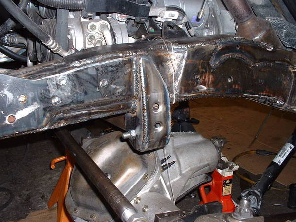

    This was the first panhard bar frame mount we made. We have since changed it.

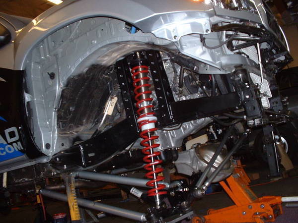

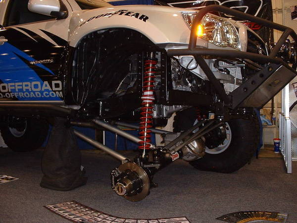

    We then cycled the axle to make sure there wasn't any binding before we made the shock mounts.

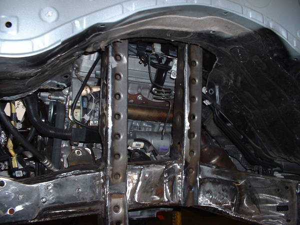

    Then came time to make the shock mounts. Jason wanted something different. I don't really like them but they are strong as hell. I will change them at some point. You can see just how far into the engine bay we had to come.

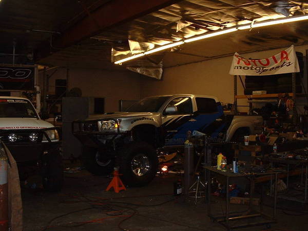

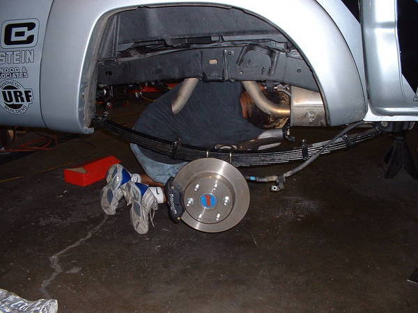

    We also mounted up the rear axle. This was a temporay mount as we had to get it ready for the Off Road Expo.
    This was the night before the expo. I finally went home at 4:30am to get a little sleep before the show. We mounted both axles, wheels and tires and did the graphics all in the night before the expo.

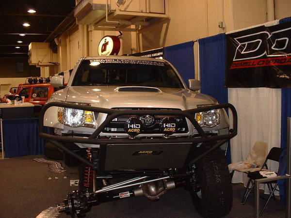

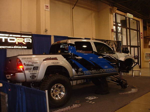

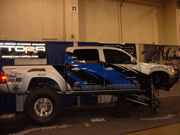

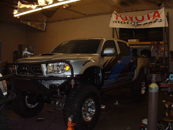

    On it's wheels again, after four months of work it's just three hours away from going to the Off Road Expo in Pomona, California.
    It is far from beeing done though. It has no driveshafts, no brakes, the rear axle is not mounted correctly, and the bed is not completed yet. But it rolls!

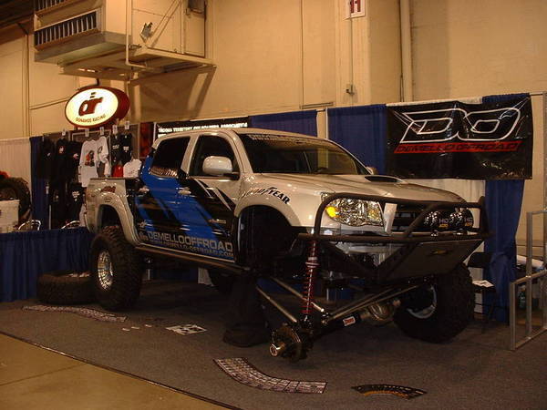

    Finally in it's place at the 2005 Off Road Expo!
    While setting it up in the booth, we put the Acro HID lights onto the front bumper.
    Stay tuned for more. This thing is nowhere near being finished!
