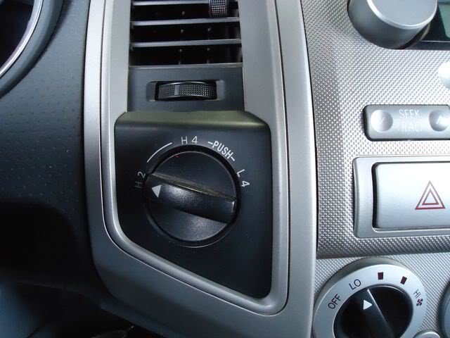

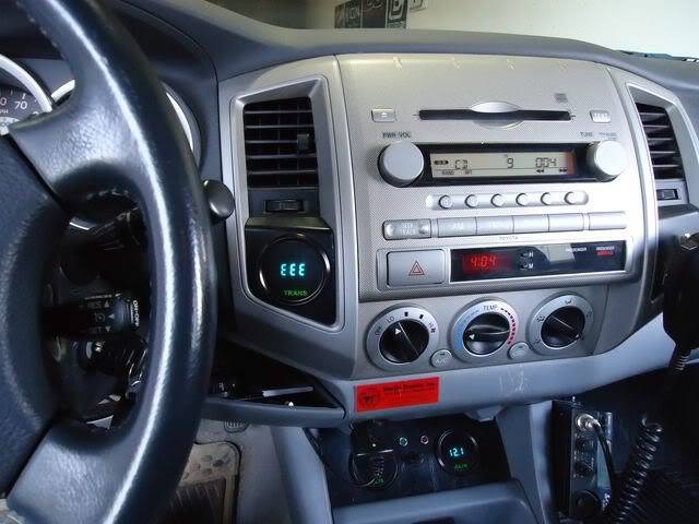

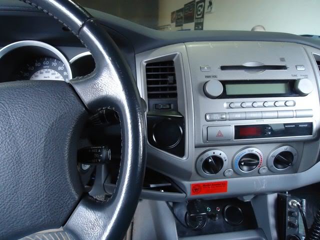

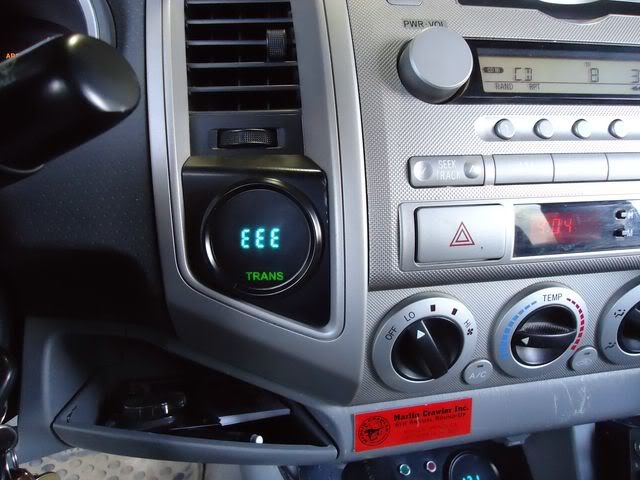

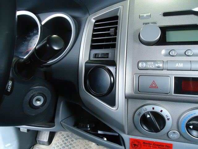

    So, I got the gauge installed in the truck this past weekend but I still need to get it tapped into the trans lines but here is how it will look when it's all finished.
    I placed it where the 4wd switch used to be. Perfect place for it.
    Got a blank plate from a prerunner and drilled the hole for the gauge and placed it in there once it was wired up.
    Then i wired it to the truck making sure I got it into the trucks light dimming circuit so that when I turn on the lights the gauge will dim so it wont blind me at night.
    Works perfect. I'm trying to get it all hooked up into the tranny lines before AZ Rocks but we'll see what happens.

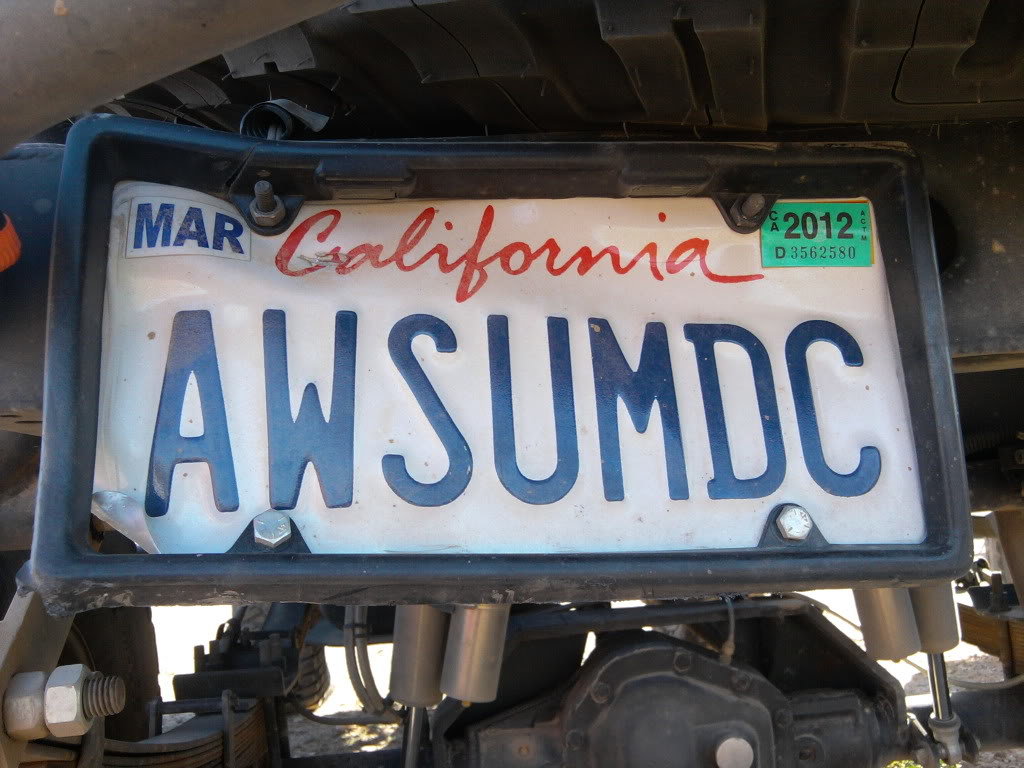

    From this past weekend at AZ Rocks...
  17. Apr 4, 2011 at 3:43 PM
    #677
    Fire931
    Fire931 Well-Known Member Vendor
    Jan 18, 2009
    #12687
    3,237
    VA
    00 4Runner
    And the license plate I messed up.. :D
