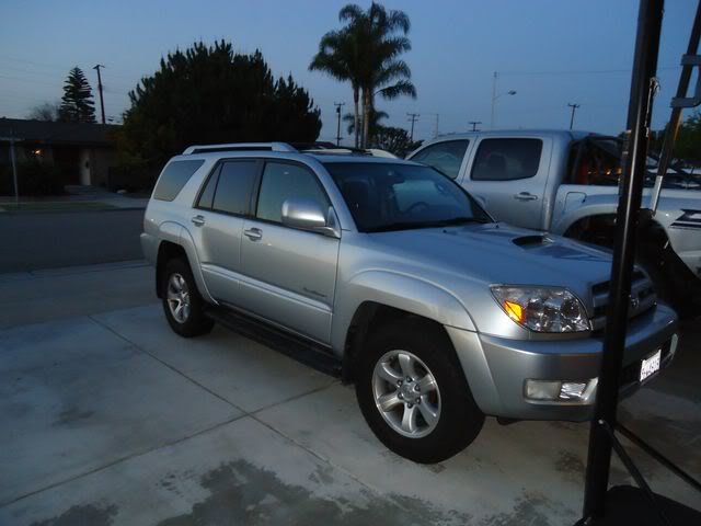

    Here is a picture of it next to my next project. A 2wd 2004 4Runner sport edition with the 4.7 V8. Finally got m wife to let me have it after I buy here a new Infinity G37. The price we pay for fun. :D

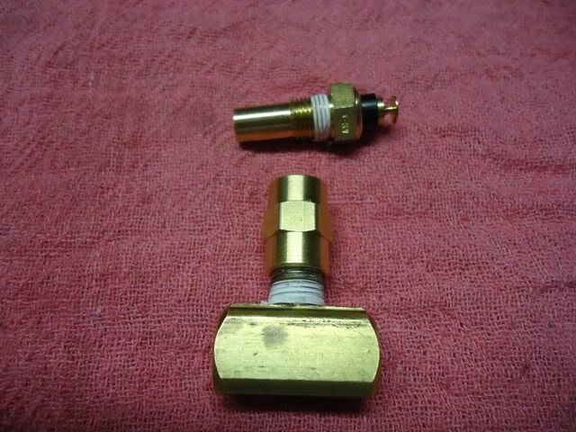

    Ok. Finally got the trans temp gauge working. That was fun.
    The first problem I had was I couldn't find a tee that was big enough to hold the sensor without it blocking fluid flow. I went every where and searched the internet for weeks to try and find something to no avail.
    Here is what I had.

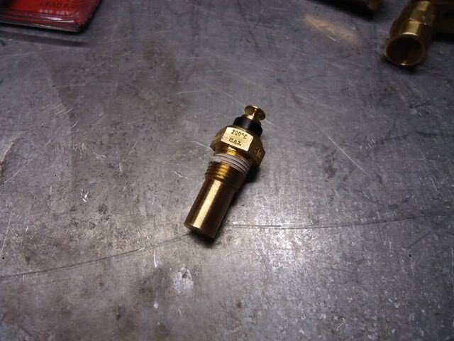

    This is the sending unit I got with the gauge. It's a VDO unit and is supposed to go into the case of the transmission but since I haven't torn into one yet I didn't want to drill into and hit something vital so I wanted to put it in the out line of the transmission going into the radiator. Simple enough right? We'll see.

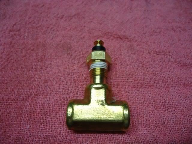

    So this is what I ad at first but as you can see the tee is too small for the sending unit.
    After I tried that for awhile, i went to a different tee with a bushing but the bushing was still too small and the sender would just bottom out on the tee.

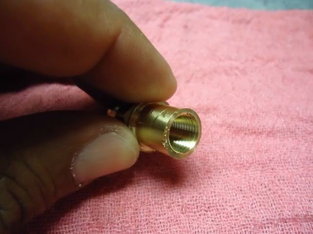

    So I searched and searched for a longer bushing but no one made one. I looked for over a week but no go.

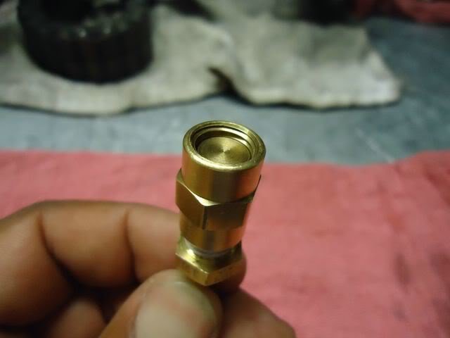

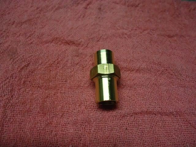

    So I made my own. I found a male threaded union that I milled down and then tapped it with an 1/8" npt and it works like a charm.

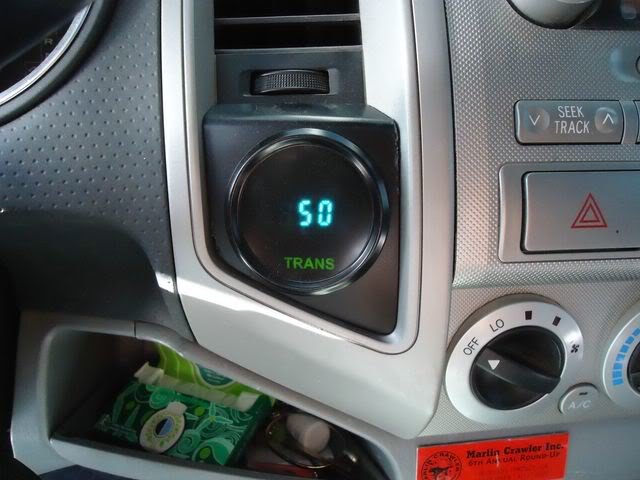

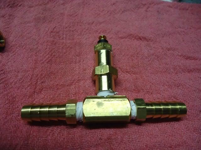

    Then I put it in line and set all my parameters on the gauge, turned the key and it wouldn't work.
    Found out that the sending unit is grounded through the threads of the sending unit so I took a wire and soildered it to the bushing I made and then grounded it to the body of the truck and now it works.
    Whew!!! Got it done so now I can see just how hot my tranny is getting. Some times ignorance is bliss I'm sure.[​IMG]
