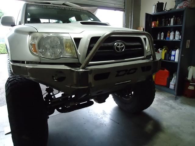

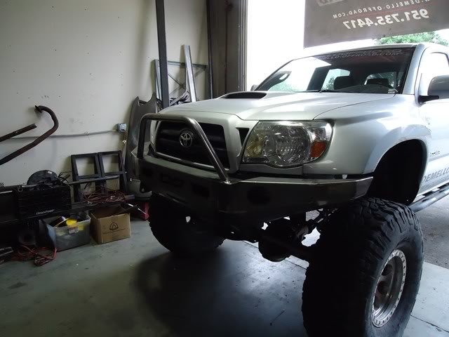

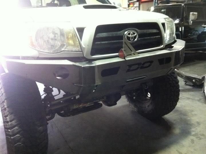

    The Beast gets a new face lift.
    Jason had some free time at the shop and wanted to get a plate bumper fabbed up for these Taco's with the wider fenders. Looking good.

    Have you considered relocating the cross member below the radiator (move it up a few inches?) How is your approach angle?

    #766
    Fire931
    Fire931 Well-Known Member Vendor
    Jan 18, 2009
    #12687
    3,237
    VA
    00 4Runner
    That wouldn't really gain him anything because it's so tall....

    BigRedToy
    BigRedToy ¯\_(ツ)_/¯
    Apr 12, 2009
    #15885
    2,269
    John
    Colorado
    07 Regular Cab SR5 4x4
    Yea, you are right. I have seen it relocated before. I would like to see a side profile of the front, once its done.

    awsumdc
    awsumdc [OP] Well-Known Member
    Jan 3, 2009
    #12156
    1,674
    O.C. Cali
    SASED '05 Taco
    SAS, crawler box, 14" coilover shocks, 39.5 tires,dual batteries, and a bunch of other stuff

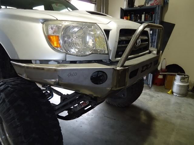

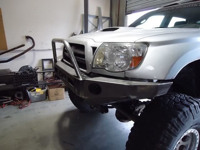

    New front bumper is nearly complete. Just a couple more hoops and some poweder coating and it's ready for the trails. Well.... at least the bumper will be. This is a 2nd gen DeMello plate bumper for the taco's that has been stretched a few inches on either side to make for the larger front fenders.

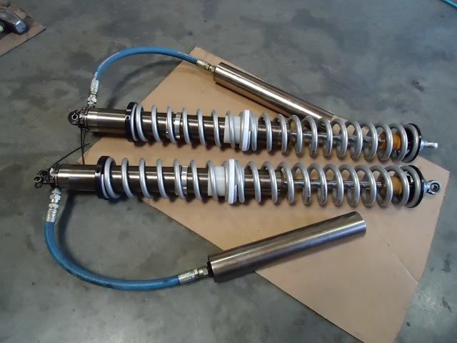

    Jan 3, 2009
    #12156
    1,674
    O.C. Cali
    SASED '05 Taco
    OK, last saturday, Dan and I went to the shop and pulled the fuel tank and the rear springs and shocks. Picked up the new bodies for the rear coil overs and they will be taken to a shop to have the internals from the rear shocks swapped over to the new coil over bodies.
    When we pulled the rear springs off we discovered that one of the springs was broken. Don't know when that happened but it kinda makes the spring useless. Good thing I'm changing that. I'll get a picture of where it broke later this week.
    Next weekend, we break pout the torch and start cutting off the old hangers and start making room for the new mounts. We'll also box the frame where the mounts will be which is why we removed the fuel tank.
