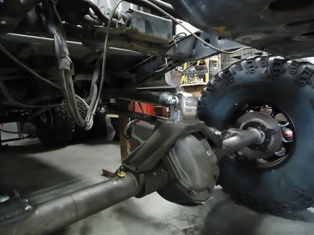

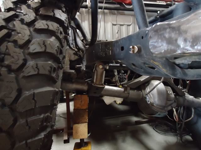

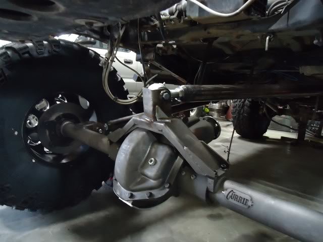

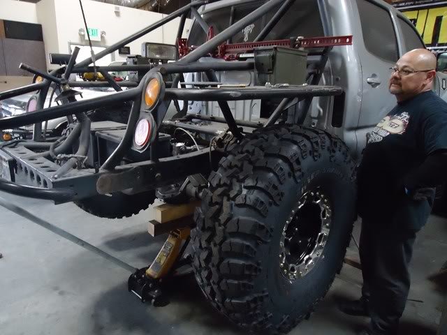

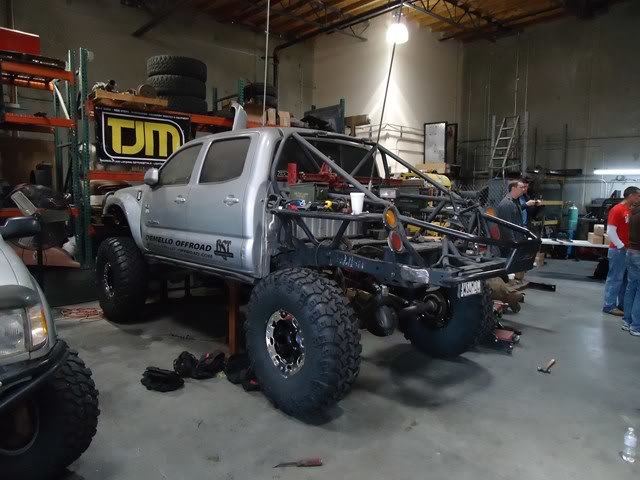

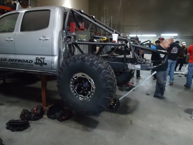

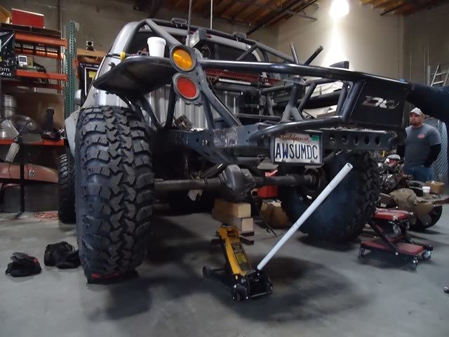

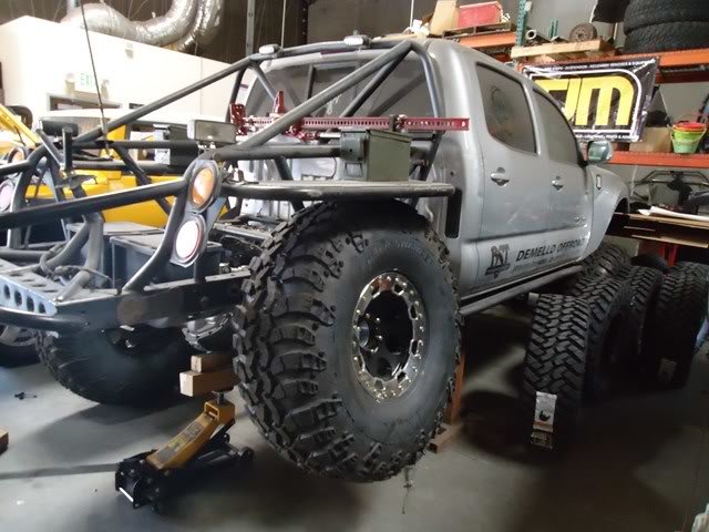

    Dan and I got into the shop today to do some work.
    We got the links in and quickly found out that we are going to have to do some more cutting and fabbing. The top link is hitting a cross member before the tires are at full bump.
    We want the tires to be 1 inch below the inner fenders but as you can see they are from from that here.
    Then we are going to have to cut and notch the frame here as well to clear the coilovers.
    The truck setting on the rear tires close to it's ride height.

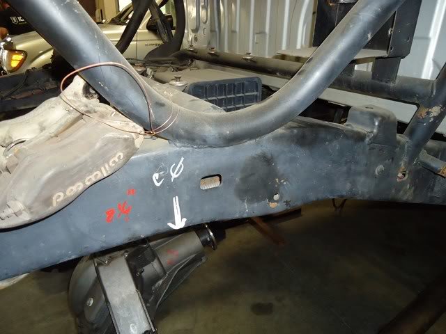

    OK. Got back into the shop after a few months of dealing with a broken ankle. Here is an up date of where we are now. Gonna have to do a lot of cutting on the frame but thats why they call fabrication.:D
    http://www.rocksolidtoys.com/forum/showpost.php?p=6655&postcount=279
    Stay tuned for more as we get to cuttin' and get the coilovers in.:p

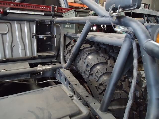

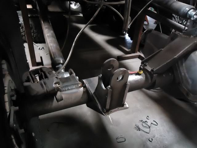

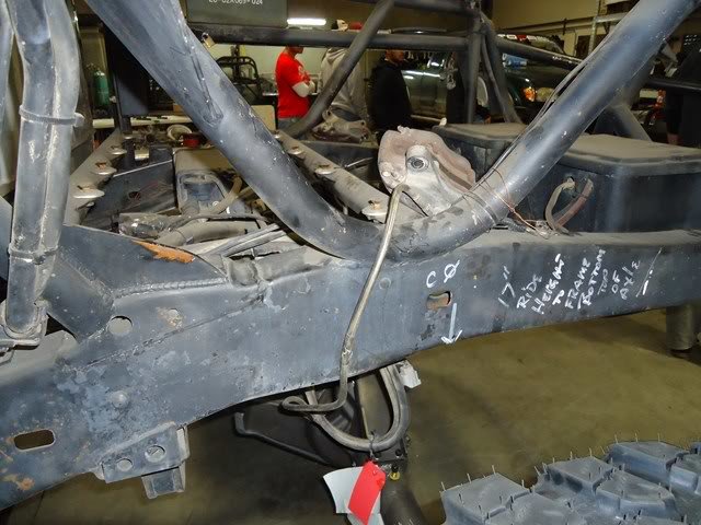

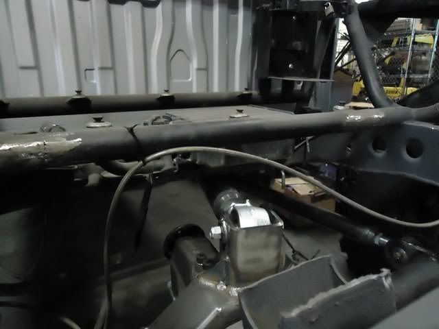

    Yes.

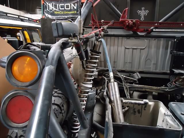

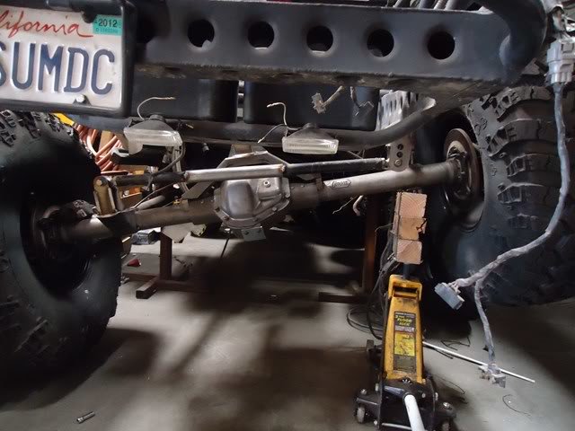

    This is the trial pan hard bar used to determine how long the actual one will be.
    This shows where we had to cut and section the frame to get the coilovers in.
    This is going to be about where the coilovers will go.
