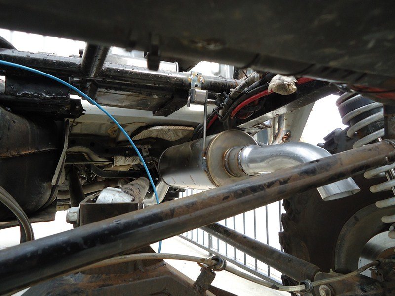

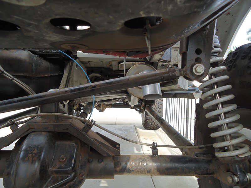

    So when I did the three link in the rear we had to cut off the exhaust which was good because I didn't like the one on there.
    I went and got a maganaflow round muffler from Summit racing and had it put on.
    It's a straight through design and I thought it was going to be loud and rude sounding but it is quiter than the one before and provides a nice throaty sound to the truck. No more sounding like a truck on it's last legs.
    I had to take it under the top link and over the lower link like Crozhawk did to clear everything but it works great.
    It dumps out just above and behind the rear axle where it should be.
    Now i'm going to wrap it with some heat shield and finish up the wiring to make it all nice and tidy and hit the trails next weekend.
