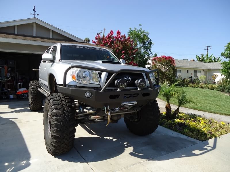

    I did go up to 41" irons but the truck is actually sitting an inch lower now than it was before. With the three link in the rear now I have a huge range of adjustability with the coil overs front and rear. Love it.

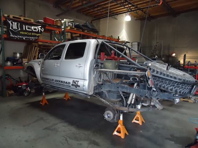

    Pictures for those of us who are just too damn lazy to click on a link button......like me.:p

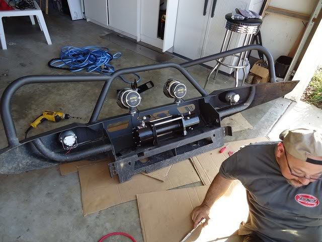

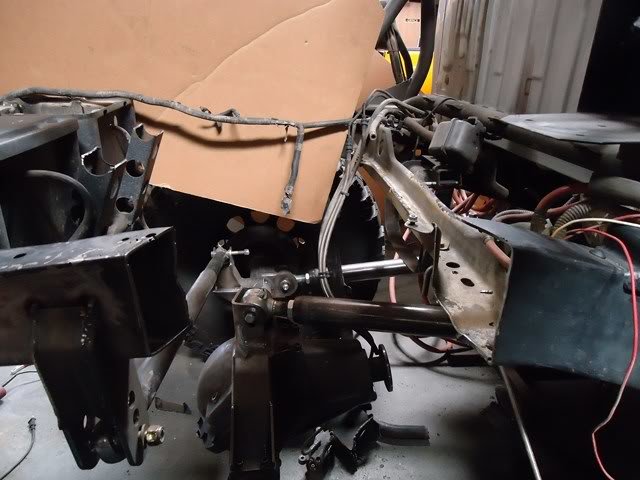

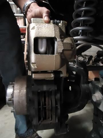

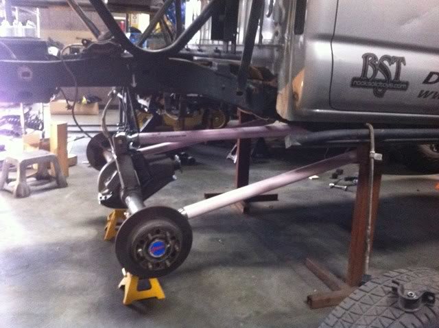

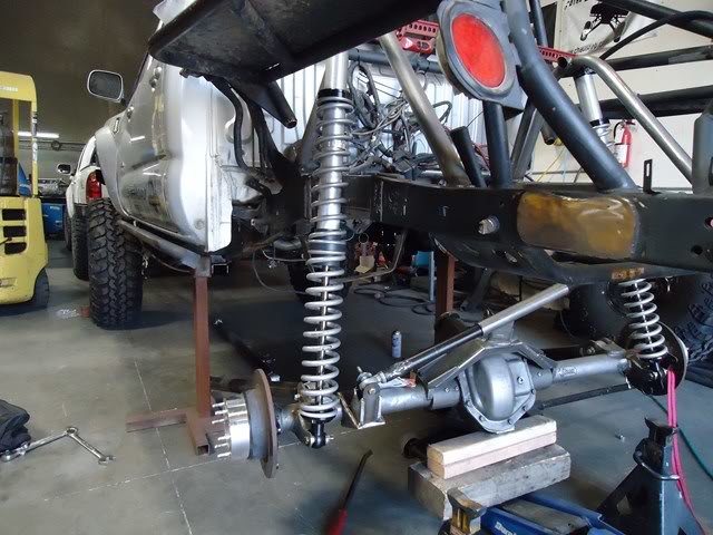

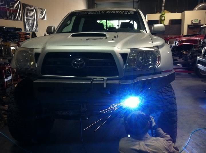

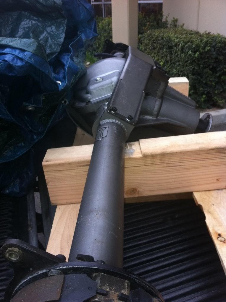

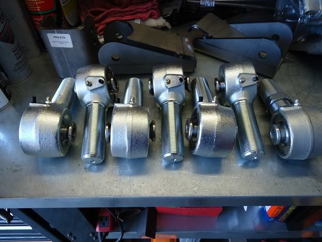

    Going from leaf sprung rear to 18" coilovers and three link in the rear. Plus a front brake upgrade along with a new front bumper winch ( finally ) and a couple of new lights.
    OH!!! Not to mention we're putting in a complete new axle to boot.:D

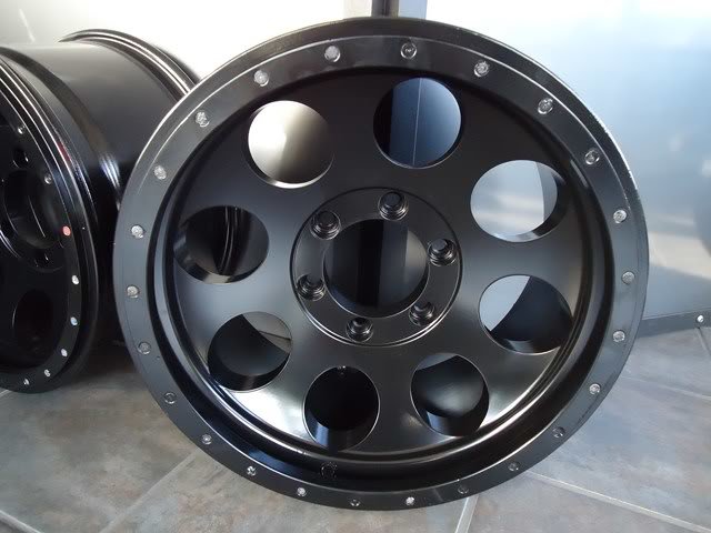

    Oh yeah.... New powder coated beadlocks too.

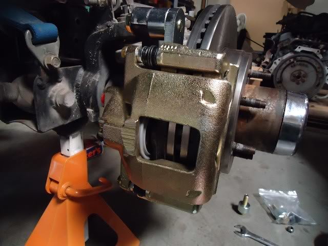

    Huge front brakes now!!!

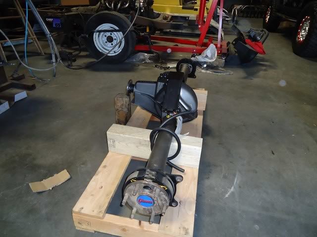

    New rear axle.... A Currie Rock Jock 60.

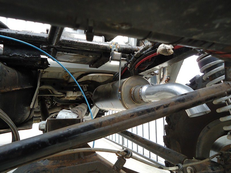

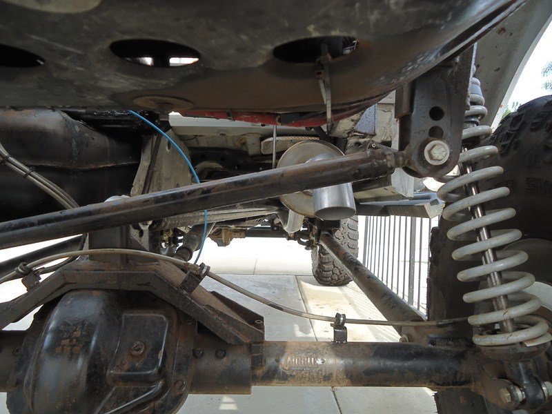

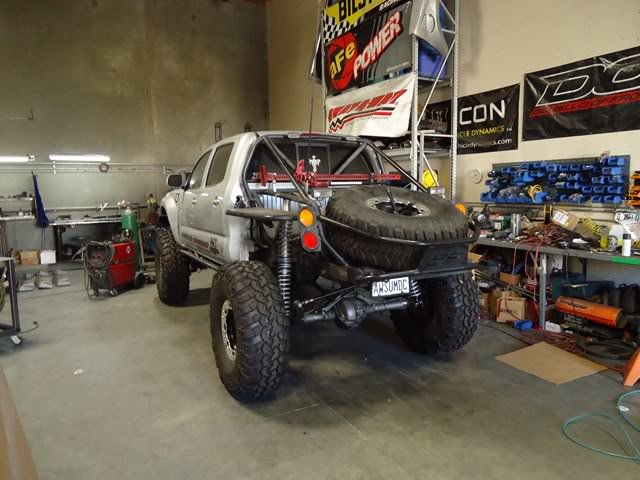

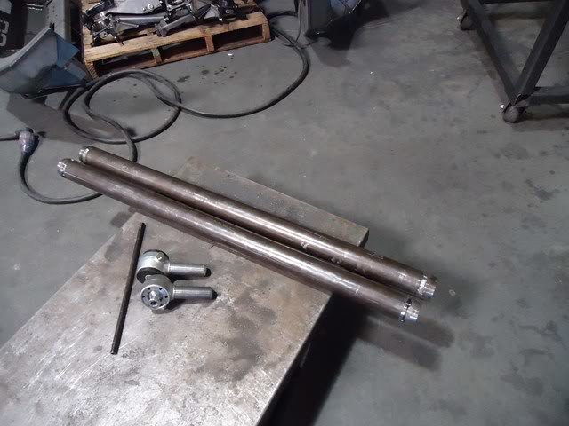

    O.C. Cali
    SASED '05 Taco
    SAS, crawler box, 14" coilover shocks, 39.5 tires,dual batteries, and a bunch of other stuff

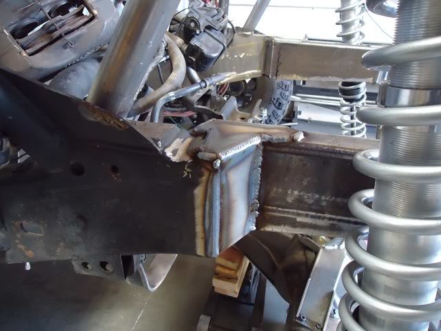

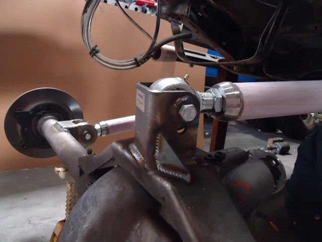

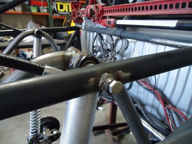

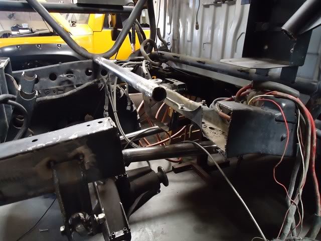

    Setting everything up using pvc pipe instead of wasting money on steel.
    Lifted the cab off of the frame to weld everything perfectly.

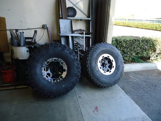

    Went to 41" Iroks over my 40" MTR's

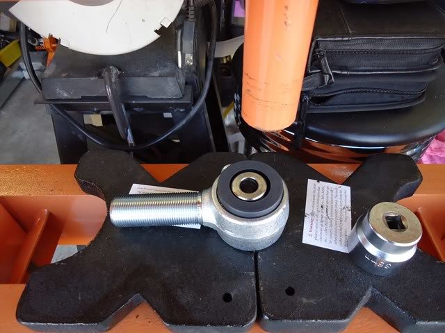

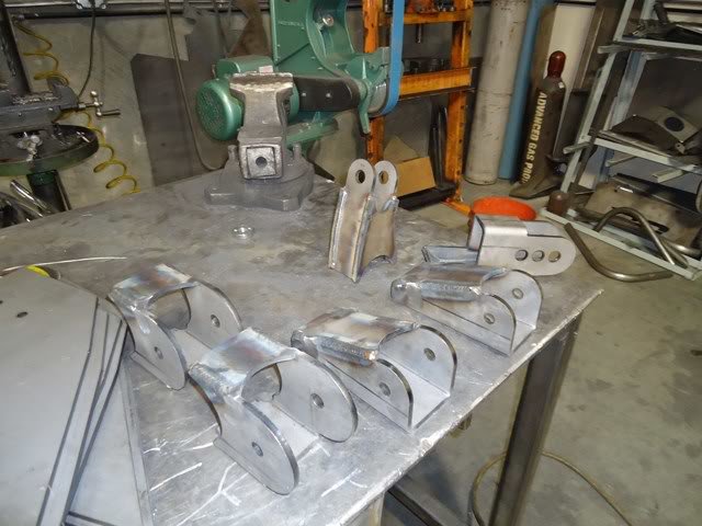

    2 1/2" links that are 1/4" thick and sleeved.

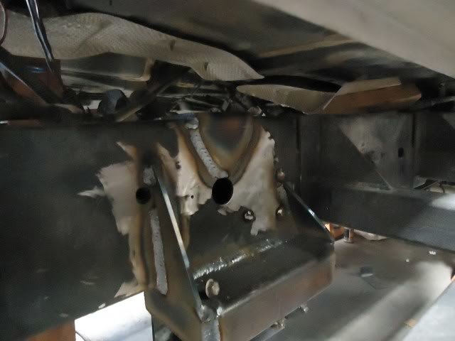

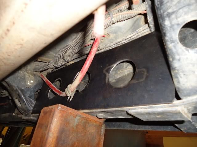

    Had to notch the frame to clear the coil overs.

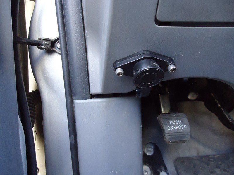

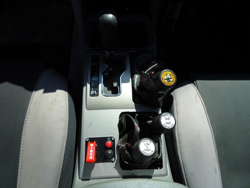

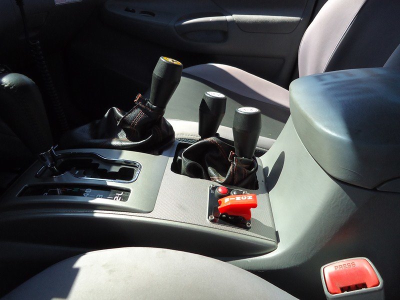

    In cab winch controls.
    Even moved the plug for the winch to the inside of the cab.
    And then of course I had to redo the exhaust system for the three link setup.
    All right. There ya go. All caught up now
