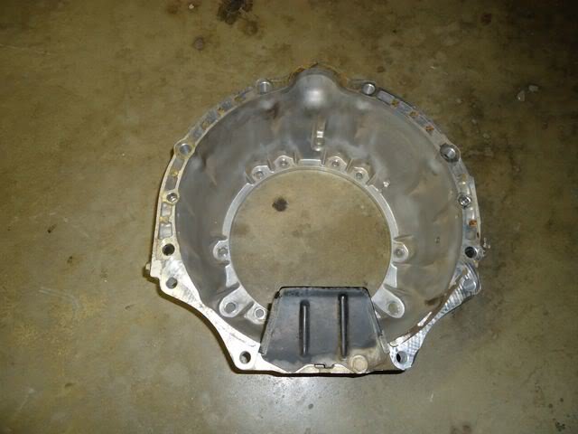

    Ill pay. The motors bolt up to our trannys correct?

    Yes, but you'll need this bell housing from a V8 4Runner, Tundra, or Sequoia. You'll need the Torque converter as well.

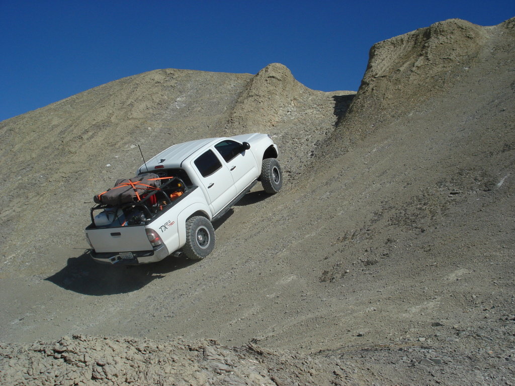

    You mentioned your tranny doing well when vertical. Are you still on the stock tranny? I ask because I have issues with tranny temp entirely too often. When I get vertical for any period of time I typically get the oil light and tranny temp lights at the same time and it shuts down. I thought about a dry sump for the engine or perhaps a more rearward pickup of sorts but that wont solve the tranny issue.

    :eek:How vertical are we talking here?! I've never had that issue and I've had it pretty vertical on some hill climbs and in the rocks. When you say any period of time does that mean that as soon as you get vertical the lights come on or does it have to be vertical for a little bit?

    It takes a little bit, here is an old pic going up a slot in Ocotillio Wells. This is no biggie but the lane off to the left is steeper, with front and rear locked I have the traction but always stall out near the top

    Hard to say because pictures never do anything justice, but I think I've been at least that steep or steeper with no problems. I did a hill climb that I couldn't get enough grip with front and rear locked and half way rolled/slid back down it after I made it about 50-70 feet up it. It was kind of sketchy backing down it. Haha. My wife and I did some hiking after that and we practically skiied down that slope on our feet. But I was on that slope for at least a couple minutes with no problem.
    I've got myself stuck trying climbing some steep sand dunes as well without lights either. The only times I've ever had the motor stall on me is when I am rock crawling in 4Lo and I let the Taco roll back at all. It only take a few inches of roll back and the motor stalls. Freaked me out the 1st couple times until I realized what it was. I've only had that happen a handful of times now though.

    Sounds like you may be low on fluid. A buddy's truck was acting that way and it ended up he just changed the fluid, but didn't check it at the proper temp using the overflow tube method so it was still low.

    Check your fluid levels because I never have any issues like that at all. Oh Yes I am automatic.
