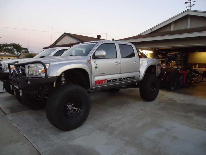

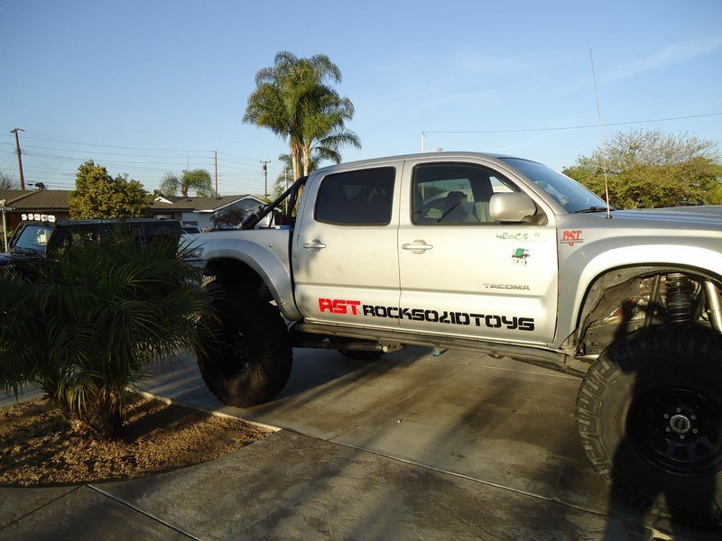

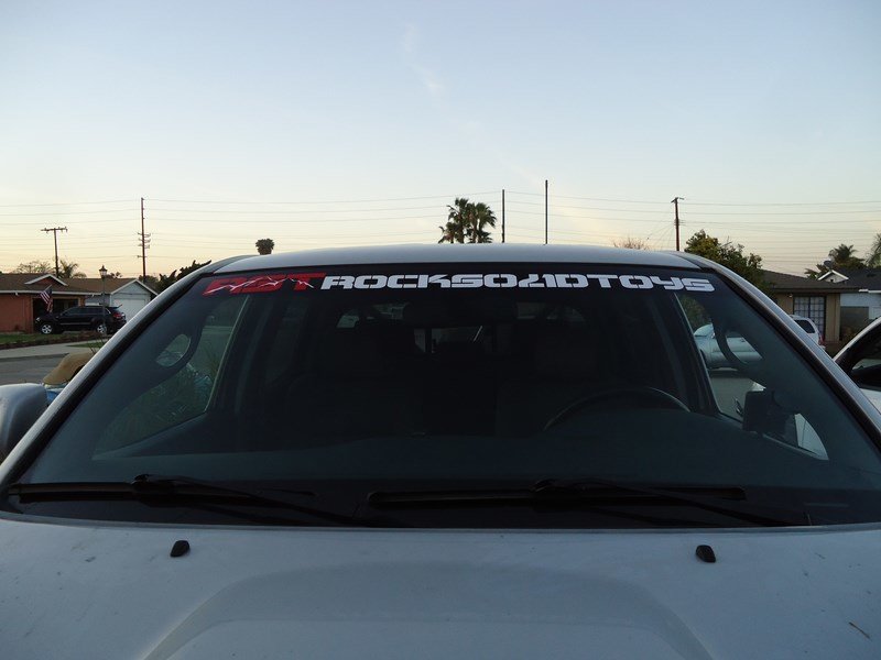

    New look for the Beast.

    Man I need some front glass :(

    Colin
    Charleston, SC
    '07 TRD Sport 4x4
    Build thread in sig... 4-link long travel
    I like the new logo.

    Liking the new sticker wyatt.

    Thank you, I think they came out nice. My friend Cary is just awesome when it comes to this stuff.

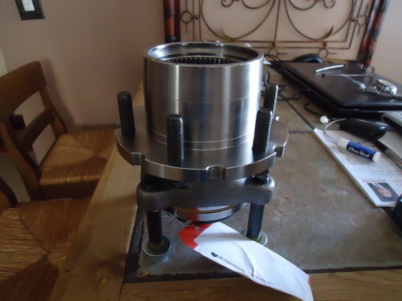

    So... After nine years of wheeling and some daily driving of the Beast with some long trips thrown in there from time to time, I've finally had to replace one of the unit bearings on the front axle. It's a custom unit from Currie enterprise and it's a simple process to install it.
    Checked the other side but it was perfect so I just ordered another one for that side just in case but left the old one in there.

    Wow that is beef Wyatt!

    Yeah, they are custom built F350 unit bearings from Currie Enterprises set up with the Toyota 6 on 51/2 bolt pattern.

    Dang pretty crazy i wish the Toyota bearings would last that long.

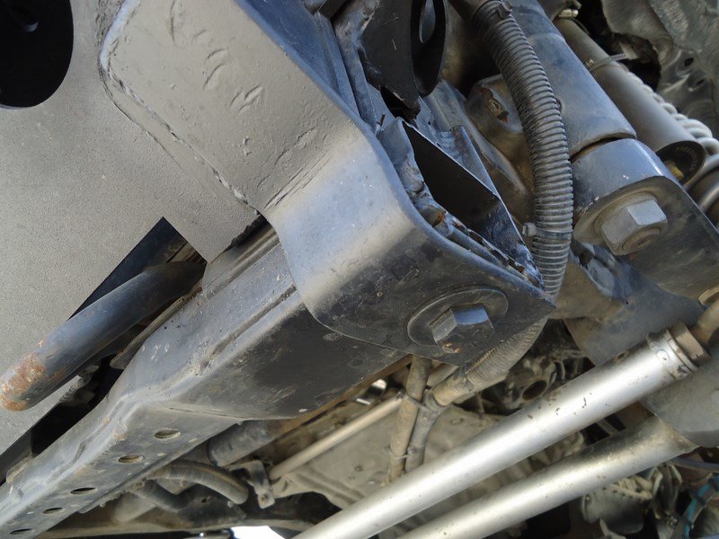

  14. Apr 2, 2014 at 1:58 PM
    #1114
    awsumdc
    awsumdc [OP] Well-Known Member
    Jan 3, 2009
    #12156
    1,674
    O.C. Cali
    SASED '05 Taco
    SAS, crawler box, 14" coilover shocks, 39.5 tires,dual batteries, and a bunch of other stuff

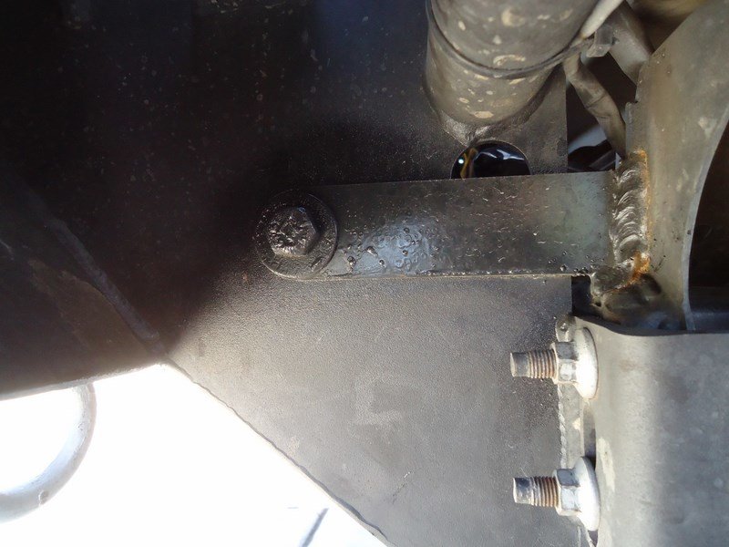

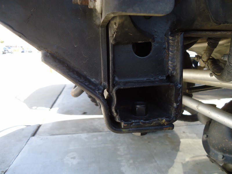

    Before we went to AZ Rocks, I needed to do some upgrades to the front Bumper. DeMello makes a great product but with this one it only had the Stock mounting points and that wasn't nearly good enough for a heavy truck like this while using the winch.
    I came up with a couple of things that made it a ton stronger.
    One was to make another mounting point below the bumper which removed any pivot point the bumper may have had which is what cracks the frames.
    We first welded on an "L" to the rear of the front portion of the frame and drilled a 3/4" hole in it from the bottom. We then took the same material and made a strap that was welded to the bumper and brought down below just like the first strap and drilled a hole in it. That supports the mounting point now on three sides. ran a 3/4" bolt through the hole and tightened it up.
    Then we welded on a 1/4" thick tap to the frame above the stock mounting points and inline with the center line of the winch and drilled a 3/4" hole in it and the bumper. This helps with any downward pull the bumper may have while using the winch.

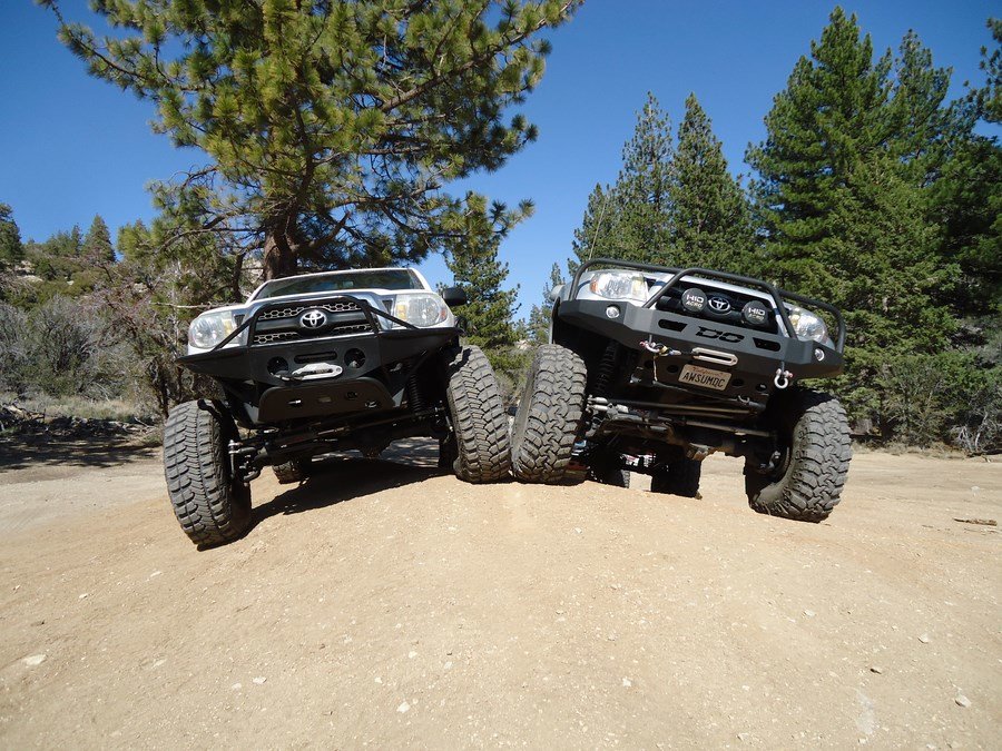

    Beast Mode Times Two.

    ^^ That's some truck pr0n right there!

    very cool picture how quick did you do the trail?

    We took forever becuase there was a jeep that decided he no longer needed any t case fluid. Held us up for at least an hour. Then there was all the picture taking... ;) We were wondering if you were going to come.

    Would held you guys up. Been laying low this month.

    We actually had a first gen with us on 33's. You would have done fine.
