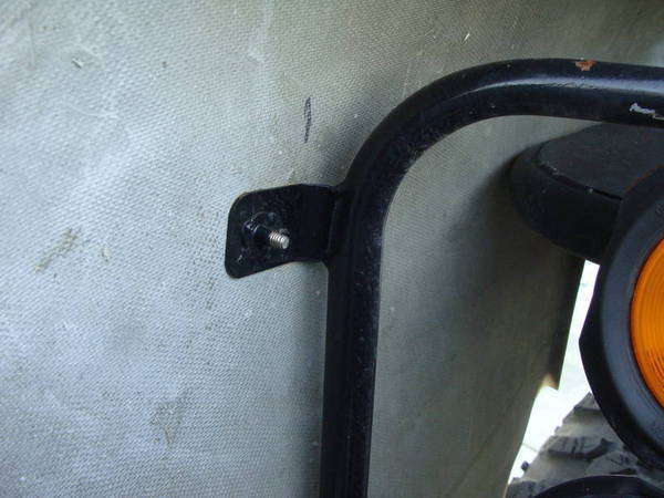

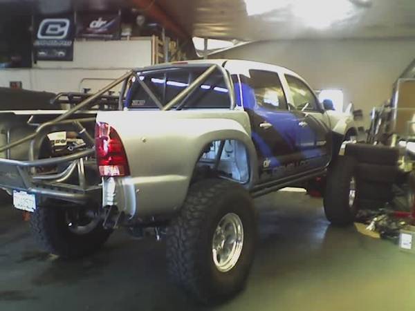

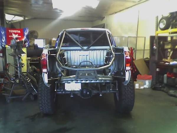

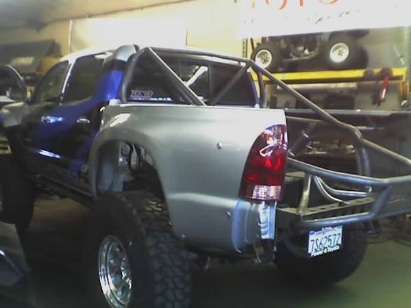

    Ok. After we got the tube bed finished, it was time to do the rear fenders. We wanted to be able to take the rear fenders off for tough trails so we built frames that could be removed with just 4 bolts. Then we attatched the fiberglass to the frames.

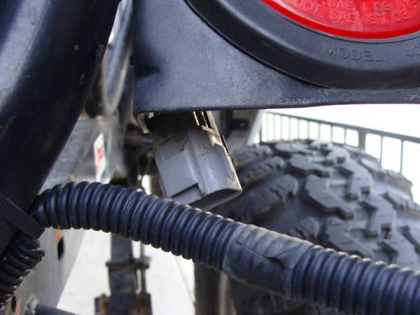

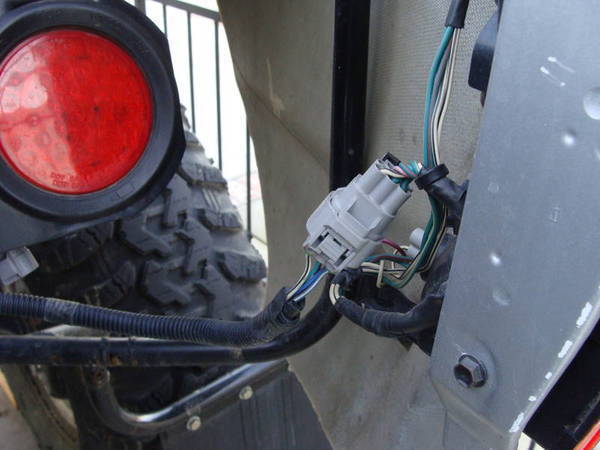

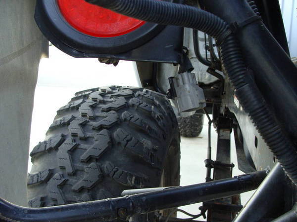

    To make all this work, we had to have extra lights that would work when the fenders were off. So I got some truck lights, an '05 Tacoma mini wirig harness for the rear lights and fabbed them together so that when the fenders come off, I unplug the stock rear lights and plug in the the truck lights and I'm all legal
    In this picture you can see both the stck rear lightsand the custom lights added

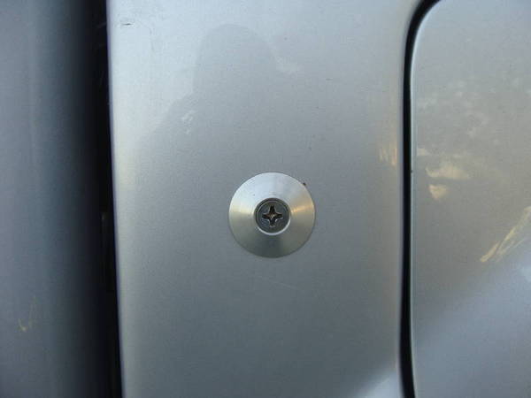

    Here is how the fenders are held onto the frames. It's probably the sturdiest way to hold the fenders on yet still easy enough to take them off the frame if need be.

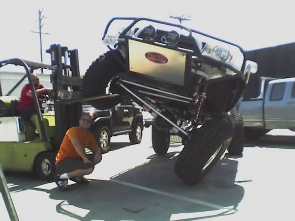

    Here is a picture we took to see just how much flex we had in the front. Thats 46" high from the ground to the bottom of the tire and the rear tires are still on the ground.
    Stay tuned for more.... and there is still alot more....:eek:
