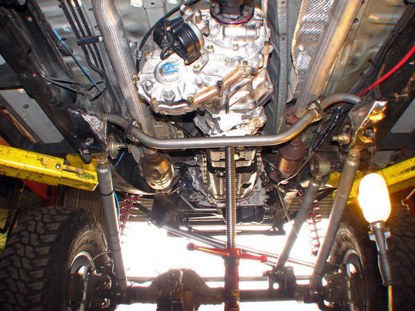

    Coming up next is probably the most effective mod I've made to the truck, and one that even a stock truck can make that will drastically change the way your truck performs offroad.
    When I first got my truck, I went to Marlin of Marlin Crawler and told him what we were doing with the truck and he was interested. I told him I wanted him to put a crawler box in my truck and that he could use it for the prototype. That he did and what came from that was the best mod that can be made to these trucks.
    Yes, wheels, tires, sliders, solid axles, bumpers, and susspensions are all important, but gearing is king when your out there crawling around.
    Stay tuned for how Marlin and his crew made 111 to 1 crawl ratio possible in this truck!

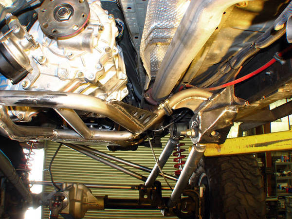

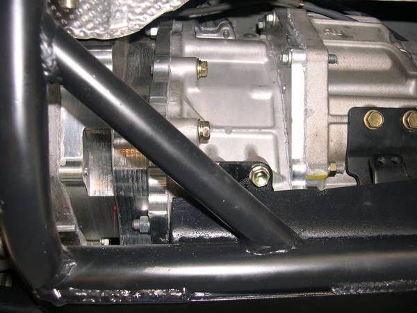

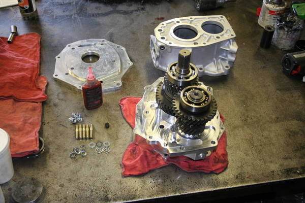

    This is Marlin's Shop in Fresn, Ca. and the little red truck is Marlins own Crawler. It has triple case's and has a crawl ratio of....... 1372to 1!!!!!
    You can actually get out and walk faster than it crawls.
    This is my truck on the rack where it stayed for awhile waiting to get it's new toy.
    This is the stock transfer case.
    Pulling the stock case out of the trcuk.
    Here is the stock case with the drive shaft.

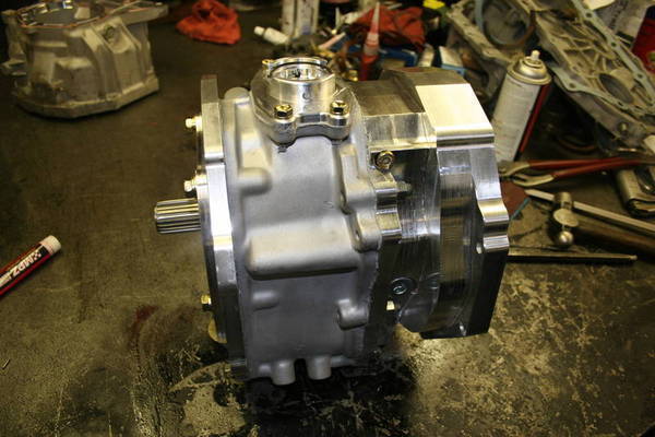

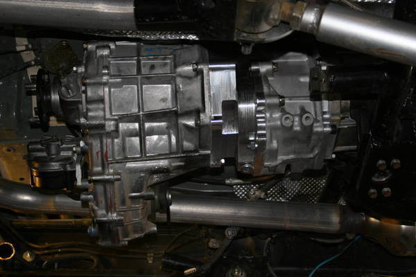

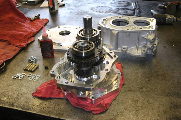

    This is the inside of the crawler box. It has a set of 1to1 gears and another set of 2.28to 1 gears.
    Here is the completed "Taco Box" before it is attatched to my transfer case. It has Marlin adapter plates on the front and rear of the reduction box to mate it to my transmission and my transfer case.

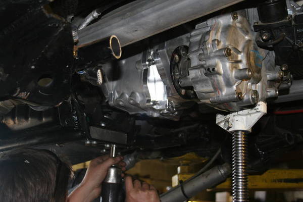

    Here is the Crawler box and transfer case together which would be considered a double transfer case.

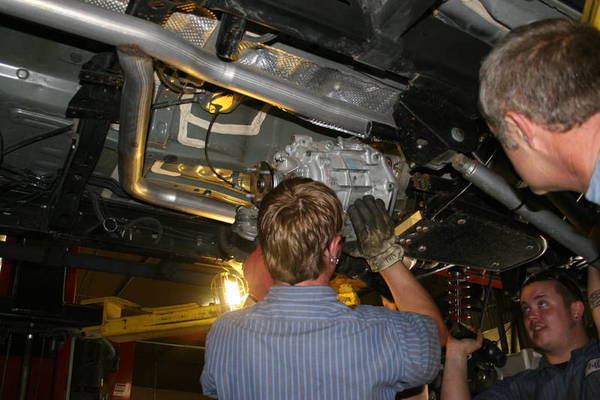

    Putting the dual case in the truck.

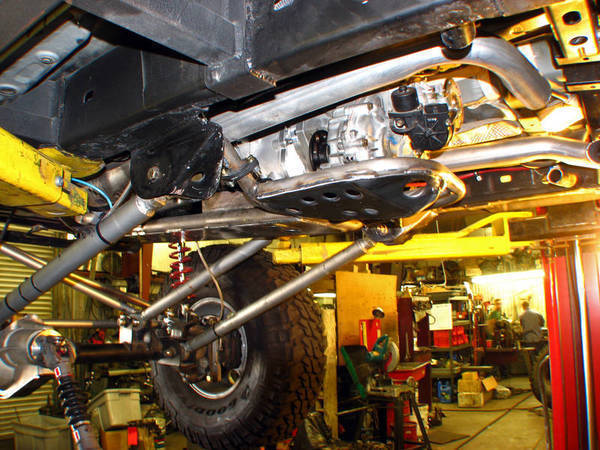

    The dual case bolted to the transmission.

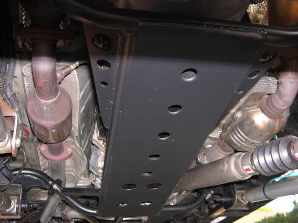

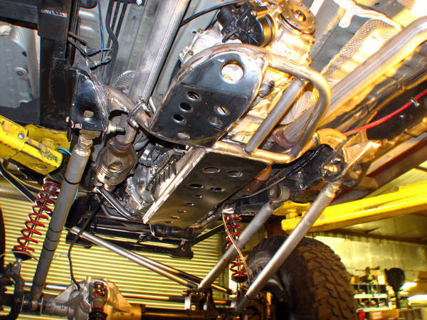

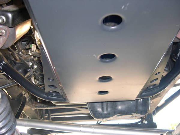

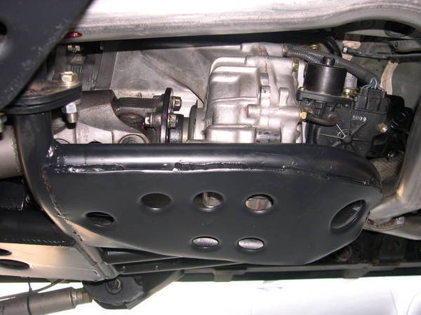

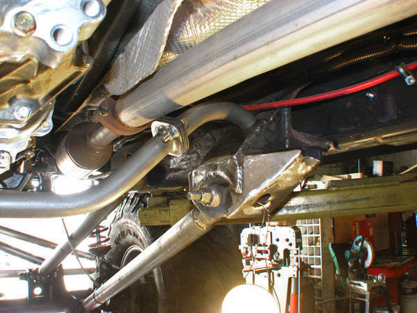

    Then Rocky built an entirely new crossmember/skid plate for the whole thing.
    Nearly finished, it covers both transfer case's and the transmission.
    Here it is all painted.
    This is where the shift lever comes up through the floor. Looks like it came from the factory that way. It still has the electronic switch on the dash for the 4hi and 4lo and then I shift the crawler lever forward for ultimate low.

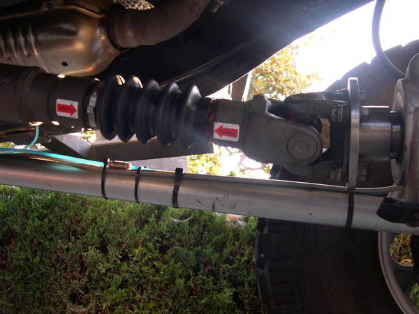

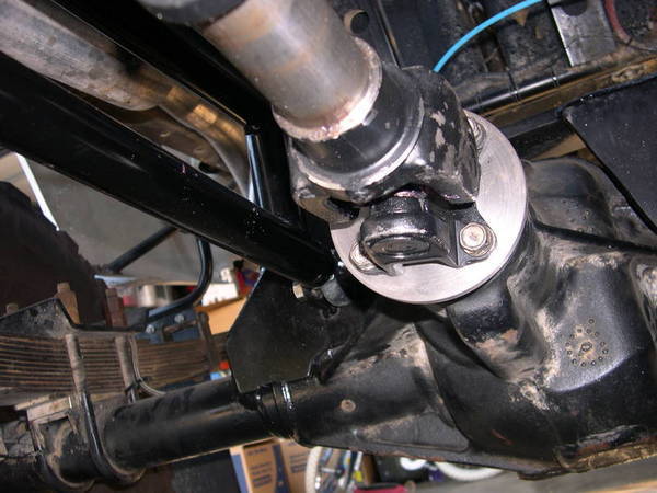

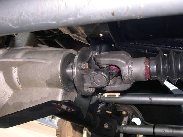

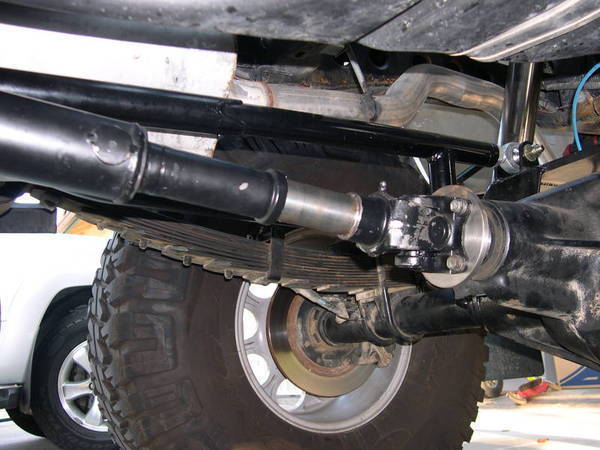

    Because the crawler box lengthens the drive train, we had to lengthen the front drive shaft and shorten the rear shaft. This gave us the opportunity to go with a one piece shaft in the rear. Love it.
    Dana 60's come with yokes instead of flanges like the Toyota's have but they are not as strong as the Toyota units so High angle drive line fixed that. They made special flanges that will bolt up to a Dana 60 and then a stronger toyota drive shaft can be used.
    They made the flanges and driveshafts for the front too.
    So there you have it. If I were to do just one mod to my ruck, it would be this one. It is amazing what you can do with these in your rig. Ever go down one of those steep hills and just slide down? With a crawler box, you just put it in ultra low, take your foot off the brake and slowly crawl down with all the control in the world. And the place you can go have just increased ten fold.
    Here is a link to Marlins site.
    http://www.marlincrawler.com/
    Stay tuned for even more on this truck. We're not done yet.

    Thats the neat thing about adding a crawler box. In one to one mode it's like it's not even there. You drive down the highway at 70, 80, 90 if you want. But when you want to go slow.... there is nothing better.
    I'll put a link to Marlin's site so you can figure out what would be best for you, but the box is about 1700 and to change the drive shafts is about 200 each and you'll need to modify your crossmember. But it is well worth it. If someone lives near me and wants to see how one of theseworks, I'll be more than willing to allow you to drive my truck to see how it works.
